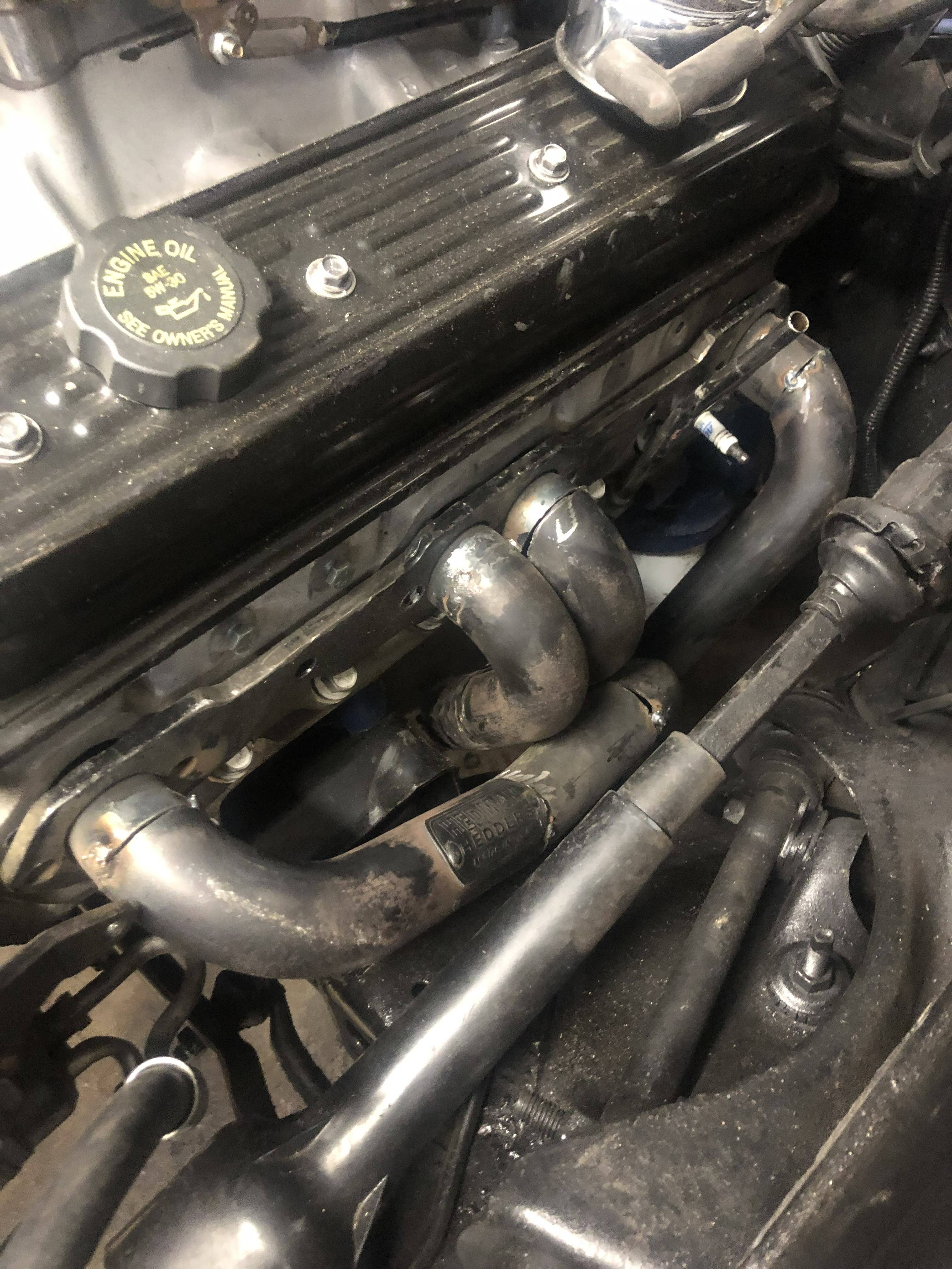

Tried to fit in both sets of headers I had on hand but sadly neither of them fit. The shorties were not even close, but the long tubes most likely would've fit if I did a little bit of modification on them but decided to go buy new ones that would bolt on to save a little time and effort (foreshadowing: It did not). Got the modified crossmember bolted back up.
Went on Hedman Headers website since I've heard about how they always fit quite easily. Input all the car information like having a 5.7, column shift, automatic, power steering, AC, angled spark plugs, etc. Had a selection of 6 different but only really had an option of 3 because I can only afford a set of steel ones instead of stainless. Decided on "Hedman Hedders 68620". They arrived and the passenger side fit perfectly, plenty of clearance on the HVAC box and starter (did add a bit of heat reflection stuff on the starter wires just in View attachment 199360 case). View attachment 199361 The driver side was another story. It was a pain in the you know what to get it down into position. Had to take a hammer to a tube to help clear the steering rag joint. Then once installed I noticed how one of the tubes was maybe a centimeter from the engine mount, so I took it back out and cut that tube off and rewelded it back further. Upon installing again noticed how close it was to the brake lines and proportioning valve and didn't want to risk any boiling brake fluid. Ontop of that the header flange was veryyy close to the transmission dust cover and to make matters worse the shift linkage hit the collector and prevented me from having 1st gear. Decided this would be fine just to do a test startup of the engine before taking the driver header out and completely redoing it.

  • I pulled out the headers and have already cut them apart and completely rewelded them to be kind of like a block hugger. Eventually Ill probably get a nice set of stainless headers but for now it'll have to do. Need to spray the headers with header paint and then I've got header wrap coming tomorrow.
