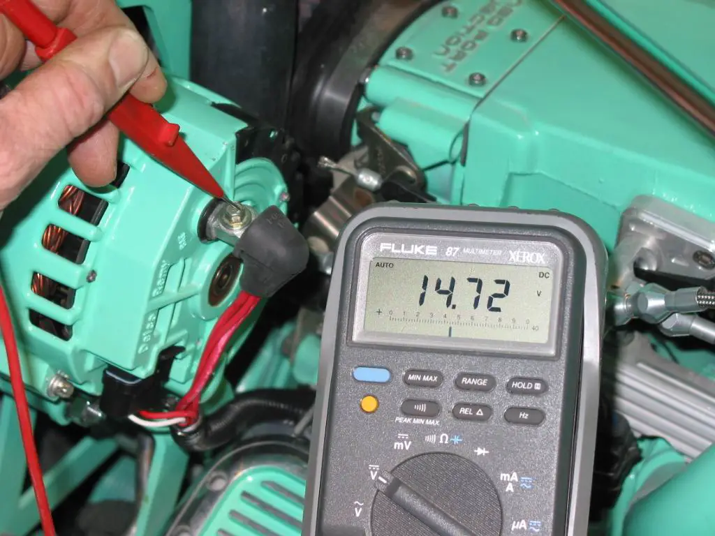

The red wire with the craptastic connection is your charge lead to the battery. I would fix that before changing the alternator; it might be your whole problem.
