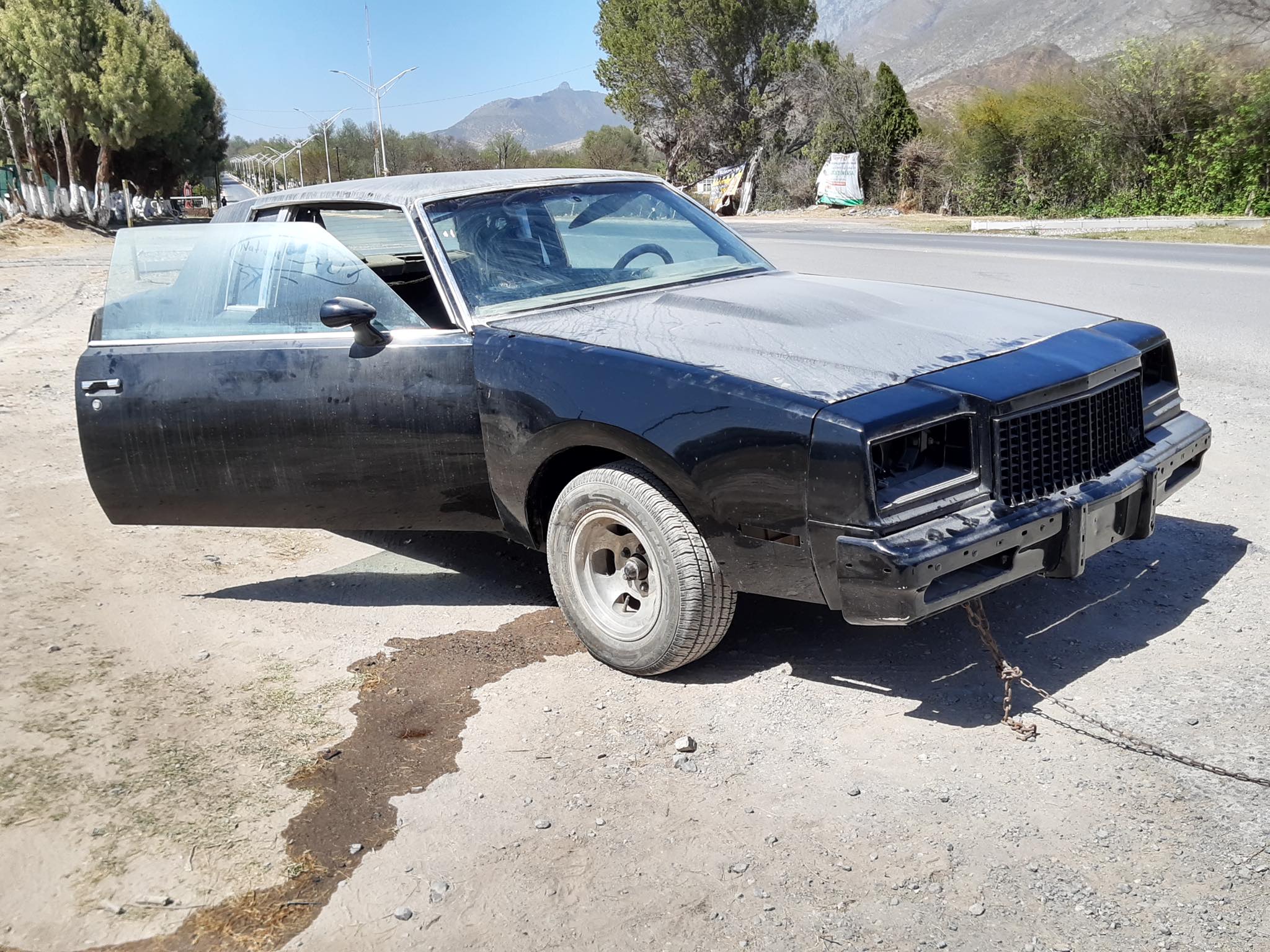

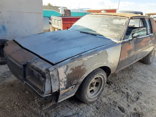

When I bought the car it was in terrible condition and there was no trace of the turbo, I don't even know if the engine is the original.
but I would like to keep the 3.8, and leaving the performance and originality aside, I would only like the car to work and finally enjoy it, hahah I haven't driven it for 2 years.

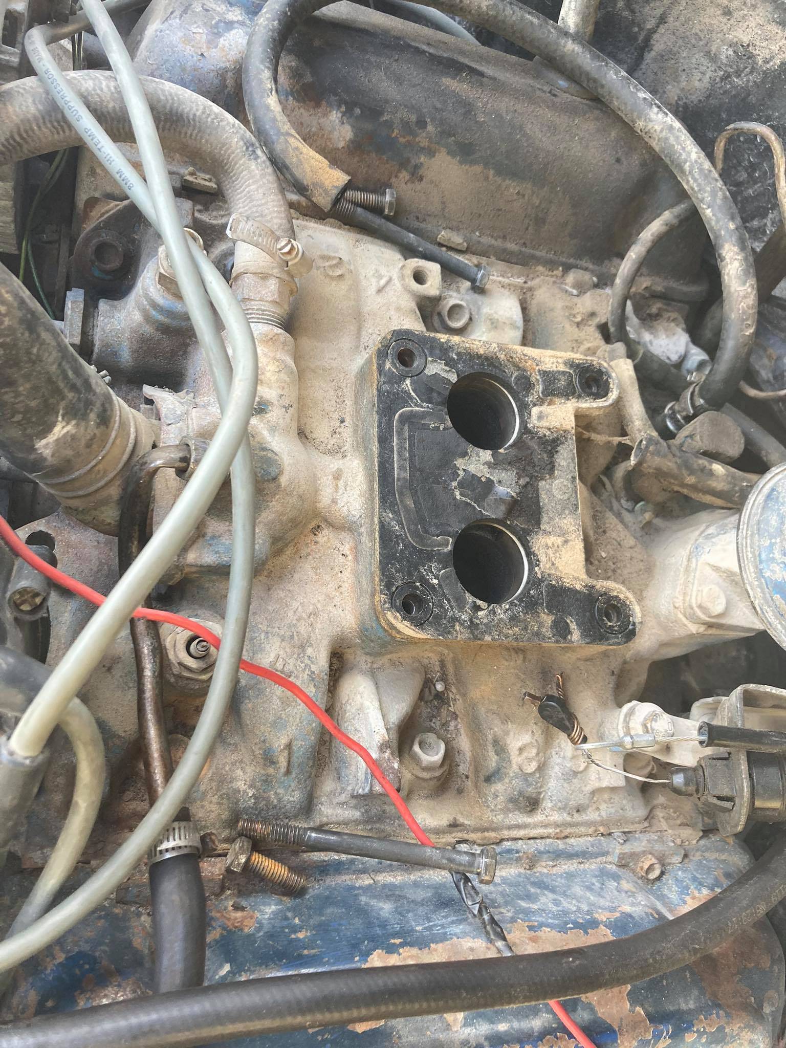

i thought i needed a new intake to fit a carb, but maybe i can use the base i already have and fit a bolt-on carb without any other modifications?
I really appreciate your help, at this moment I don't have photos of the engine and the base, but tomorrow I will upload some, I would greatly appreciate your advice to finally get the car back on the road as cheaply as possible.

Yep, from the factory that was a Regal Sport Coupe with the Qjet turbo. Funky. Does it have a bump on the hood?
You could try to find the engine VIN stamp on the block. If the numbers match, you still have the turbo long block.

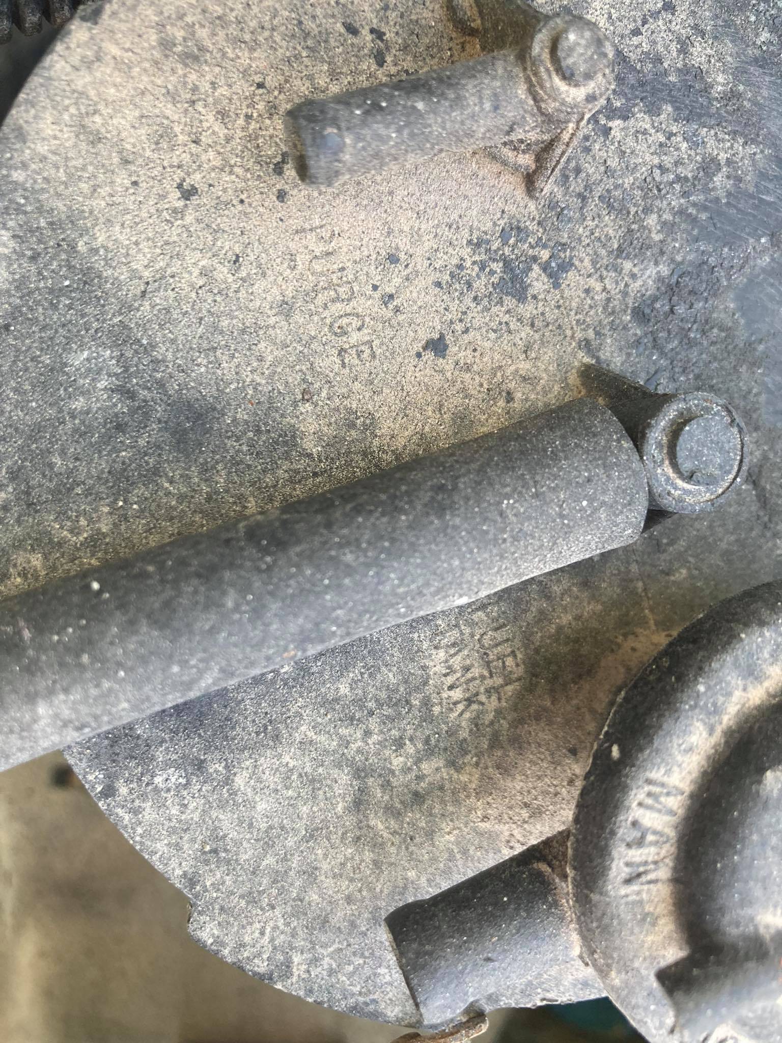

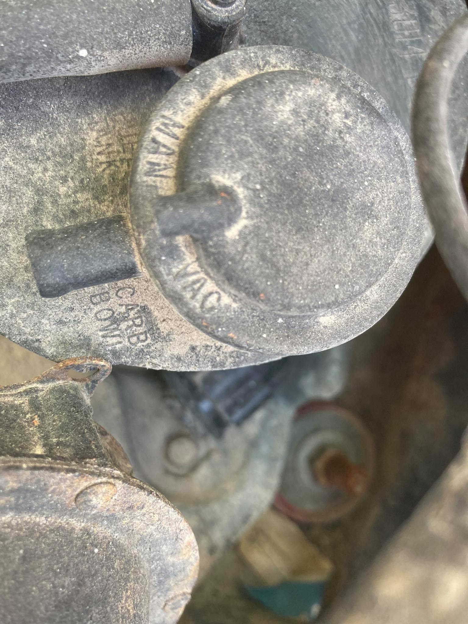

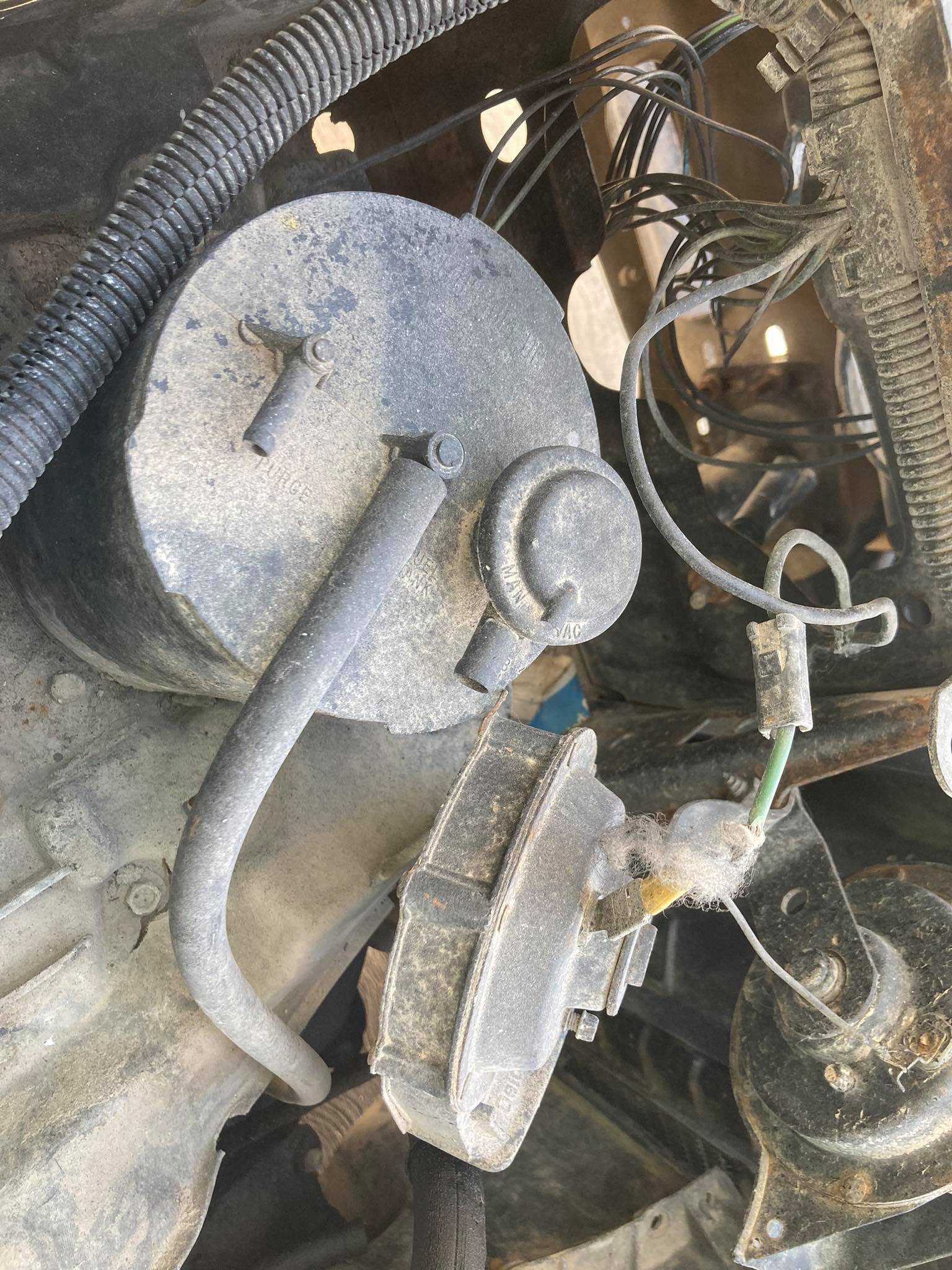

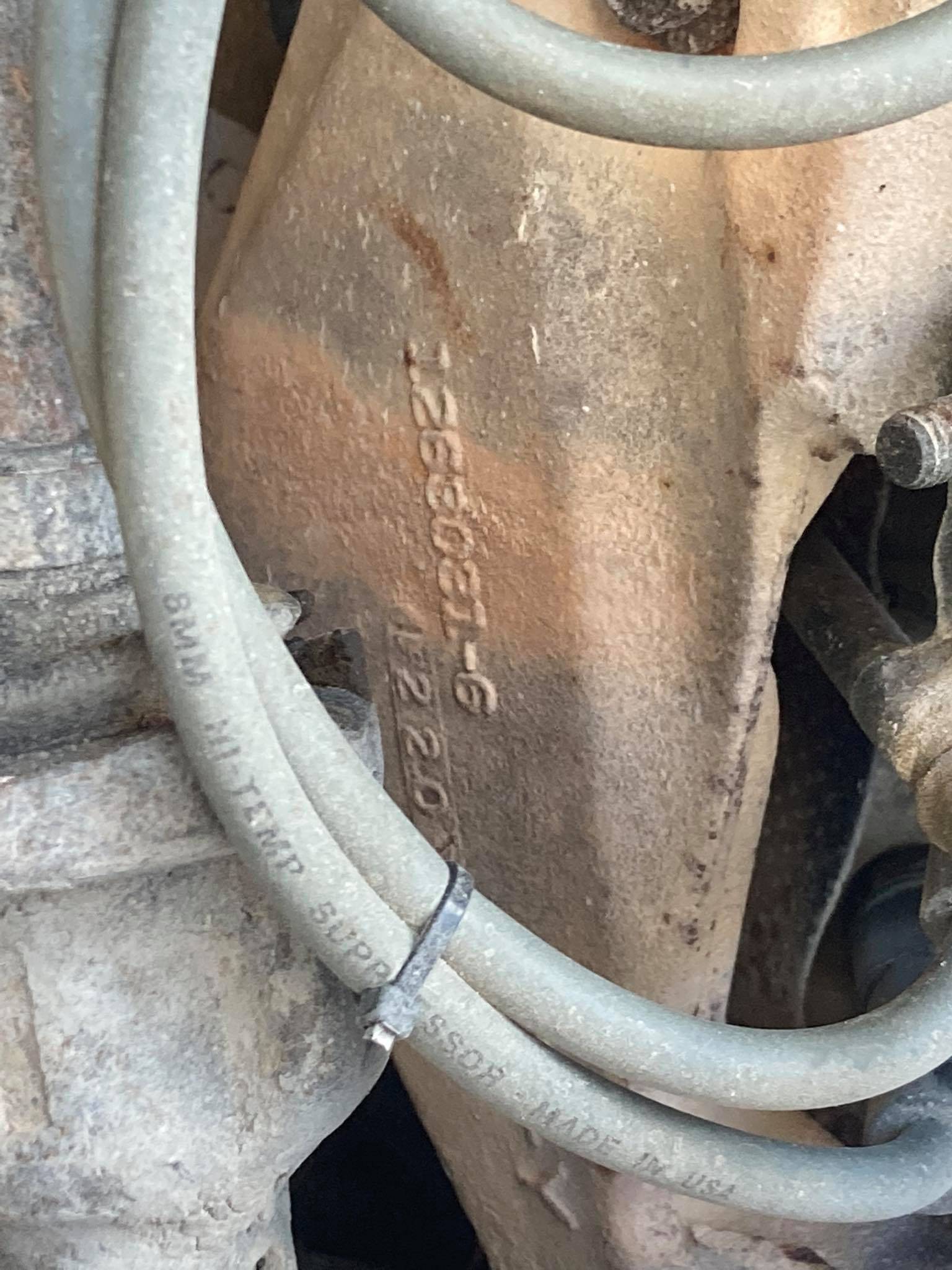

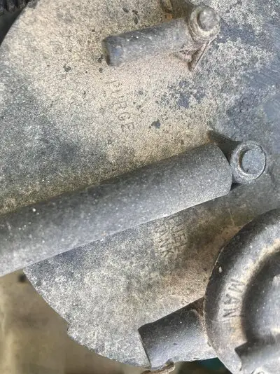

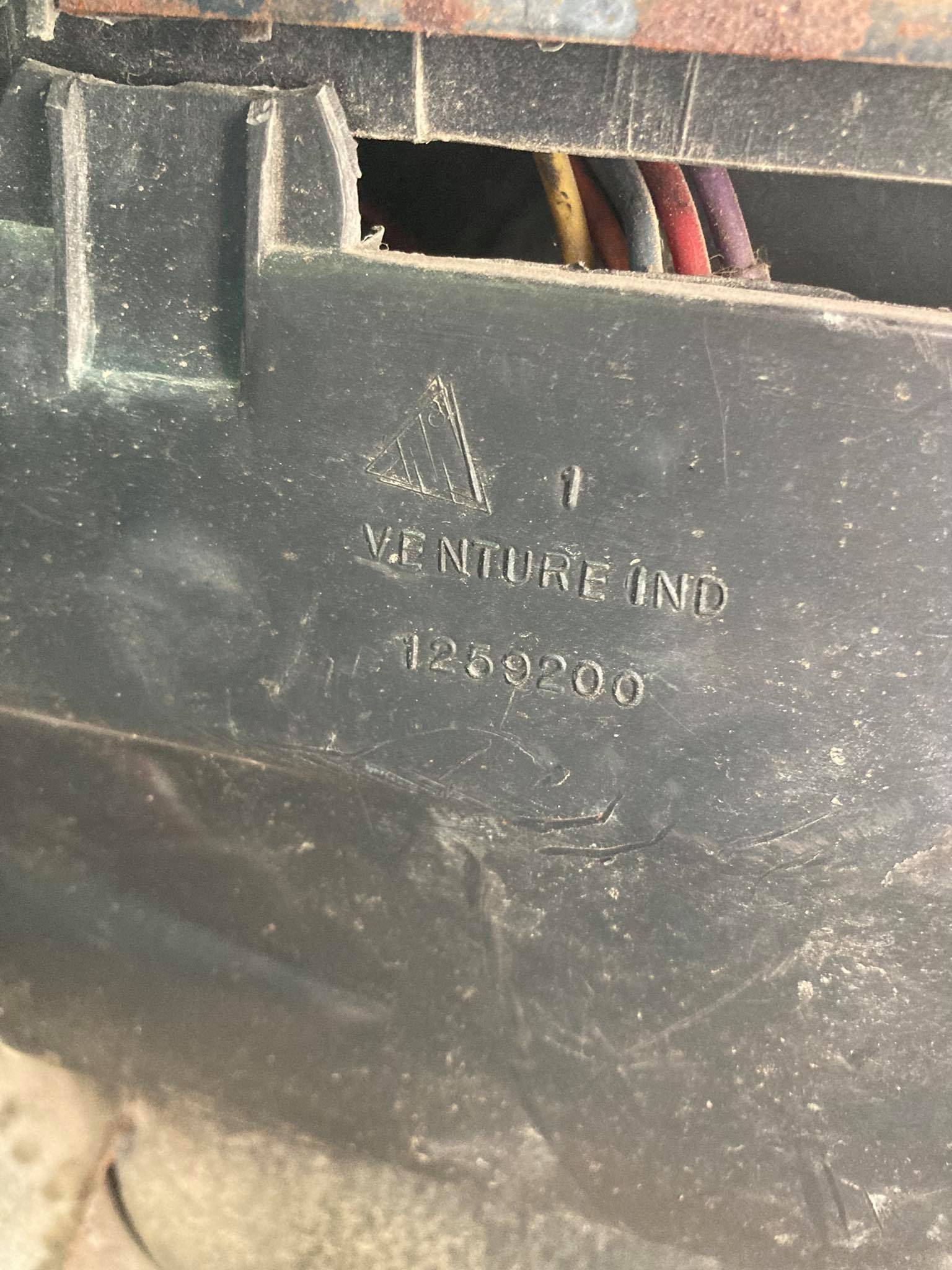

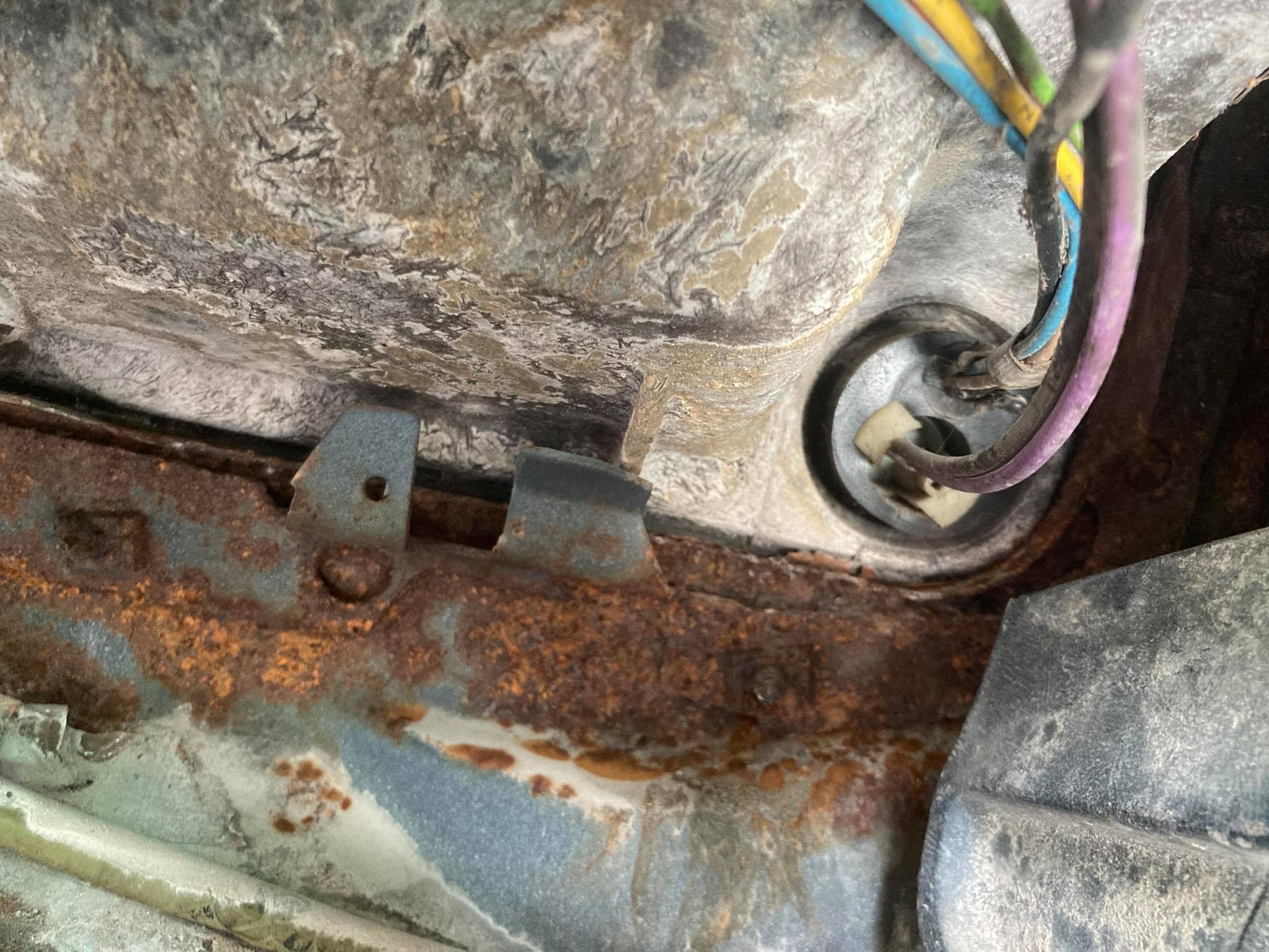

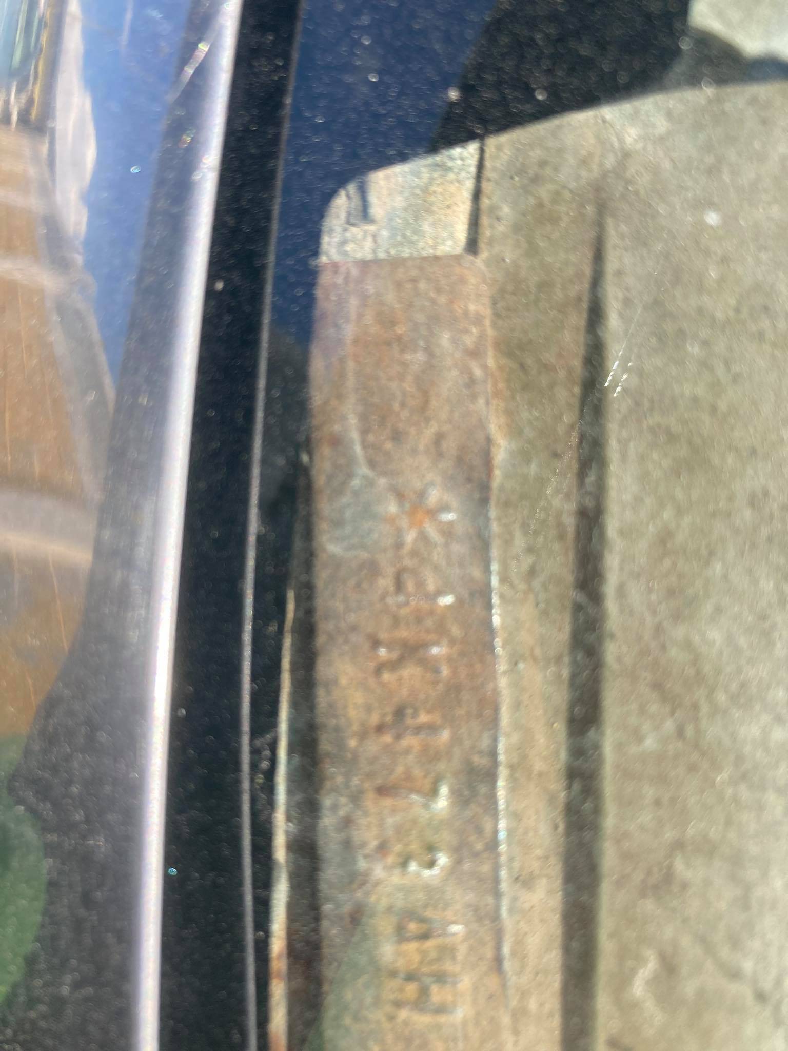

the pics with the numbers are something related to the turbo?

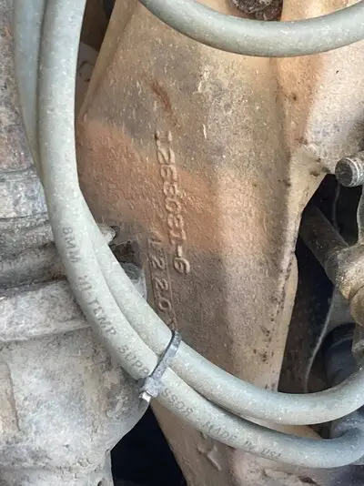

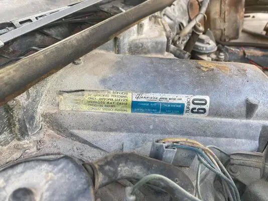

Not to make you nervous, but, I'm weary of the mechanic you're using. The carburetor isn't the solution to known timing problems.
That engine has been out before. Picture two of the intake is clearly not a turbo intake manifold, it is a factory 2bbl version. However, the paint on the engine is an improper color no matter how you slice it - the blue is too dark.
Factory engine color would me more of a Robin's egg blue, or, for a later 80s post 1983 engine it would be black. But never dark blue.
Picture 3 is just an exhaust manifold casting number. It references as a LH side manifold that was typically used on 1979 and 1980 both n/a and turbo 3.8 engines (early production for 1980). So it could be original, and so could the long block for all we know.
Pics 5 and 6 look like climate control and air duct parts.
Pics 8, 9, 10 are your fuel canister, part of emissions and venting the vapors to and from the gas tank. That and other pics show tons of plugged and hacked vacuum lines, and again, going back to mechanic, I don't know why the vacuum lines weren't straightened first, then try to set timing which may have the stripped nylon gears I mentioned earlier.... just don't understand the jump from timing to change carb first...
Your vin and other thing identify it as an original turbo car to me, but, don't help figure out what and where the engine came from.
The intake is early because it lacks provisions for the EFE later 3.8s used. But the question becomes, is the engine original or not...
If you can get casing and stamping numbers off the block itself it may help.

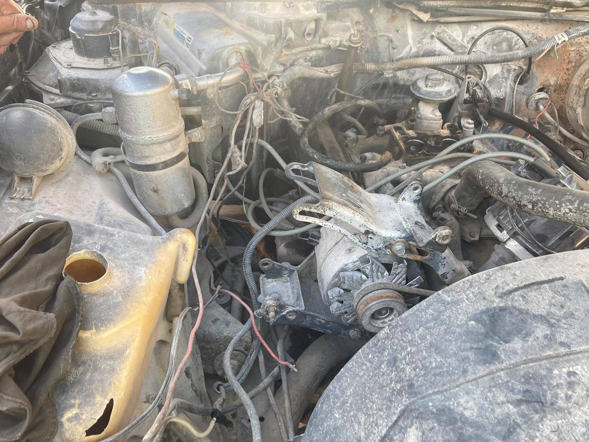

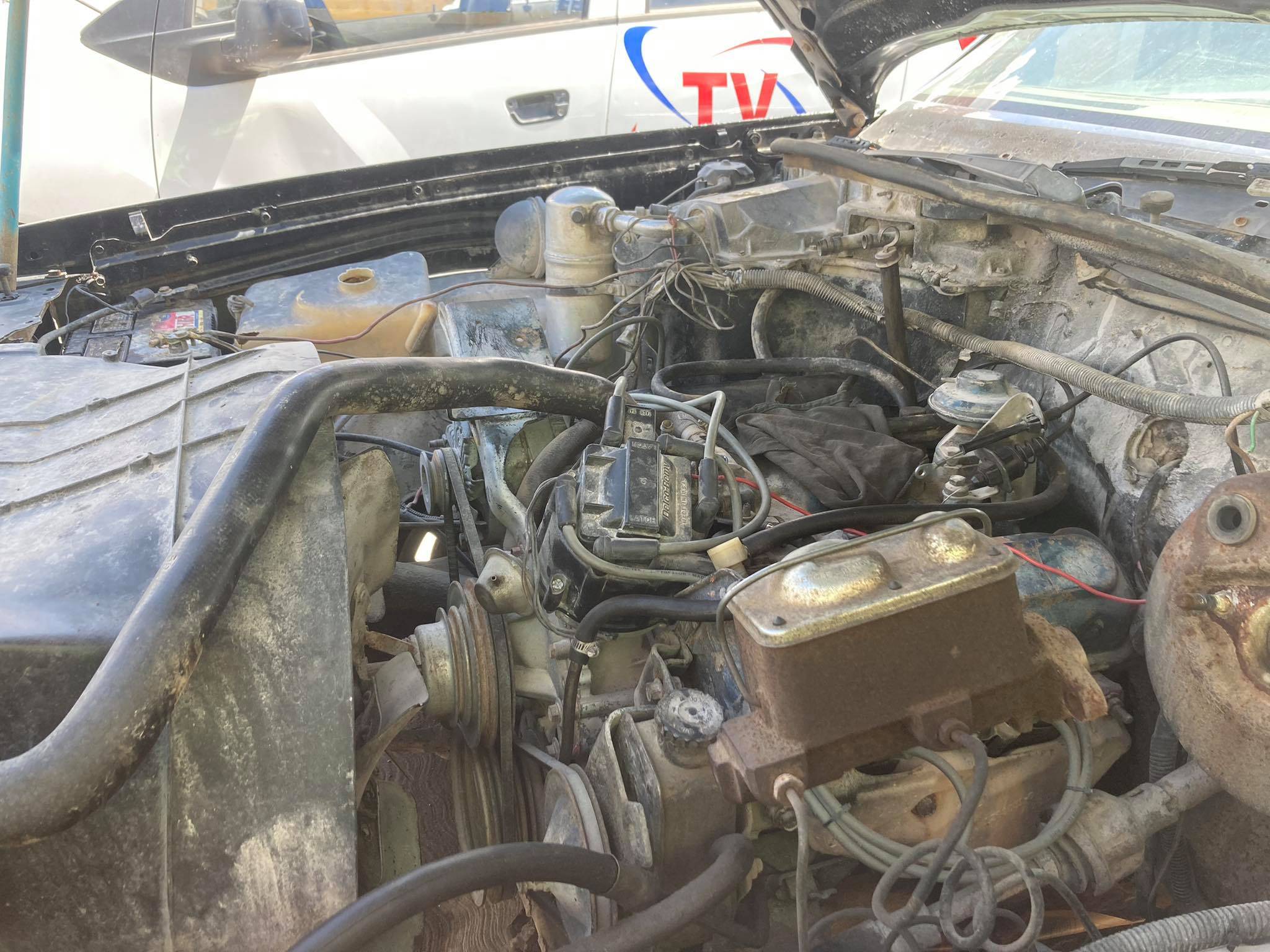

Also, fwiw, I've tried studying those pictures of that figurative rats nest of hoses and wires pulled apart in the engine bay. The alternator bracket appears correct for the carb turbo car which I forgot to include, but, the rest eludes me.
It MAY by that the command control computer went bad and they couldn't source a replacement. Then they ripped off the turbo setup from the rh exhaust, and intake up, then put N/A parts on to make it functional. Or, blew the engine, sourced a short block (explains wrong paint) and reused some front accessory brackets to install.
You are, of course missing piles of emissions stuff like the a.i.r. pump to go along with the turbo setup.
If you wanted my opinion, I'd hold off buying the carb, have the timing set changed to the steel gear and chain, and have them sort out the wiring, vacuum hoses, etc with the old carb on it but setting timing with the new gear set. Then, once everything was sorted, decide if the carb needs changing.
Reason being, one you know the engine is healthy you may choose to buy a turbo intake, carb, rh exhaust manifold/up/down pipe, and change that instead of the dualjet setup... especially if you can confirm the engine is an original longblock.
Reactions: Athos
