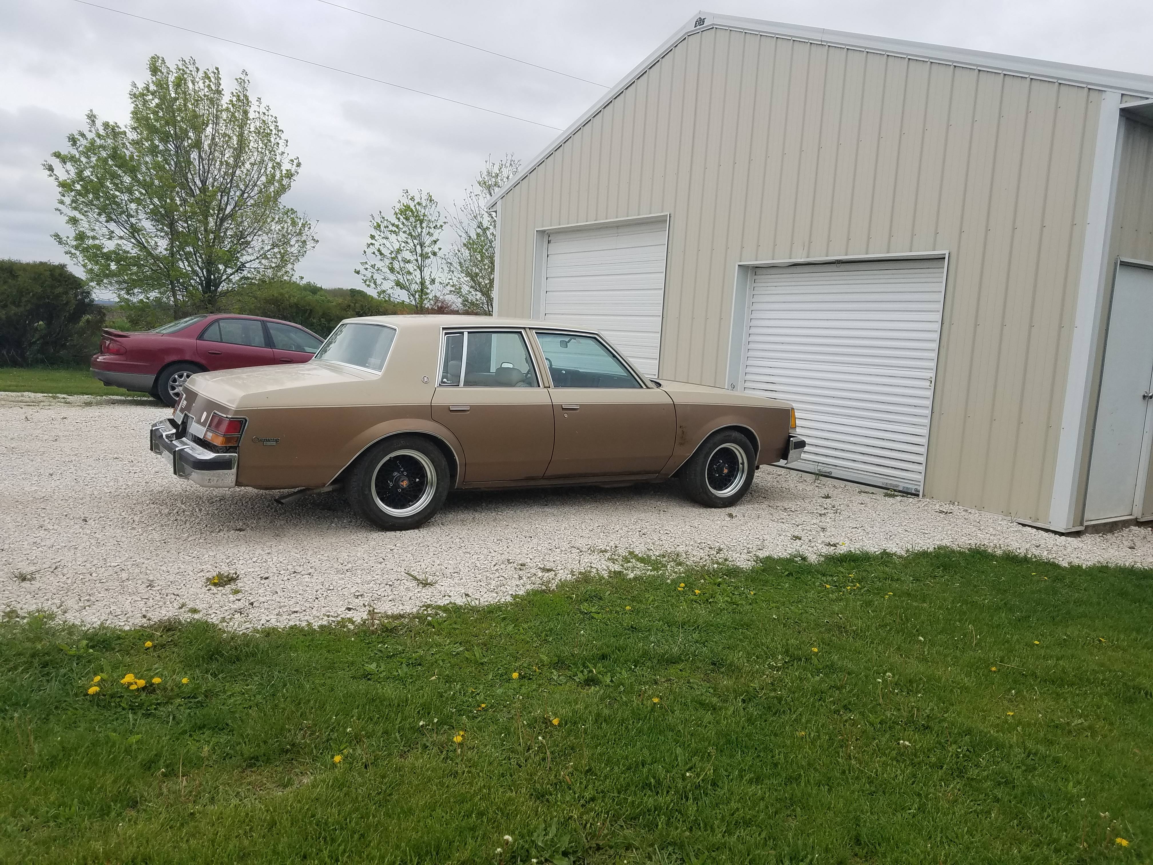

I have a set of front GTA wheels on my Century.
No problem with fitment on that car. I had them on my Monte with drop spindles and I had to grind something because they rubbed a little. I also have a set of aftermarket ones Kirban used to sell.
I have a set of front GTA wheels on my Century. View attachment 185263 No problem with fitment on that car. I had them on my Monte with drop spindles and I had to grind something because they rubbed a little. I also have a set of aftermarket ones Kirban used to sell.
That's great, thanks for the photo. My car is all original, no drop of any kind so I might not have to grind or cut anything. I like the black but with the color of your car, the gold ones might look good too. Thanks
