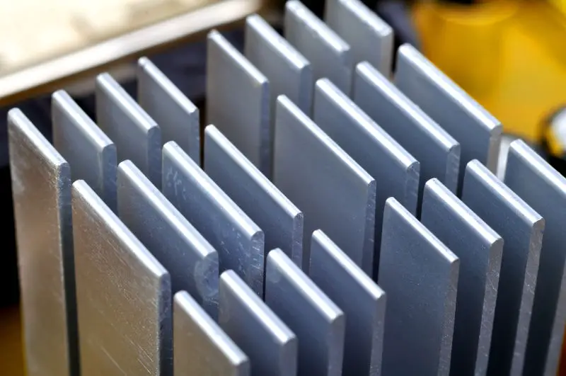

As far as I know the ICM is original to the donor car (94 z28). It had 120k miles on it. When doing the swap I added an extra large copper heat sink and spaced it from the head. I also moved the coil and module assembly from the driver’s side to the passenger side in order to make room for a modified power steering pump bracket.
I’ll definitely be considering the ICM as the possible culprit. I may even have a spare around here. Here’s the stuff mounted on the front of the passenger side head

If it was me, I wouldn't have that copper on the back of it. Copper doesn't dissipate heat as fast as aluminum does so if anything it's cooking it.
Are you sure you don’t have that backwards?
Also, here’s the side of that copper heat sink you don’t see while mounted on the car. Look at all those fins. That’s a lot of surface area to shed heat. I don’t think that copper heat sink is hurting anything.
Yea, could have, been a while.
So let me throw this at you..heat sink with fins is to dissipate heat. If there's no air flow in that little pocket between the head, heat can't move.

Too be fair... the ICM is mounted to an aluminum heatsink with fins, even though its mounted to the front of the engine via the cylinder head that sits directly behind the radiator fan that supplys plenty of airflow, and to the ignition coil as well.
