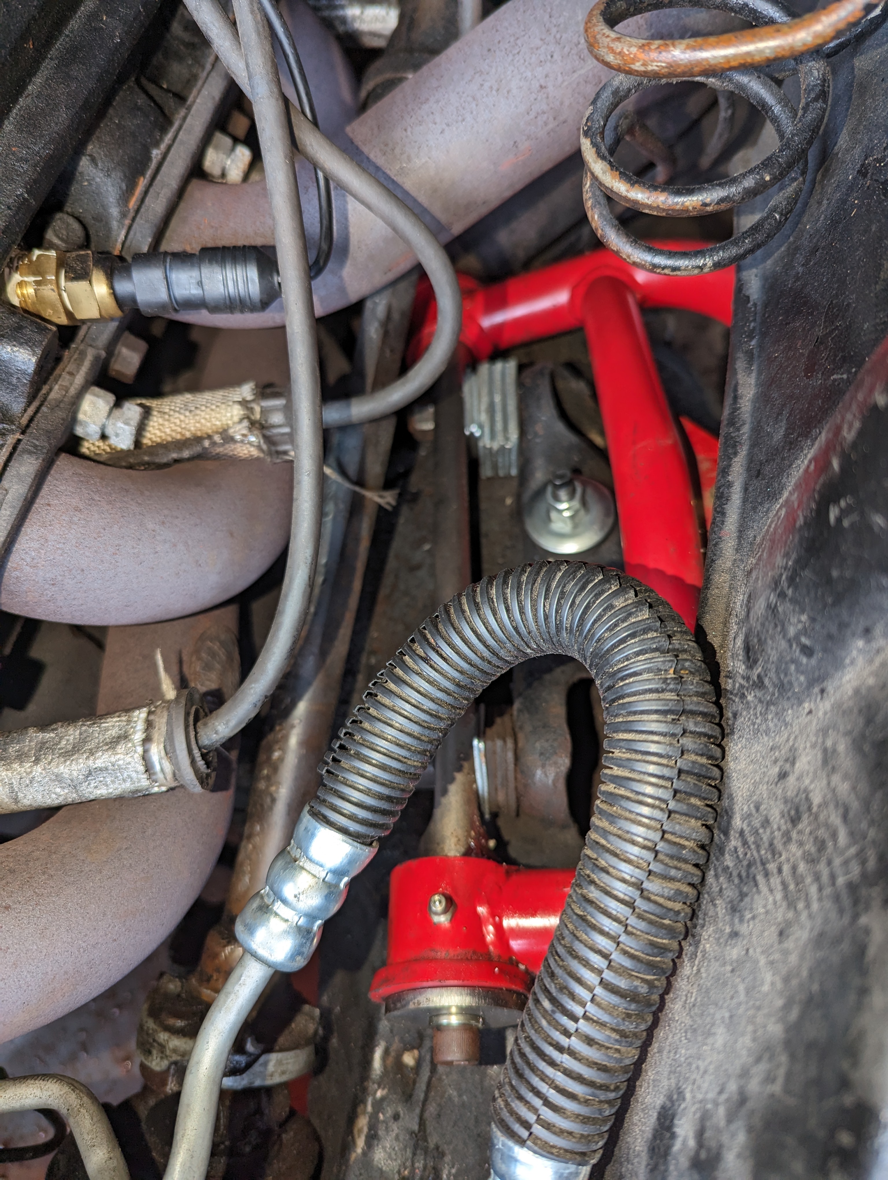

I should have put this in my first post. If your shim stack doesn't look like this, your alignment is deficient.

Since we’re sharing pics of our uca shim stack. Lol. It’s been over 15 yrs ago I had my car on the rack but I think mine is 0 camber, 3 on the drivers side and 3.5 pass. 1/16 in on toe. I have b-body spindles though.

And of course I have the aftermarket arms, but they're supposed to be stock length. I had like 3 degrees positive camber with near zero shims.

A few months ago I installed speedway uca’s on a 86 elcamino and aligned it. Took considerable amount of shims. My olds uca’s I shortened them for header clearance and tall spindles. Just happened the amount shortened them got me almost dead even on the specs I was trying to achieve.

I'm a retired ASE certified master technician that has done alignments for 42 years. The number of shims in each location will be different from car to car. I've see stacks like yours and I've seen them without any shims and the alignments were correct although no shims usually means something is worn or out of specs. No two cars are the same. Ride height, wheel size and offset, and just frames and suspension parts vary from cat to car. I know that everybody wants 5+ degrees of caster, but more times than not, it isn't possible on these old cars. I usually will try to get as much positive caster with 1/4-1/2 degree more on the right to offset the crown of the road, but correct camber readings are more important because camber will wear tires, caster won't.
