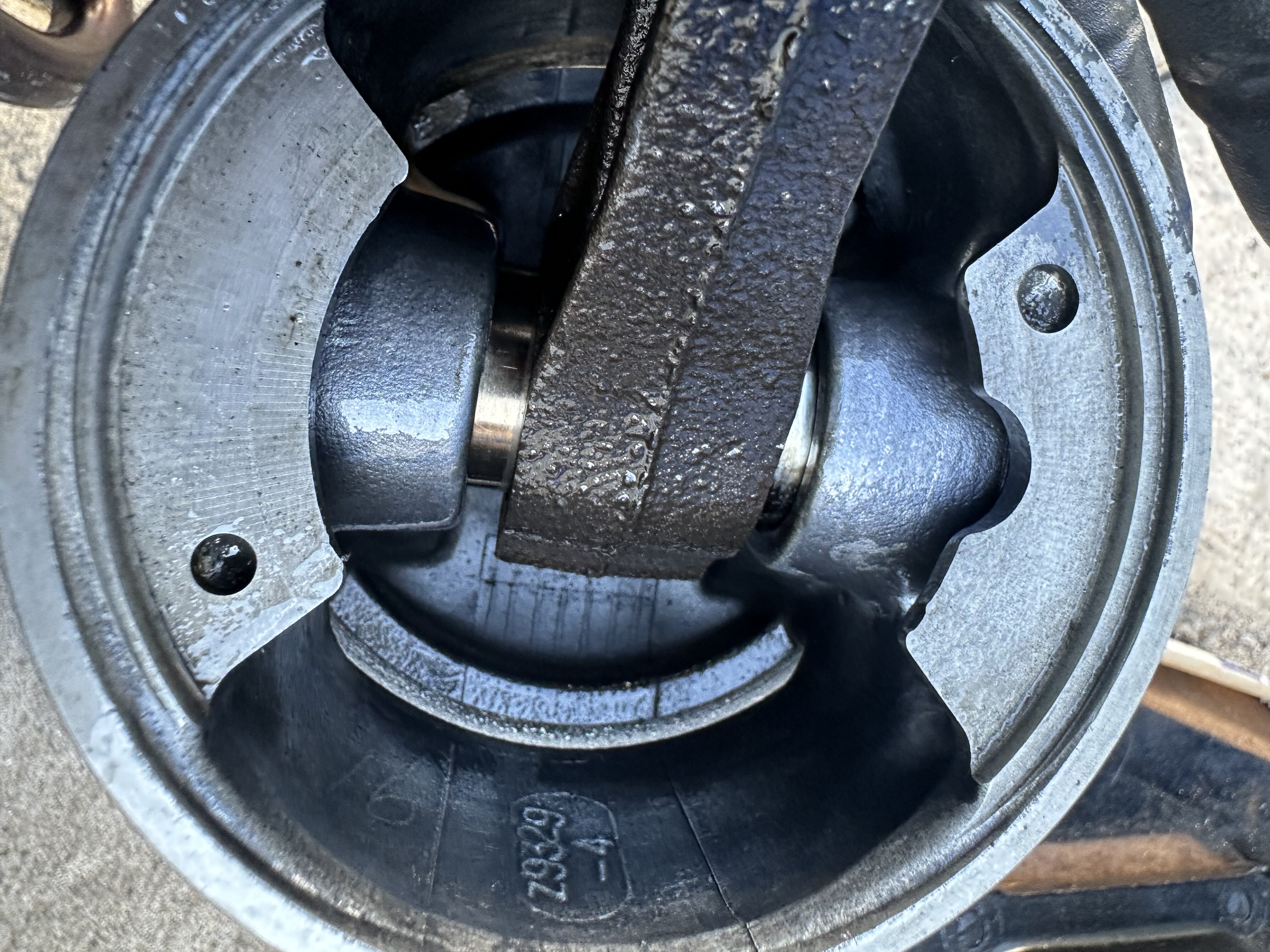

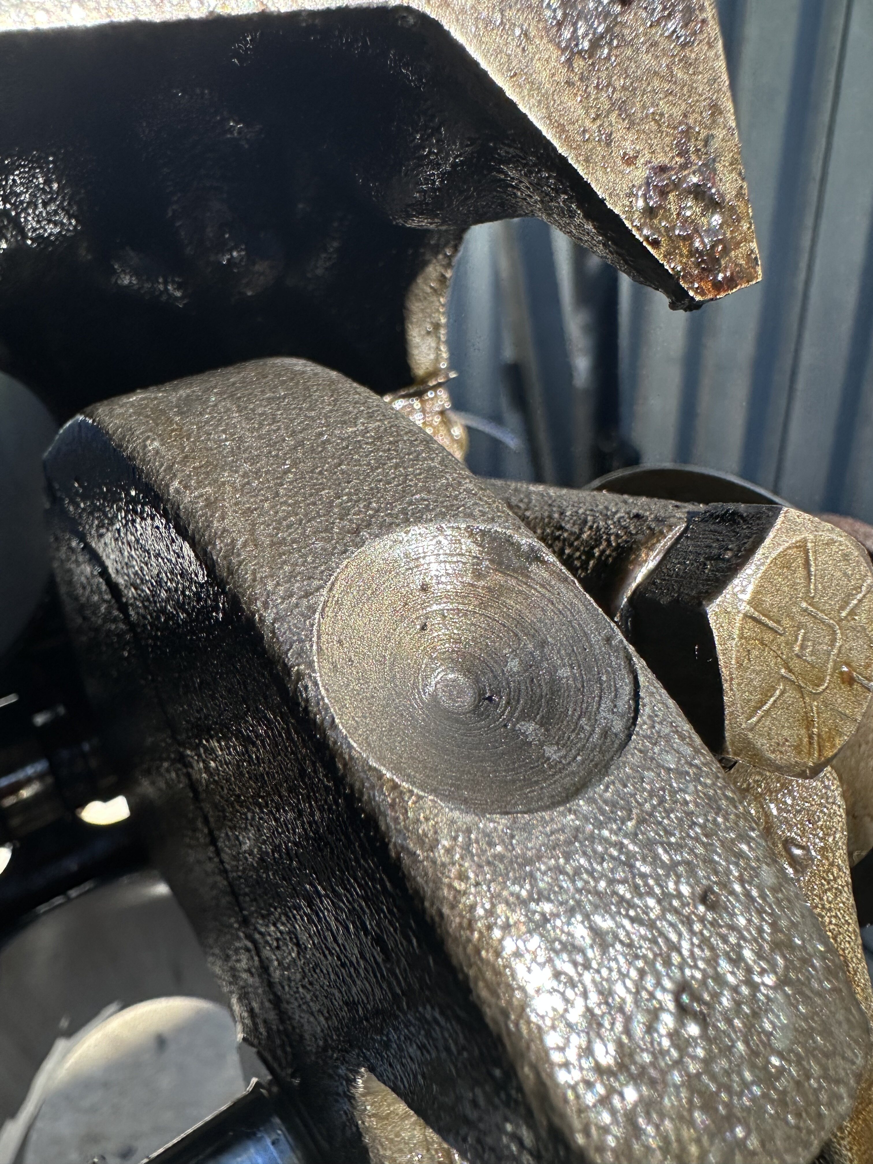

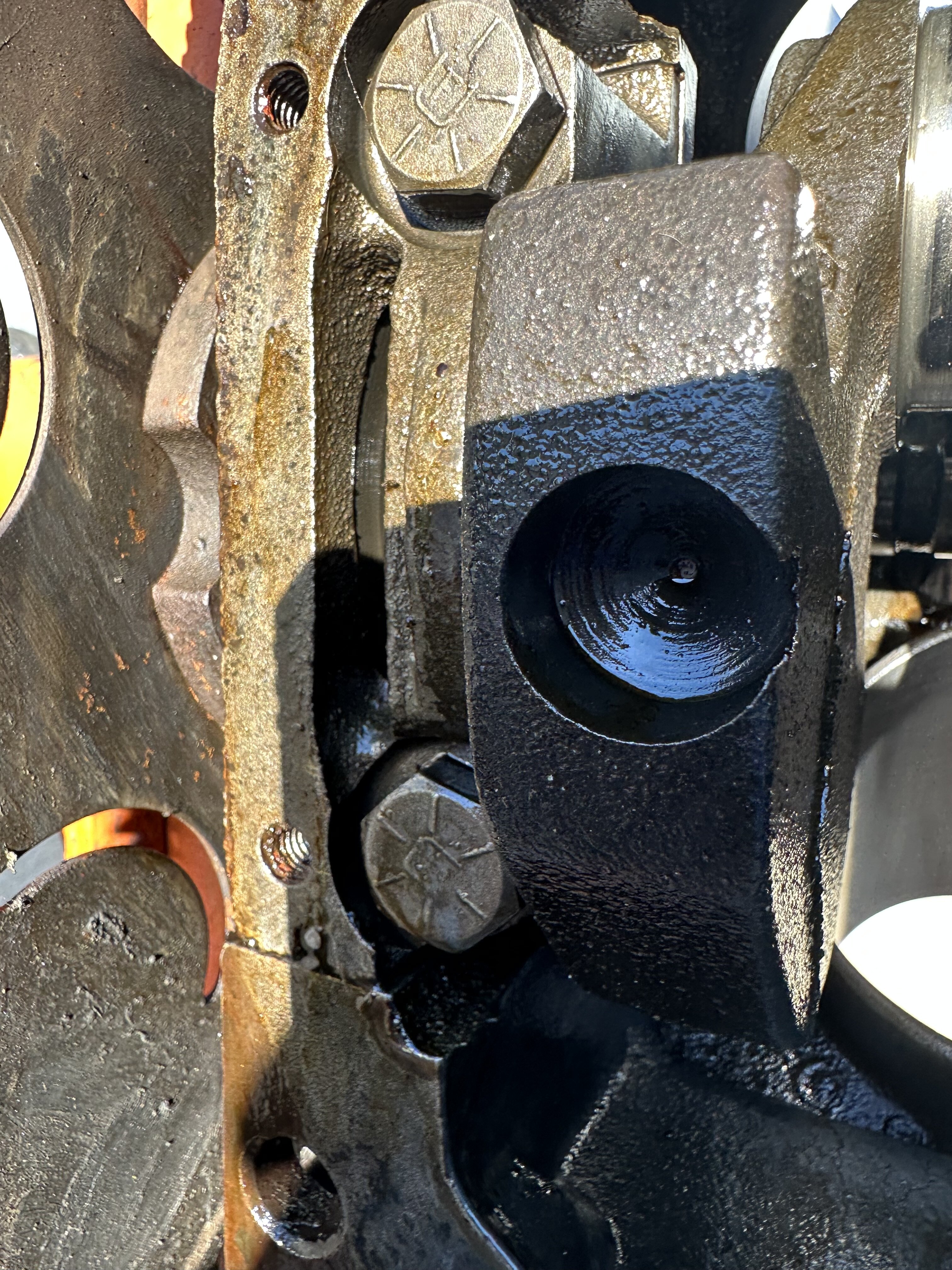

Yes they are factory, that is how they are balanced, also looks like your pistons are .020 over according to hastingsAre these drill marks from the factory?View attachment 227232View attachment 227231View attachment 227230
Right on, the other Buick engine I had didn’t have those.Yes they are factory, that is how they are balanced, also looks like your pistons are .020 over according to hastings
This what Hastings sent me so I ordered the 5474020. I’m going to follow there directions and send it. We will find out one way or the other.if the engine was running those pistons, run em again. Wont hurt it a bit. Is there any other number on those pistons, specifically on top? I dont recall them having any, and as far as i'm aware only the factory buick pistons have the nipple on them from casting. I wonder if your calipers are wrong... there are no commercially available .050 buick pistons, i doubt there ever has been. measure all the cylinders cross ways, north-south, east-west. Something is off here.
I did see in the one picture the piston says Z9329. With a google search "z9329 piston" it will brings up a .020 over piston. I see he says he ordered the "5474020" the last digits are 020 which is .020 i believe, atleast powersports piston numbers tend to be that way.if the engine was running those pistons, run em again. Wont hurt it a bit. Is there any other number on those pistons, specifically on top? I dont recall them having any, and as far as i'm aware only the factory buick pistons have the nipple on them from casting. I wonder if your calipers are wrong... there are no commercially available .050 buick pistons, i doubt there ever has been. measure all the cylinders cross ways, north-south, east-west. Something is off here.
Thank you for confirming what I was thinking. I was starting to have doubts lolI did see in the one picture the piston says Z9329. With a google search "z9329 piston" it will brings up a .020 over piston. I see he says he ordered the "5474020" the last digits are 020 which is .020 i believe, atleast powersports piston numbers tend to be that way.
