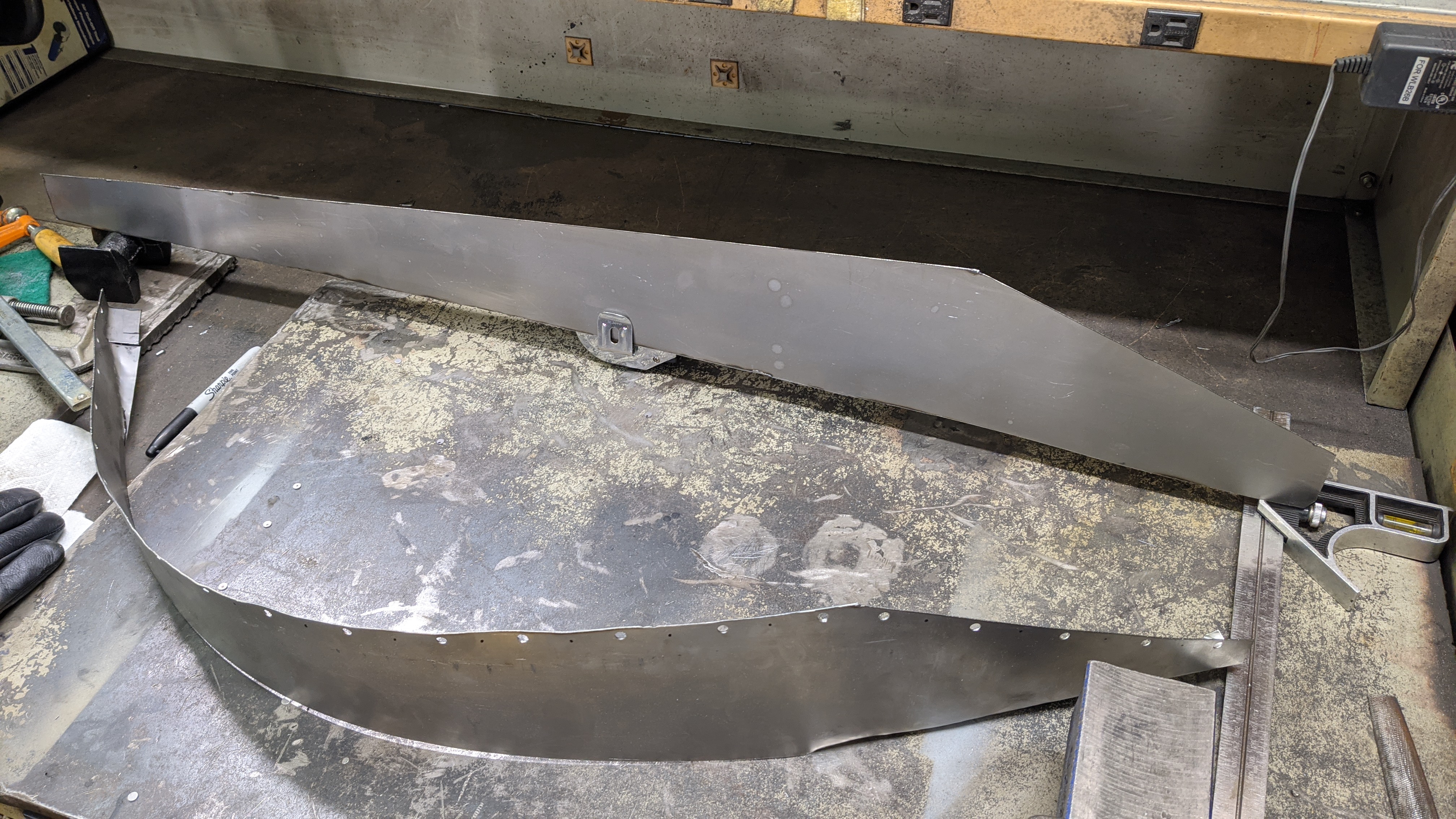

I made a thing. The plasma cutter has been a God send with project.
That's a 20 gauge shim. She's pretty tight.

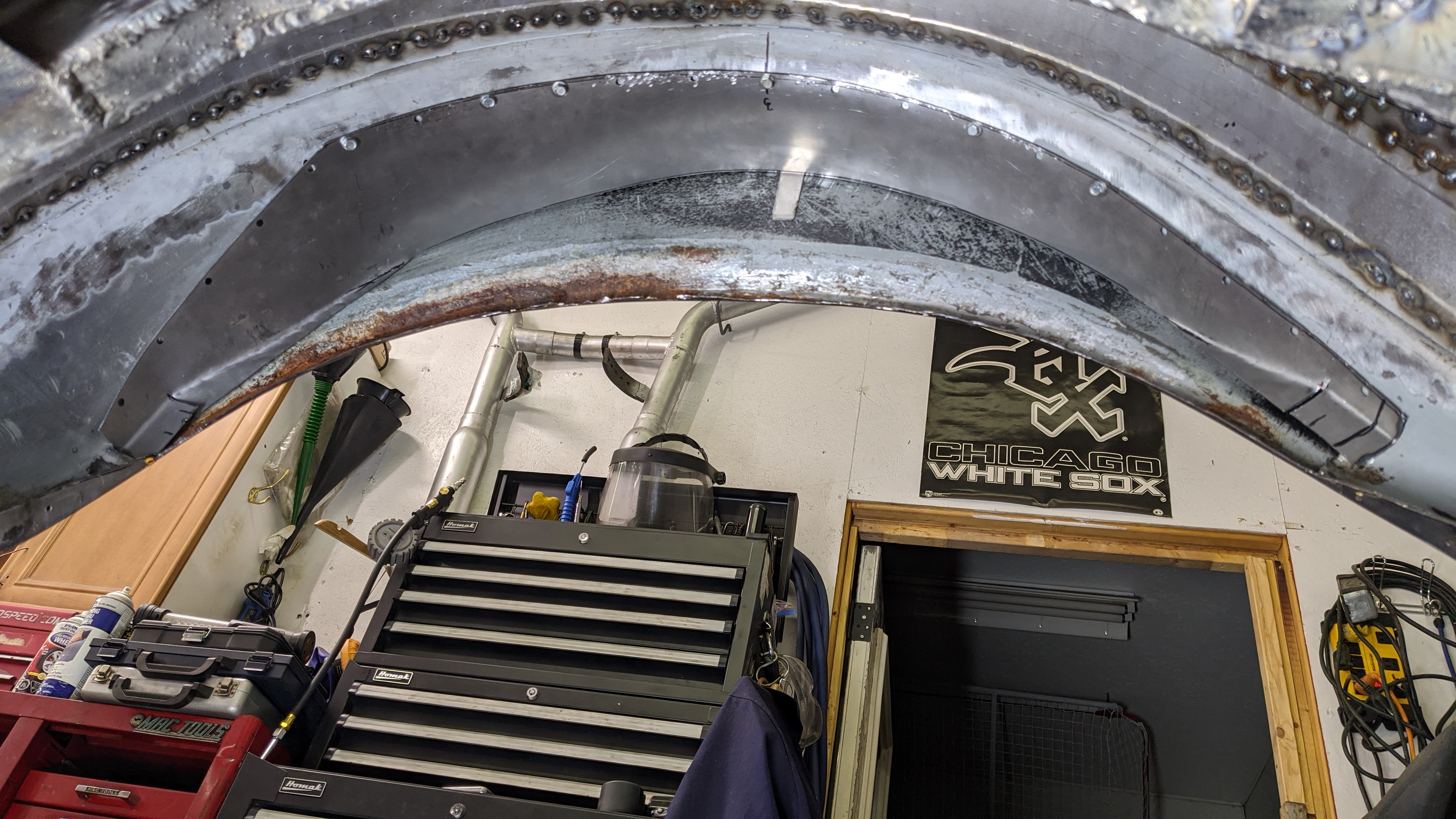

My only challenge now is how do I affix this to the quarter panel? Weld it? Glue it? Fiberglass it? Some? All?
But, I have to choose something because it goes...
That's a 20 gauge shim. She's pretty tight.View attachment 170914
weldin's out,you'll distort the life out of it and it'll look super bad.in a bad way.fiberglass and steel?don't get me started..seam sealer/panel bond if you also like to live dangerously..prep's key fyi with the panel bond/seam sealer.
