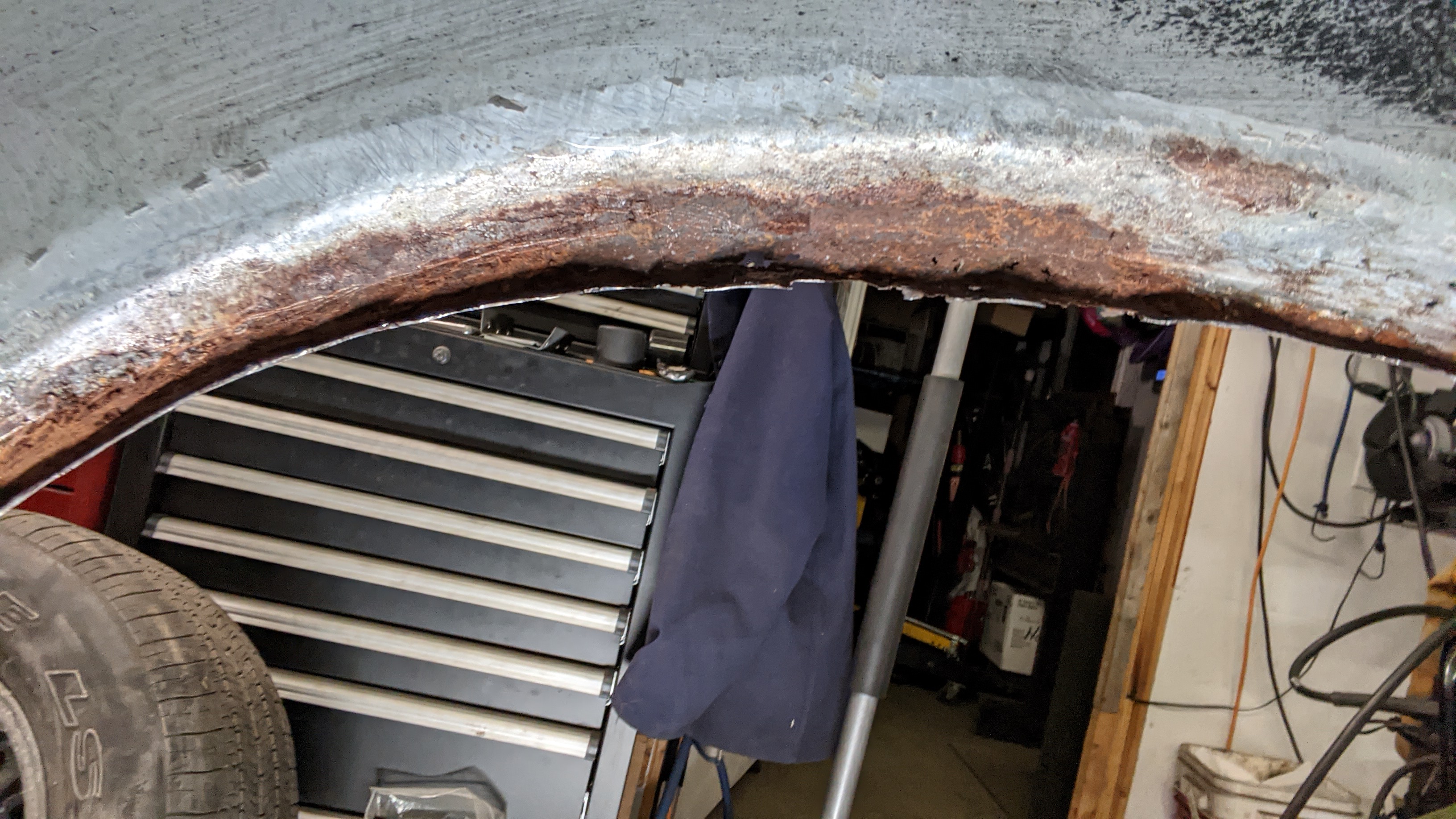

Time to make new holes, because reasons. Let's find some more room for more rubber.
First step: Plot out your cuts. Remember the wheel lip is double walled and the body saw didn't like it. So out came the pneumatic 3" death wheel...

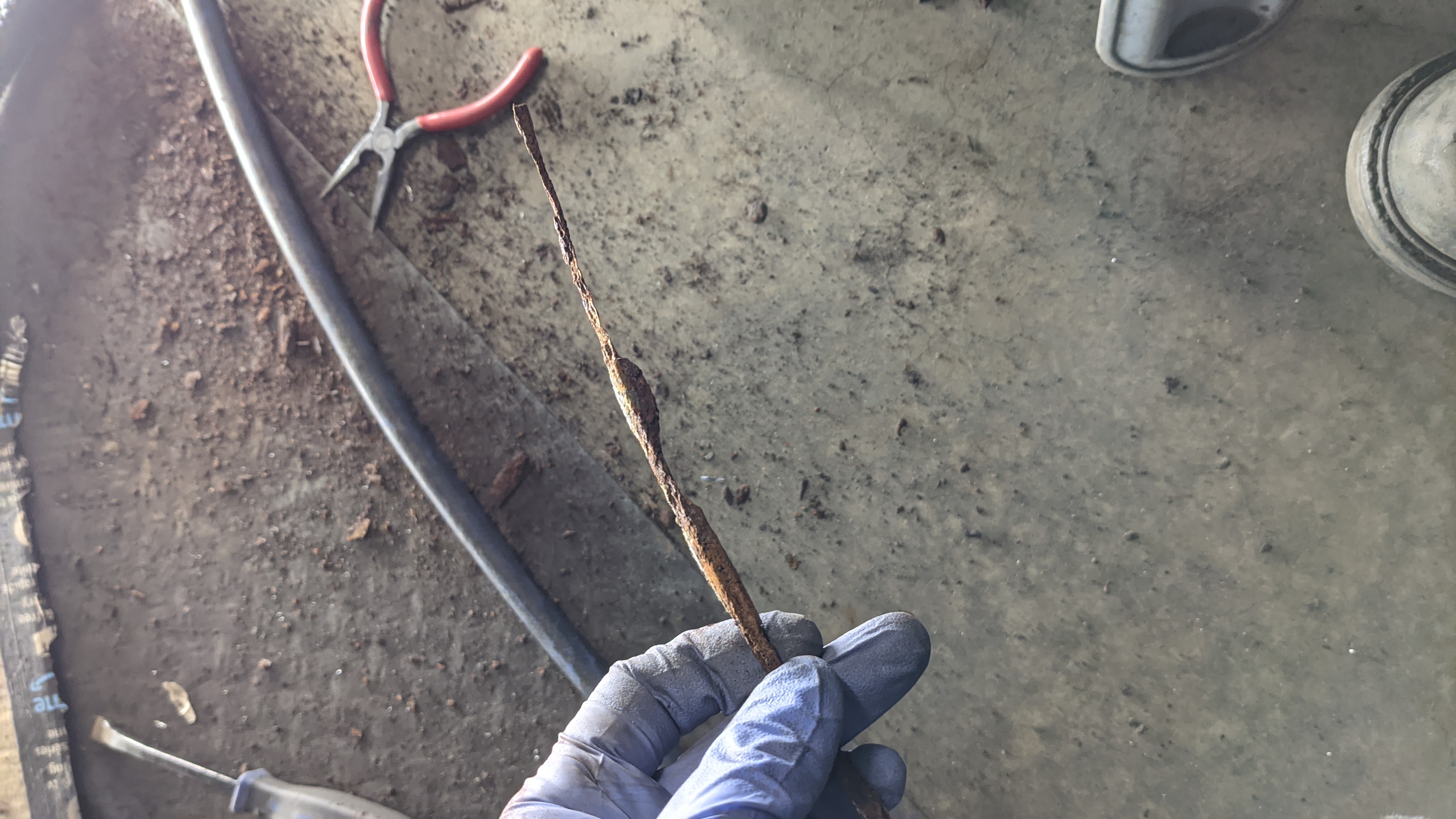

I named this guy: Foamy the rust covered tape worm.
He used to live in here:
And helped do this:
But, hey... this is a positive.

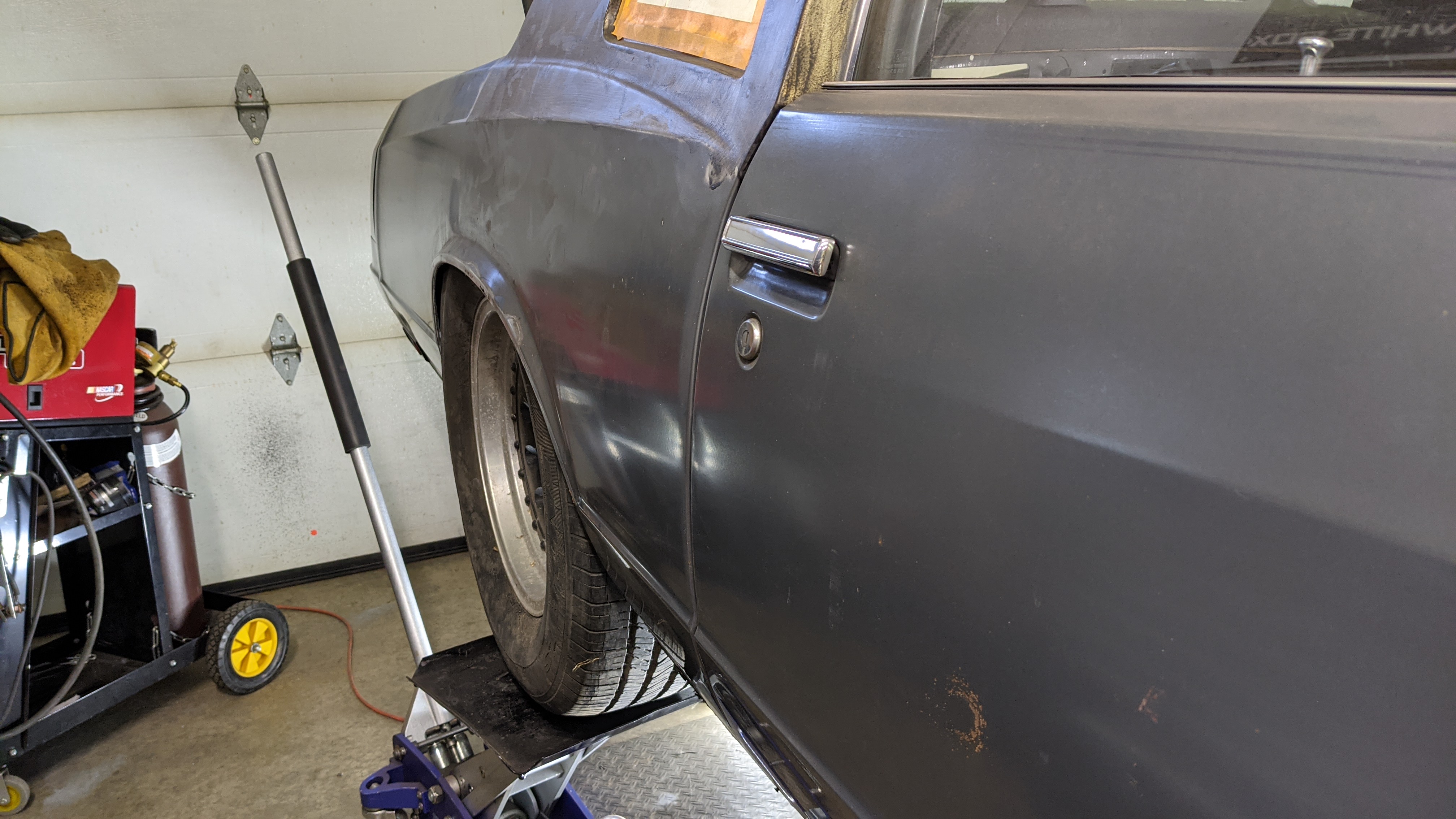

Sunk in wheels and tires look like *ss. We don't roll like that in this house.
That answers why I did all of this work. Remember this tire is a 255.
Lots of room for activities. Note this is the non-haggered side.

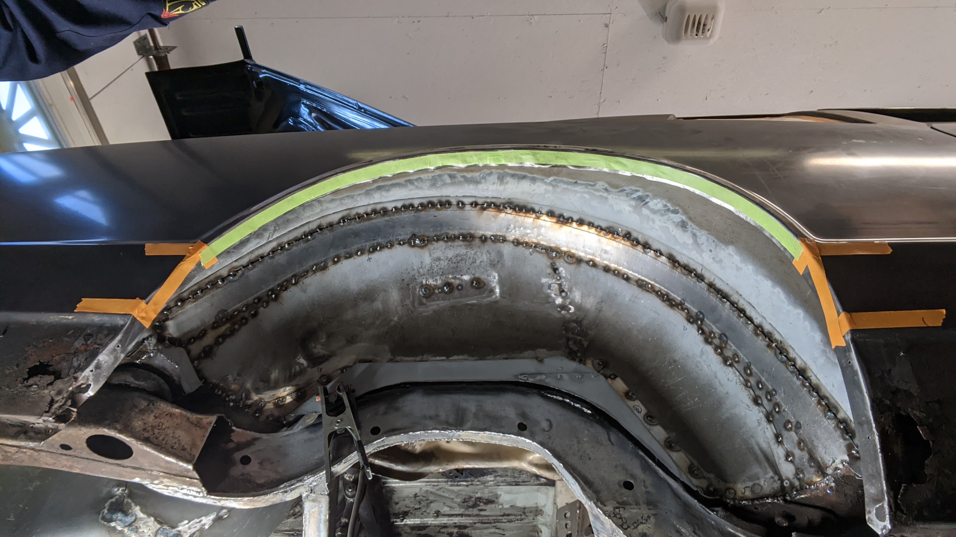

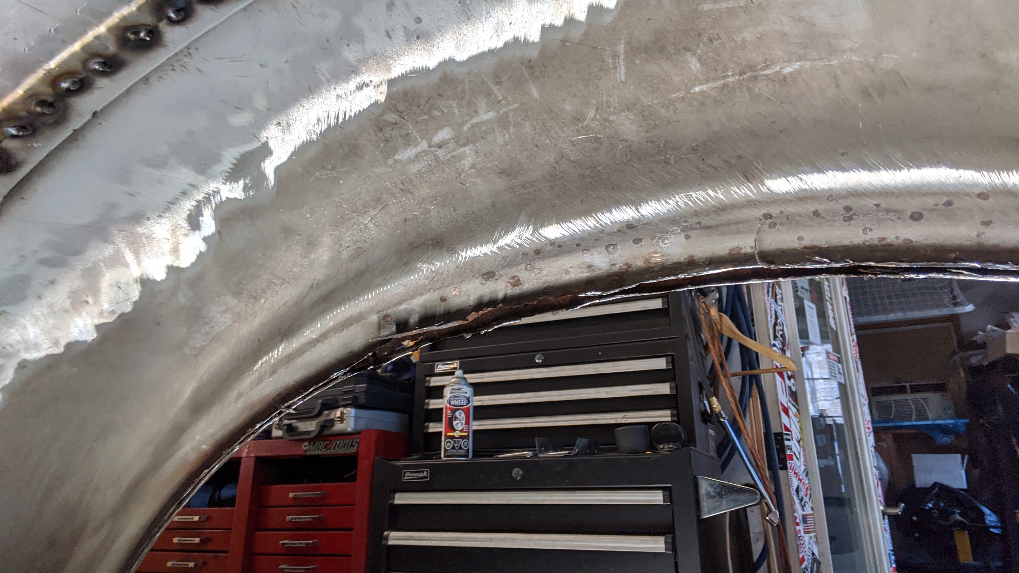

This picture demonstrates how f*cking stupidly shaped the factory wheel wells are. Squaring everything was paramount. The area that I cut out is basically anything that has a significant taper to it that would rub the tire.
There is almost as much room to be gained here by cutting out this part of the tub as notching the frame if you want to tuck a tire. If you like Sky Jacker shocks and shitty offset wheels you can skip this step and just let your mullet fly, Joe Dirte.

To be honest, I had a hard time visualizing what you were working towards until you recently put the inner wheelhouses back in it. I was having trouble seeing it, probably because I'm mostly looking on my phone. Now that you're this far along I get it and the results are pretty impressive. How wide a tire are you planning to run? At one point I thought to my self, "wouldn't it be easier to just back half the car?" and the answer to that is probably yes but the car seems way more stock this way. I'm looking forward to seeing the final meats in there.
Yes, a back-half would have been far less work. But, waaaay more expensive. Rails, tin, suspension, rear end, etc, etc, etc... all would have been on the menu.
The rationale, beyond money, is that I wanted it to look stockish. Kind of like what ASC did to the GNXs. Which are about as precisely built, BTW. Hence the COPO idea.
Right now it's kind of a halfway point between stock and a Guldstrand MCSS:
Tires will be something between 315 and a 390, up to 30" in diameter, tucked inside the fenders. The option to run anything in that range gives me a lot versatility.
Eventually I will get the car more "road race" oriented with proper suspension parts and modifications. But, that is a long term goal.
For now just having good power and cruising is plenty fun.
