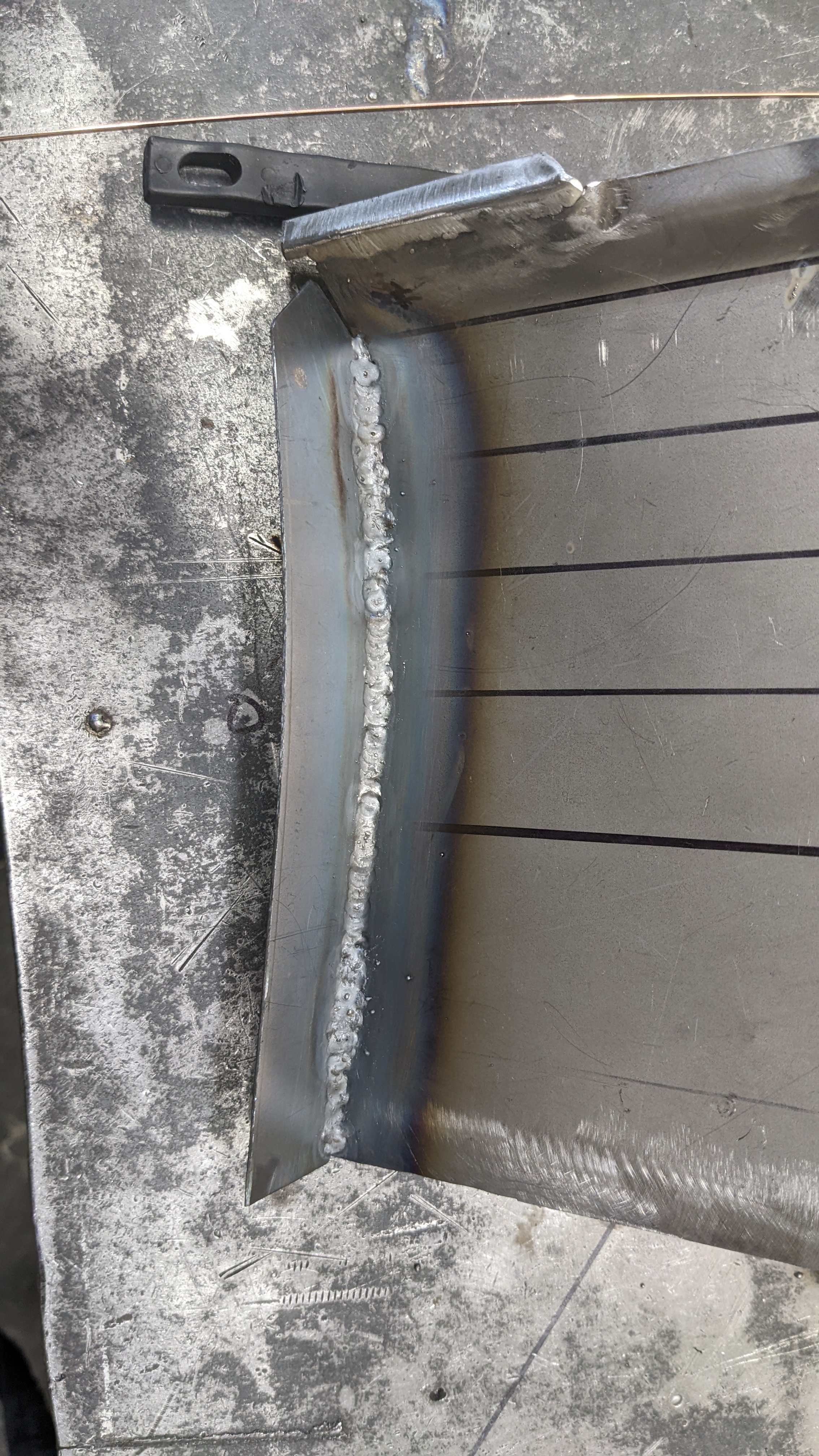

I did another thing.
Cut out and replaced the offending inner structure.
Replacement out patch made piece, by piece, by piece. I mentioned this before: TIG over MIG. Beats grinding. However it does cause the part to shrink... fortunately it shrunk in my favour.
Makes for a far less sensitive joint to grinding through than if you just weld and dress the outside corner.
And... done. The keen eyed amongst the two people watching this thread will see a 1x1 patch on the outer lip. That was cut out to access the rot behind it which needed a 3/16" plug to fix the inner lip, and then fix the rest of the offending area.
One more section to go!

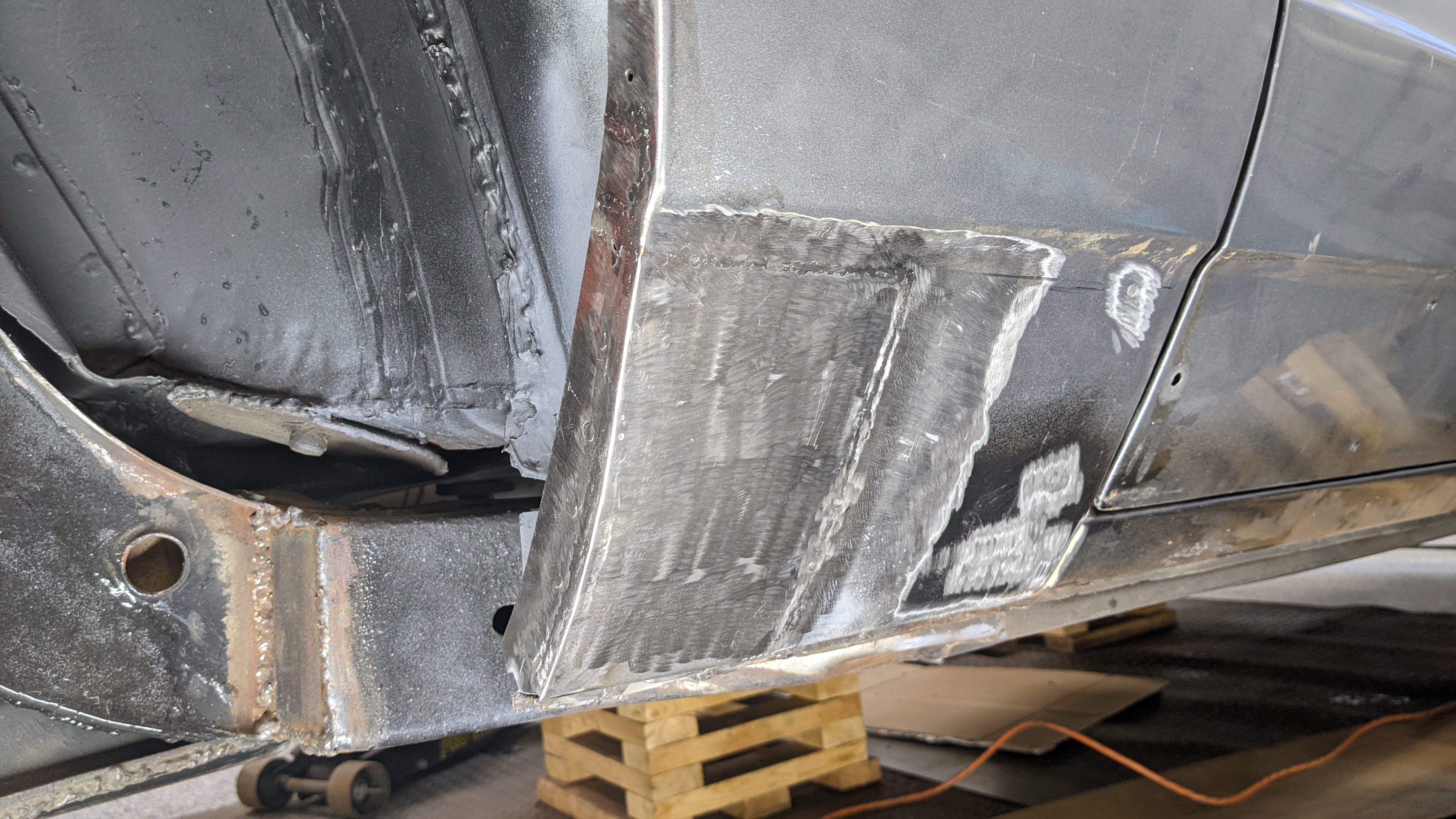

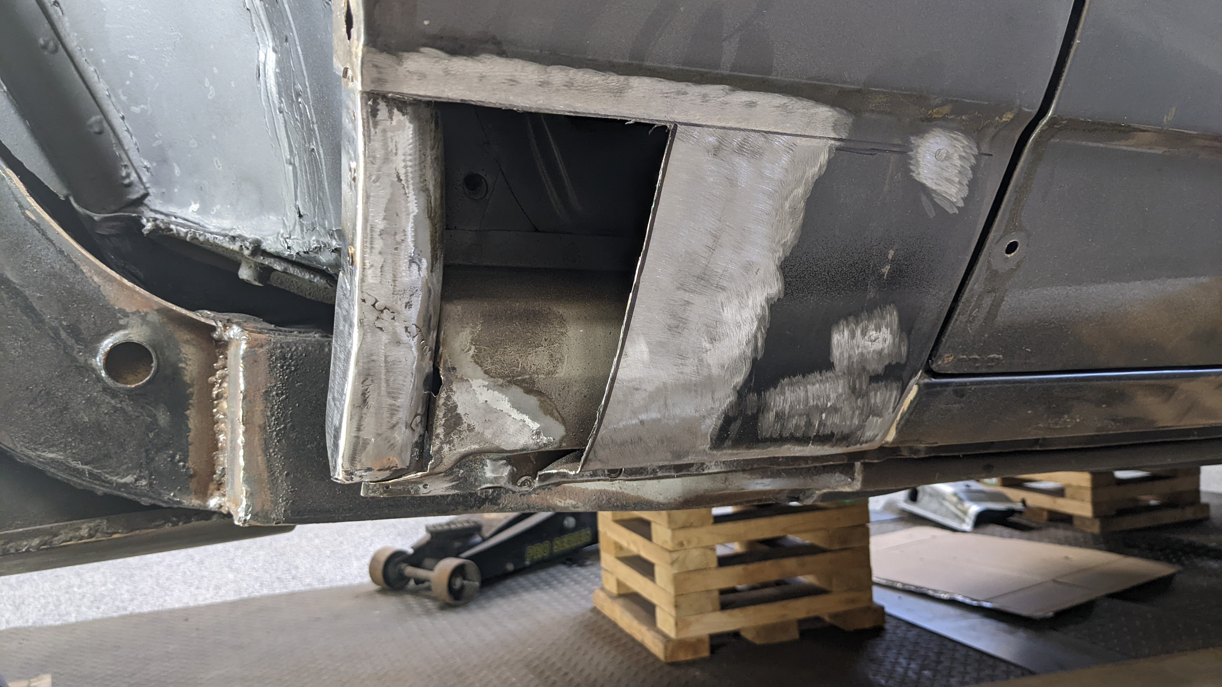

Is that a Rktpwrd smooth patch?
Looks good, you're making that look easy.
Nicely done Mike. I weld all my corner joints from the backside like that, it’s definitely the right way to do it. As long as your penetration is good, there’s very little cleanup to do on the outer faces afterwards.
A shrinker/stretcher used in conjunction with your new homemade metal brake would’ve made your life a whole lot easier with that patch tho. Regardless, it looks good and serves the purpose.
