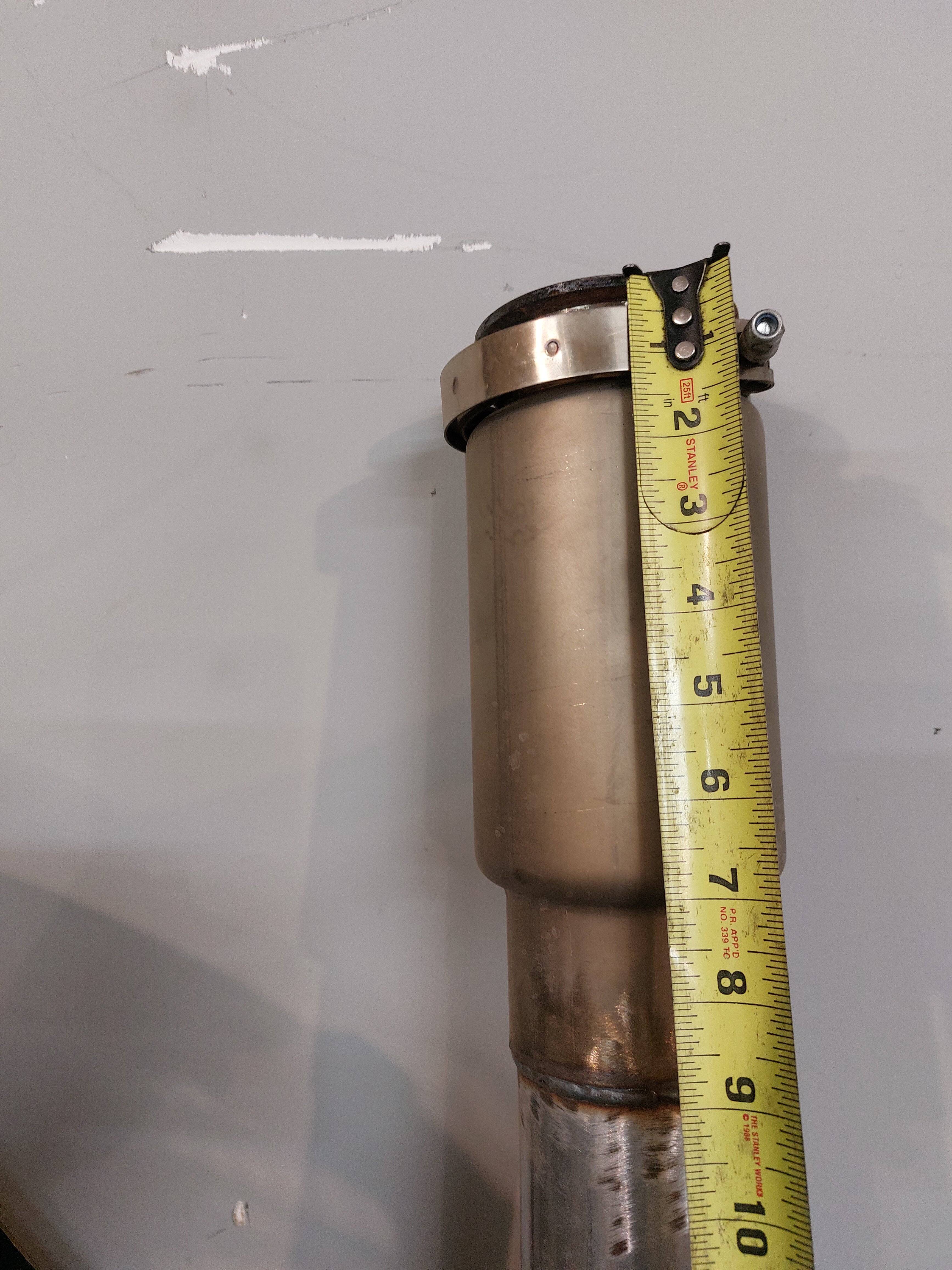

Need a spare 3" muffler? I can part with this bad boy, it'll tone it down as much as the turbo. Lol
Comes with a V Band.
Unfortunately 3" is a little small for my needs. But, thanks for the offer. I measured up the cat-hole and I can fit a 10" bodied muffler in the space available. So that's what I am aiming for. I might be able to relocate the existing muffler in this location, and just reuse that. Otherwise I am into another $100 stainless bullet muffler...
