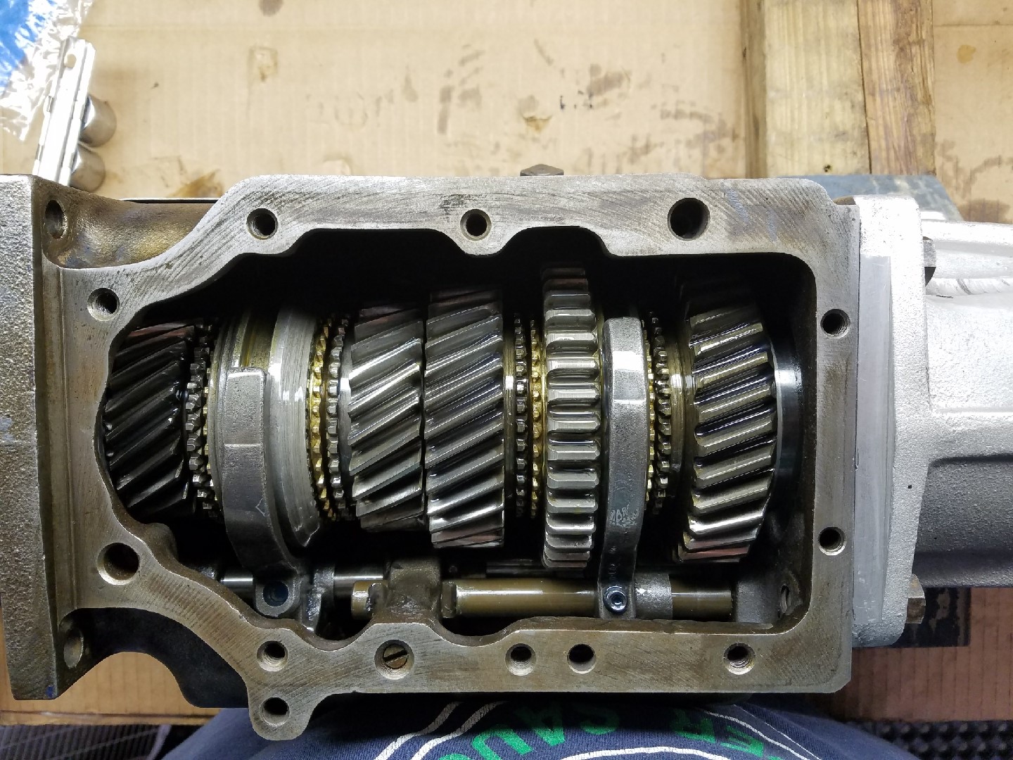

Sean and I got the Toploader buttoned up last night. We had to tear it pretty far down to get the main shaft and gear train out of it. My theory on the thrust washer behind first gear was wrong. The aftermarket replacement was actually 0.010" thinner. I replaced it with the original washer anyway. It turned out I made a mistake when I reassembled the 3-4 synchronizer. It turns out there are two different sized detents for the synchronizers and I forgot it. The long detents go in the 1-2 synchronizer, and I had that right, but the 3-4 synchronizer takes short detents and I had the long ones in it. This only happened because I have some extra parts from buying a small parts kit for extra lock rings. Consequently, when the tailhousing and front bearing support were bolted on, it was jamming the 4th gear blocker ring up against the 3-4 synchronizer and jamming the entire gear train against the rear bearing, putting pre-load on the whole assembly. Fortunately nothing was damaged since I had enough sense to not bear down or force anything. We corrected the assembly mistake and put it all back together. It turned out really well. Everything moves freely and it shifts like a dream. I think it might be the nicest trans I've built so far. I'm looking forward to getting it in the car and getting the Gear Vendors unit bolted on. Here are a few pics of the finished product...

That's a really nice job on the trans. I'm impressed. Keep up the good work.
Thanks for the kind words. After seeing the rust repair you've done on that Belvedere, the fact that you're impressed means something to me.
