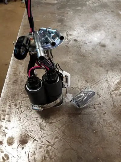

Racetronix is just another reseller of that assembly. Regardless, you won't be fitting that in a stock tank without a lot of surgery.

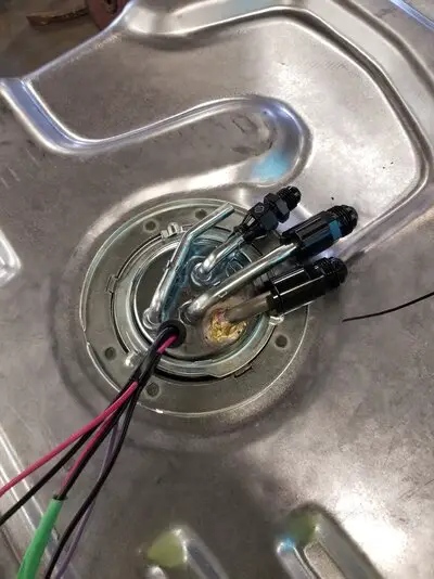

Update ***
Twin 225 walbros
Individual 3/8 to 8-an feeds which will Y- 20180521_110556.jpg 20180525_142326.jpg block back together right before the fuel filter
