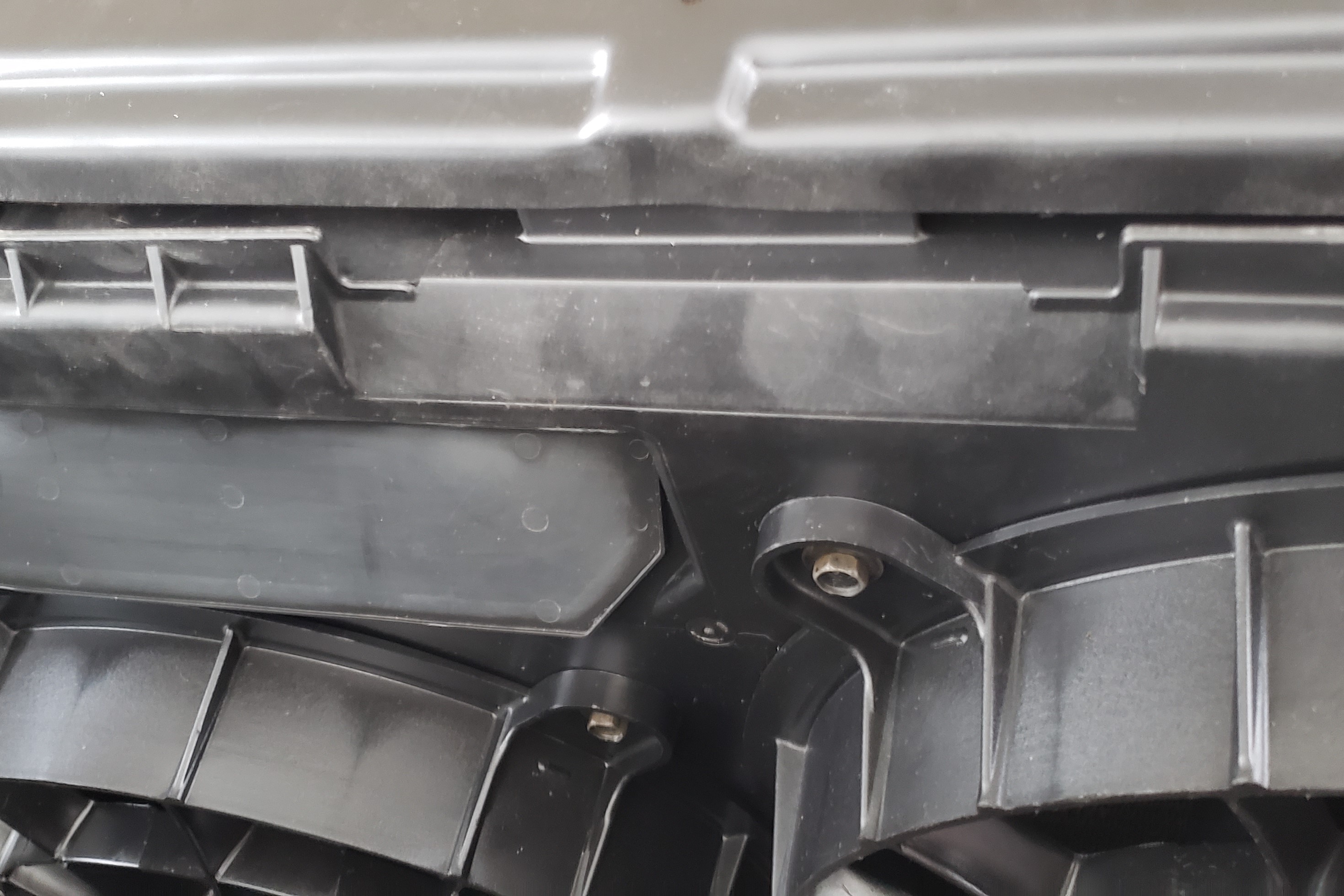

Update: The other day, I bit the bullet and removed the clutch fan and shroud from my '87 El Camino with stock 305 and 2004r. The plan has always been to replace the clutch fan with an electric dual fan setup from an 2000 Camaro. With the shroud removed, I dropped the efans in for a test fit and secured the top with a radiator retainer from an '87 442. I still have to install relays and wiring.
Update: The other day, I bit the bullet and removed the clutch fan and shroud from my '87 El Camino with stock 305 and 2004r. The plan has always been to replace the clutch fan with an electric dual fan setup from an 2000 Camaro. With the shroud removed, I dropped the efans in for a test fit and secured the top with a radiator retainer from an '87 442. I still have to install relays and wiring. View attachment 162886View attachment 162887
What relays are you going to use? I got a set of fans from a 2000 Malibu they look the same as yours
I just ordered a Painless dual electric fan relay kit from Summit. Initially, I had planned to do the wiring myself with a set of 20 amp relays purchased 2 years ago at the Hot August Nights swap meet...but couldn't find them in my garage. When I get the relay kit and complete the installation, I'll update this thread.
I have this 1986 IROC fan on my 85MC for 20 plus years was almost a bolt in some of the shroud holes lined up with the Monte Carlo ones so I didn’t have to drill them I did have to add aluminum flashing around the fan so it would pull all the air through the radiator without the flashing it didn’t run hot I use a painless relay and sending to turn the fan on and off and it works flawless I’ve gone through two relays in the last 20 some years Your pick up a little in ET and fuel mileage with the electric fan don’t be afraid to go to the junkyard and convert something to make it work be creative
