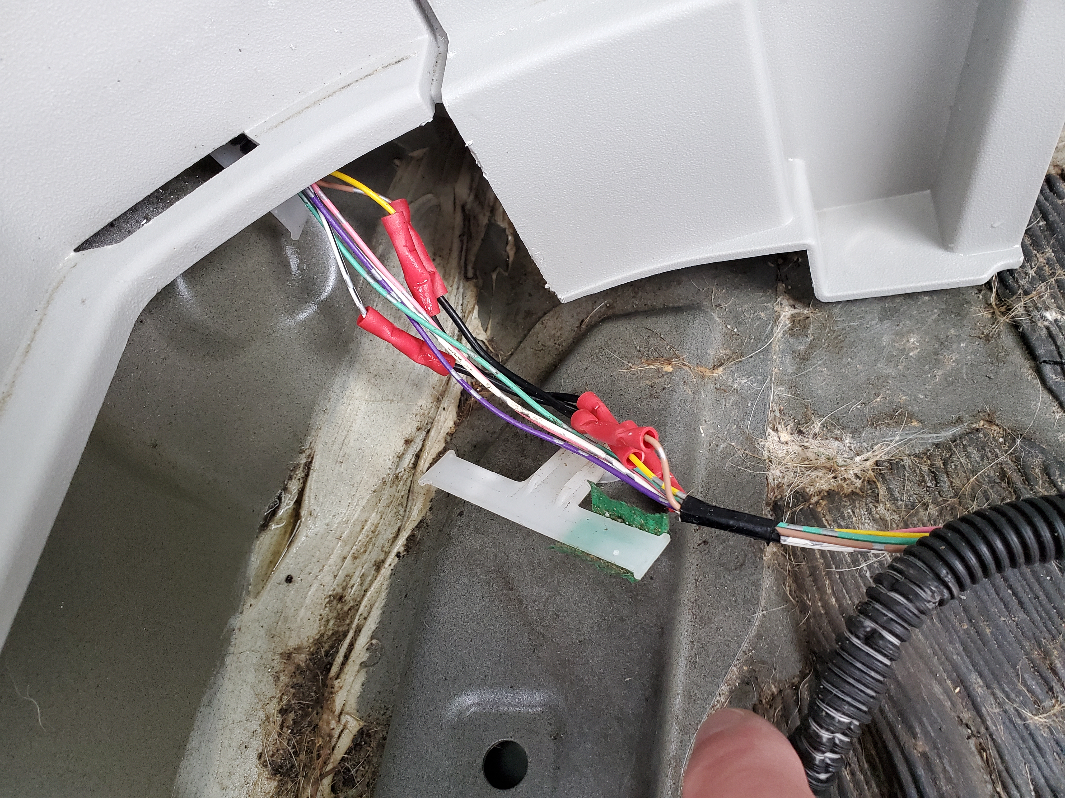

I did find this little surprise near the access point though. I'm pretty sure it's fuel pump related. Those cheesy splices will be redone properly before this car makes any long trips.

I also cut out the wiring "repairs." Replaced the fat black wires with the correct color and gauge. Soldered and shrink -wrapped all the connections. I feel better about it now.
