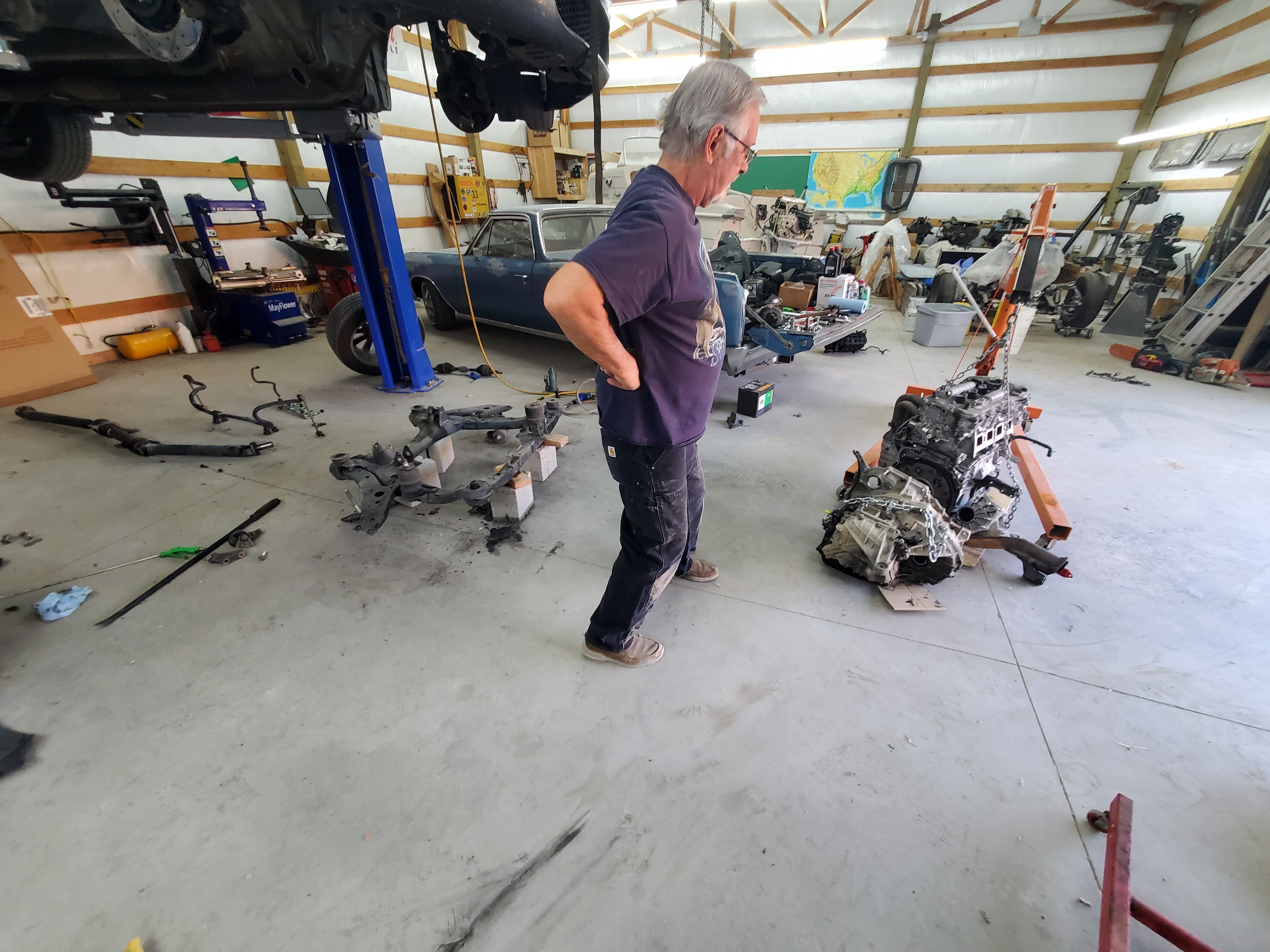

I wrastled the transmission swap on the Supervenza for a couple days. Its a ridiculous amount of work. My dad was pretty instrumental for about 3 hours in the middle.

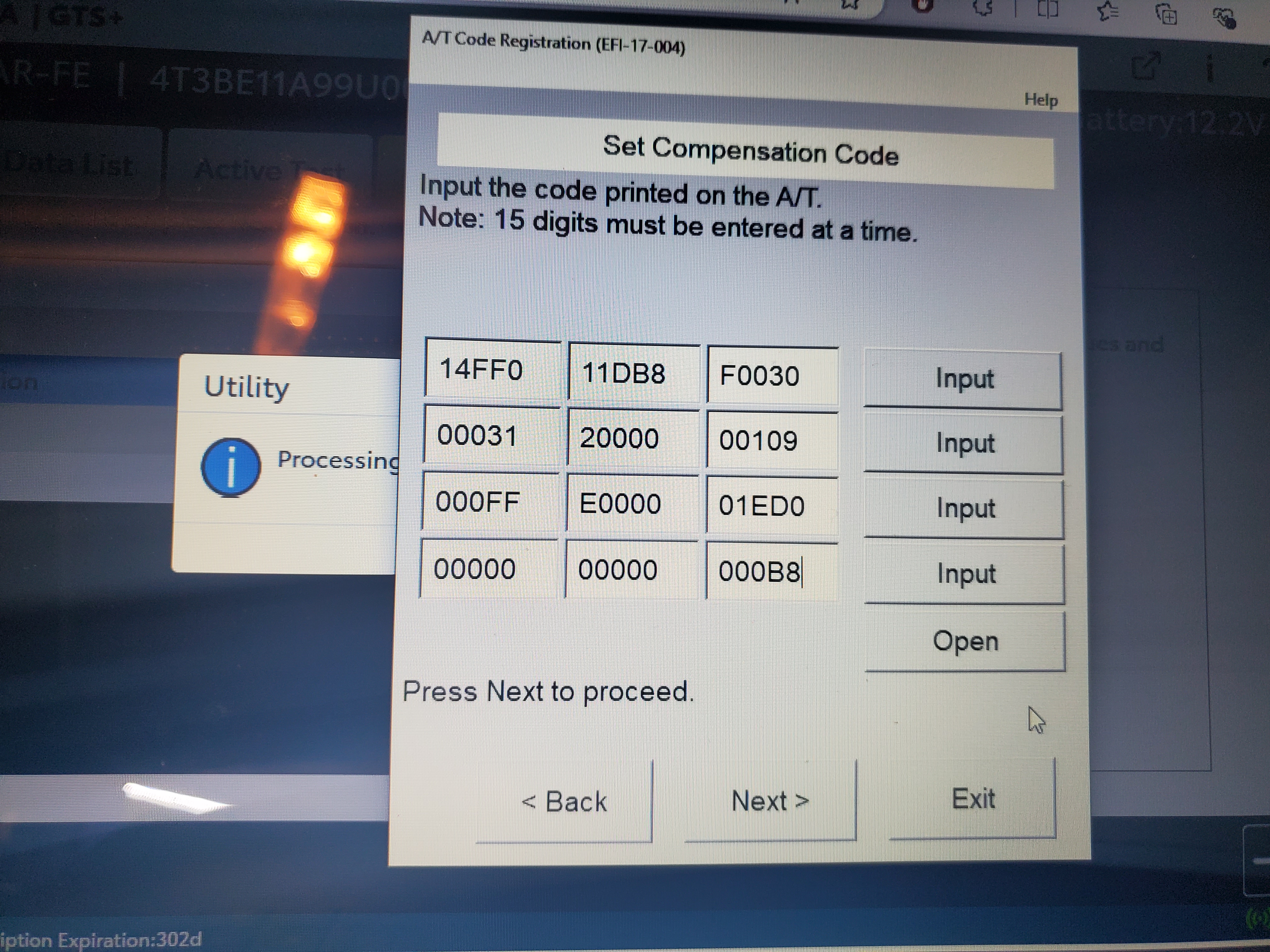

Once I got it all back together, there's a 60 digit recalibration procedure. Fortunately, I have the factory software for that.

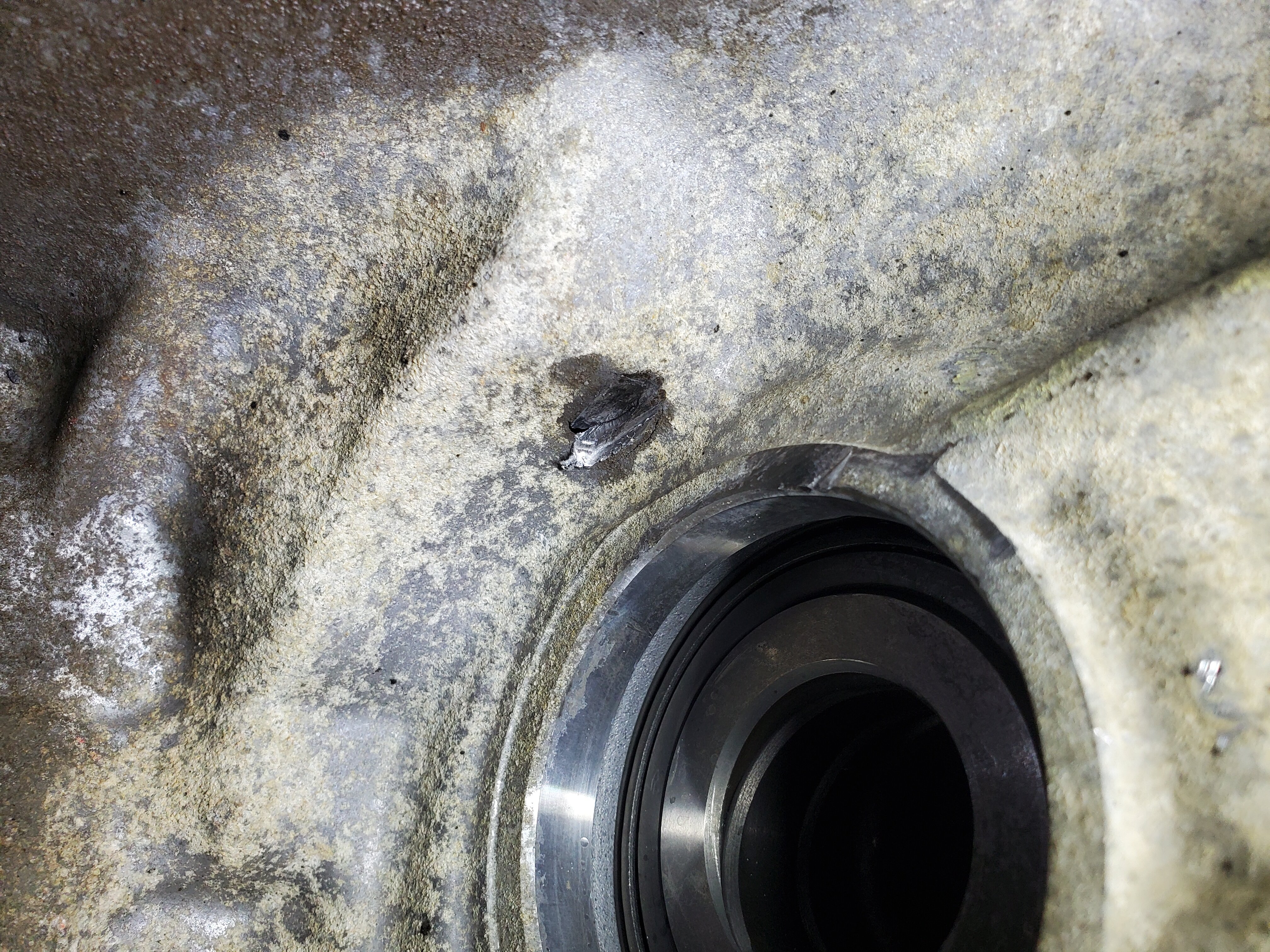

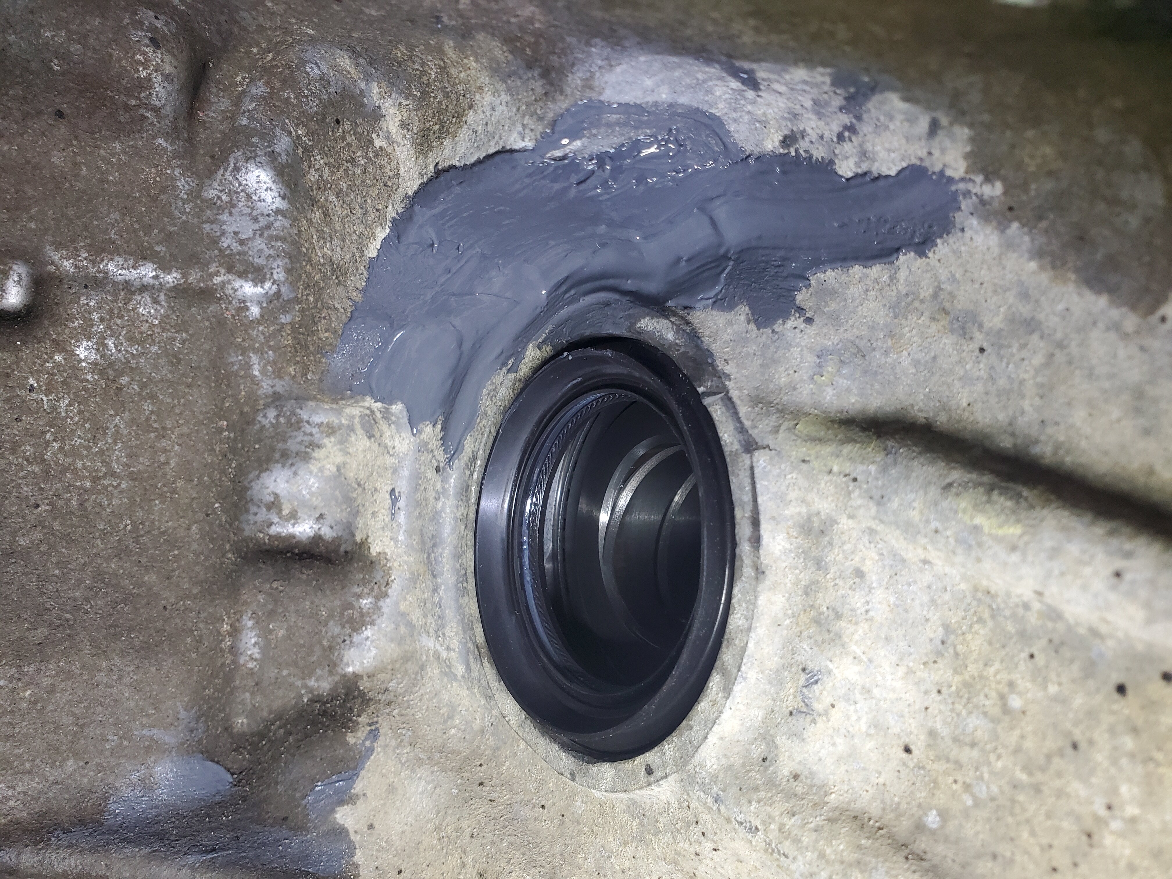

Initially, I thought it was an axle seal. Once I got it apart, I found out that the yard chimps had poked a hole in the case. **** LKQ! I cleaned everything up and put 3 thick layers of epoxy over the hole.
After 3 layers, I called it good. I did about 1500 miles for work this week ( in a loaner Vibe), but when I got back I put it all back together. Surprise! Now I have about a dozen communication codes. None of the modules are being friends, so now I only have 2nd and reverse. It was 105 degrees and I'm a quitter. I'll dig deeper tomorrow. Hopefully it's just a bad ground or connection.

I wrastled the transmission swap on the Supervenza for a couple days. Its a ridiculous amount of work. My dad was pretty instrumental for about 3 hours in the middle. View attachment 242755

Once I got it all back together, there's a 60 digit recalibration procedure. Fortunately, I have the factory software for that. View attachment 242756

Initially, I thought it was an axle seal. Once I got it apart, I found out that the yard chimps had poked a hole in the case. **** LKQ! I cleaned everything up and put 3 thick layers of epoxy over the hole.View attachment 242757View attachment 242758

Well, I might be over the hump...maybe. I went over all the connections and grounds and was still getting a U0101 TCM communication code. I went through the the diag tree in Toyota's manual (GTS+) and verified all the powers and grounds were present at the main connector at the transmission. I also ohm'd out the wiring between the TCM and ECM, no faults found. At some point during my testing I lost 2nd gear -- now only reverse.
The TCM on these is bolted directly to the transmission and the harness plugs into it. I attempted to resend the 60 digit calibration code and my laptop couldn't even communicate with it now. I swapped out for the original (to the car) TCM and powered it up, then cleared the code again. When I started it up. No lights came back on. Took it for a drive and it shifts fine. No pending codes and no leaks. Apparently, the "new" TCM must have been damaged in shipping and progressively shut down after the transmission install.
