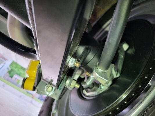

Has anyone successfully made their parking brake functional with Blazer rear disc.

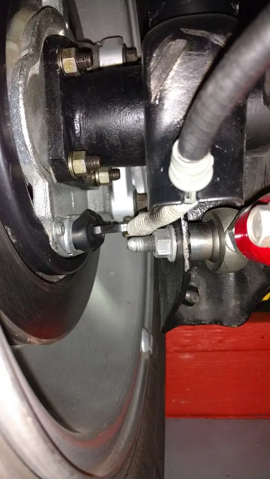

Left rear wheel

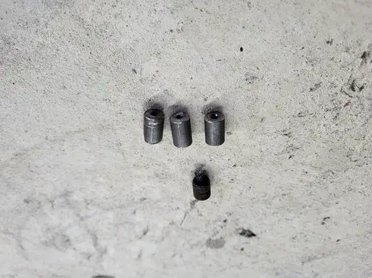

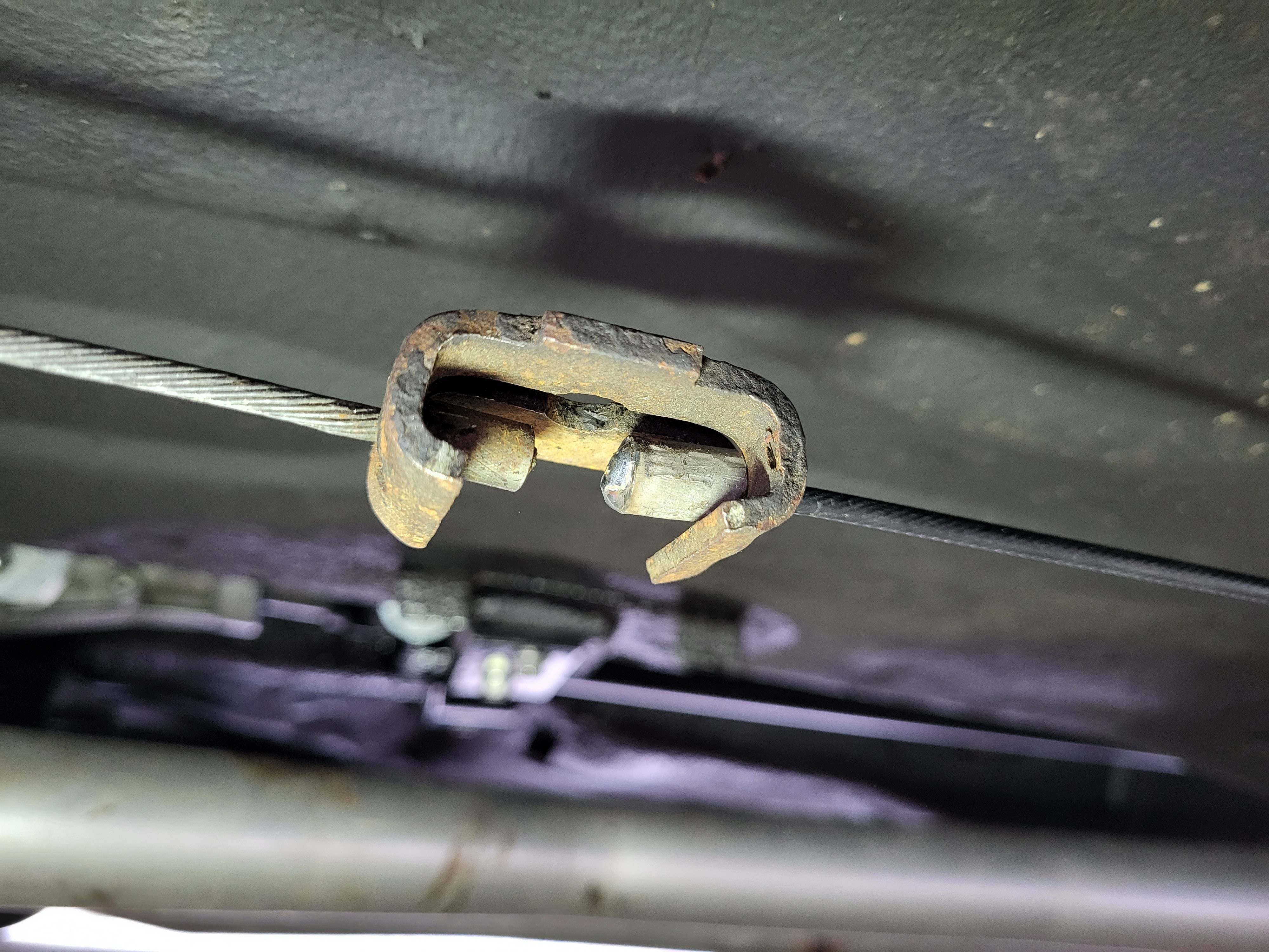

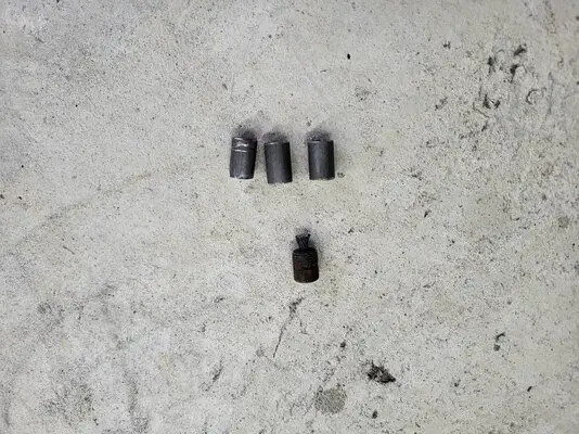

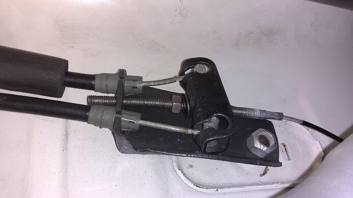

This is the connector between the front cable (from the pedal) and the left rear cable. I took this picture to show the New metal end I made. Cable was cut to length and metal end mig welded on. Second picture shows the original metal end clipped off of original left rear cable and the spare ends I made incase I had to shorten the cable more.

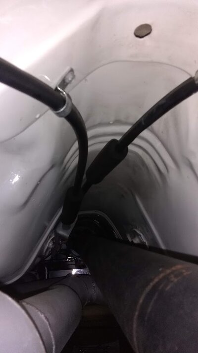

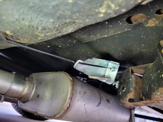

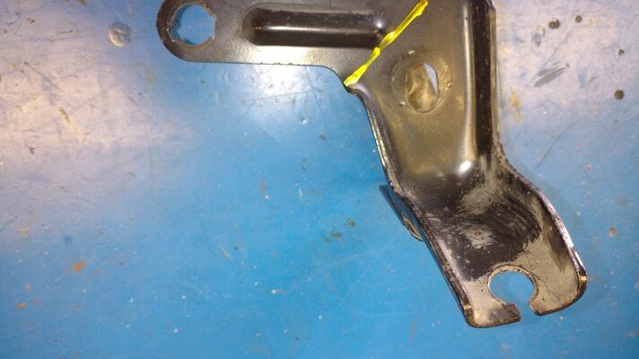

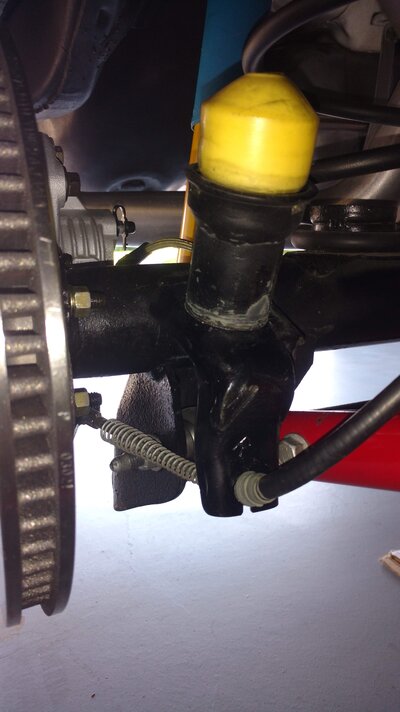

Yes; I used the e-brake cable brackets from a 2002 Camaro which is the system I am using, cut as shown and attached to the bump stop bracket. Used the original cable bracket using the seat belt bot as attaching hardware by the drive shaft. Had to cut and the Camaro cables to proper length while using the original front cable also cut to length. Took a lot of mental figuring out and trail and error bracket and cable cutting to get the right length.

The 98-02 Camaro brakes are not really the same as the Blazer set up. My original post was asking if anyone had made their parking brakes functional with the Blazer set up. I was able to make mine work by modifying the 2 rear cables and used all of the OEM brackets and mounting with no additional modifications.

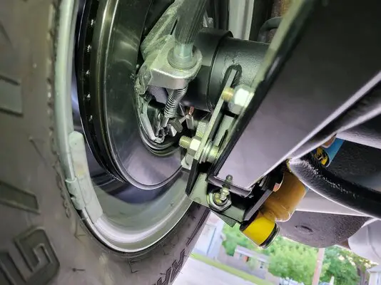

Left rear wheel
