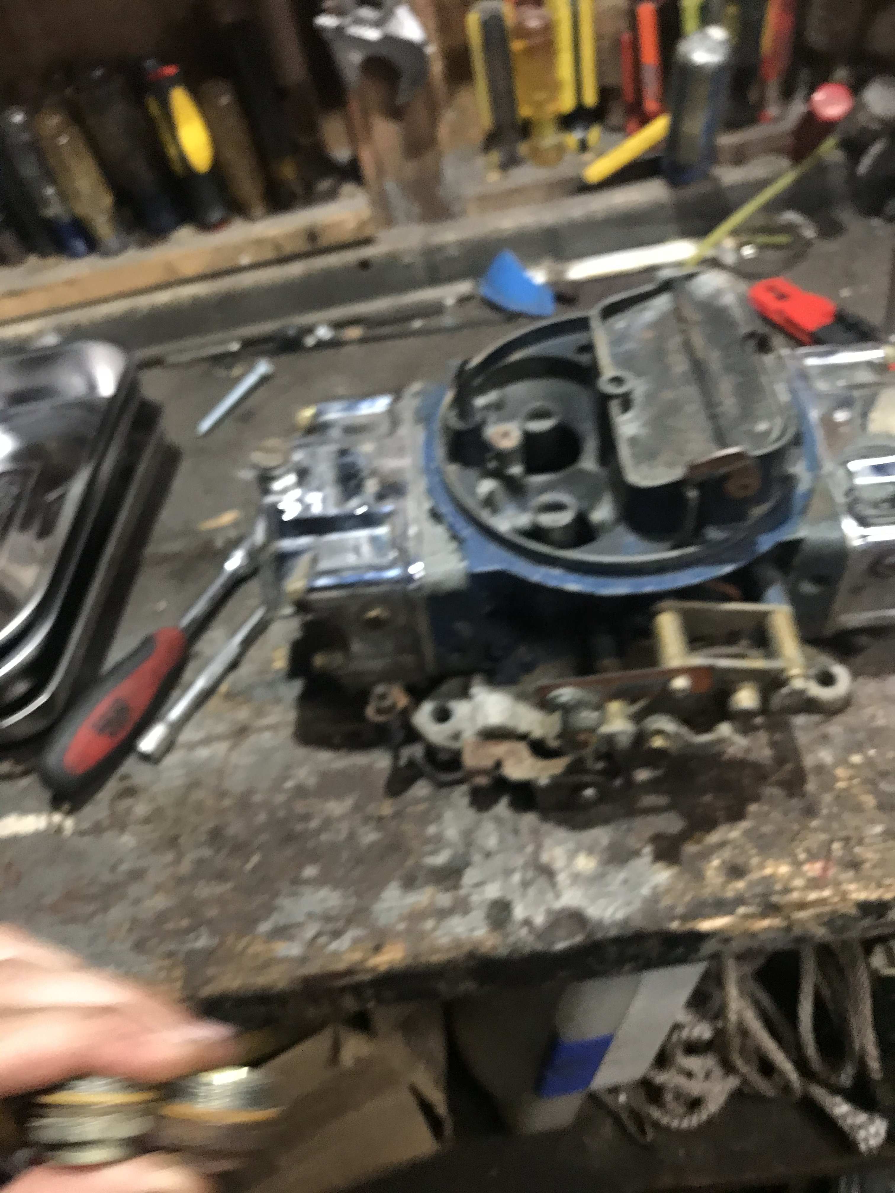

The Holley wouldn’t of worked in the condition I got it in, it was fairly beat up.
It’s hard to see, but that choke linkage was bent inwards by an 1/8th of an inch.
I replaced every component save for the big items, it got every gasket and seal, needles and seats, throttle shafts, throttle plates, and every spring. I put the correct squirters in it according to the list number.

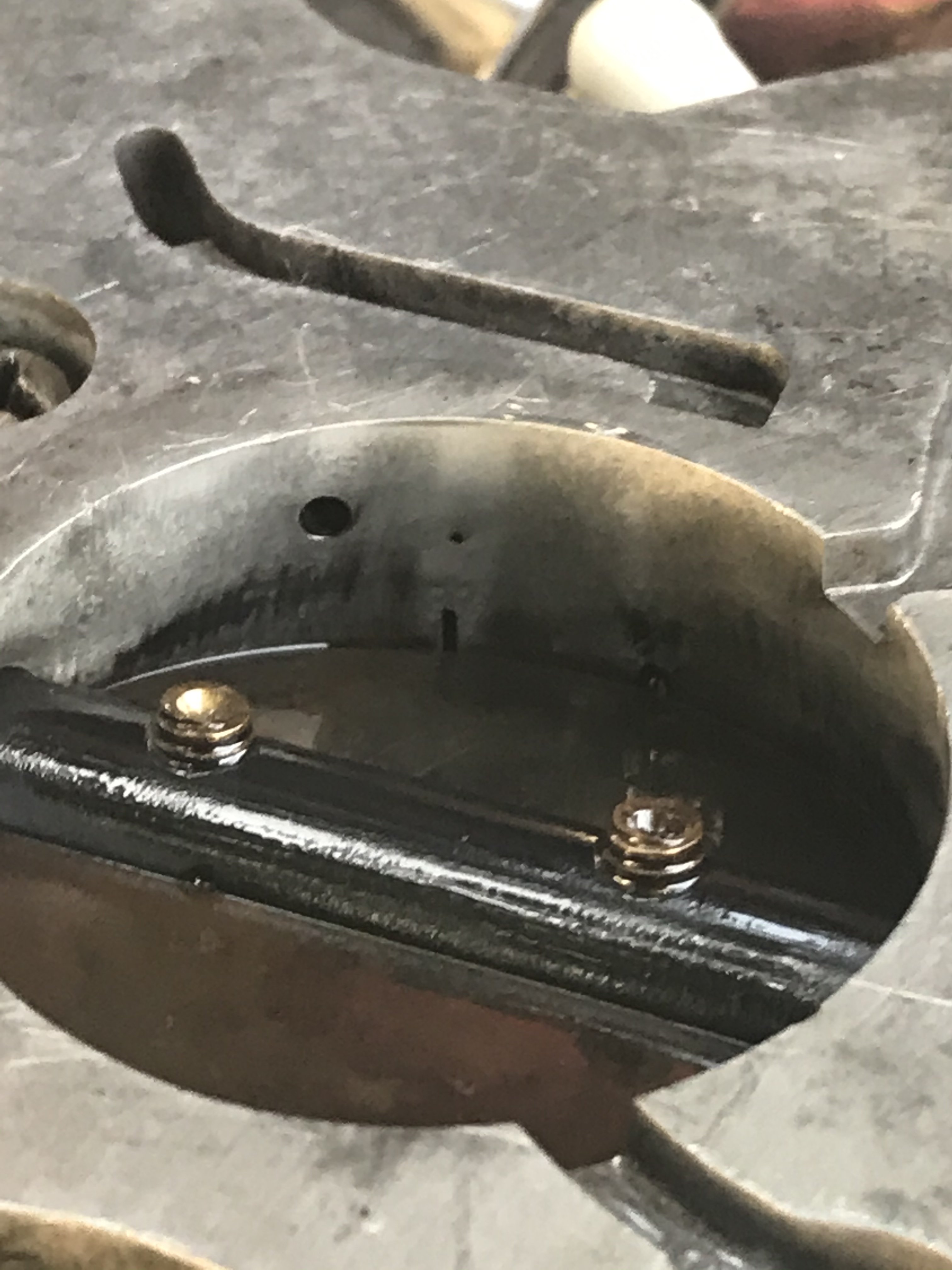

From what I’ve been understanding, both primaries and secondaries need to be adjusted equally, that includes transfer slots exposure. The primary accelerator pump sprays as soon as the throttle is even touched, it doesn’t lag behind.No transfer slots on the secondaries, as far as i know. Double pumpers may be different?

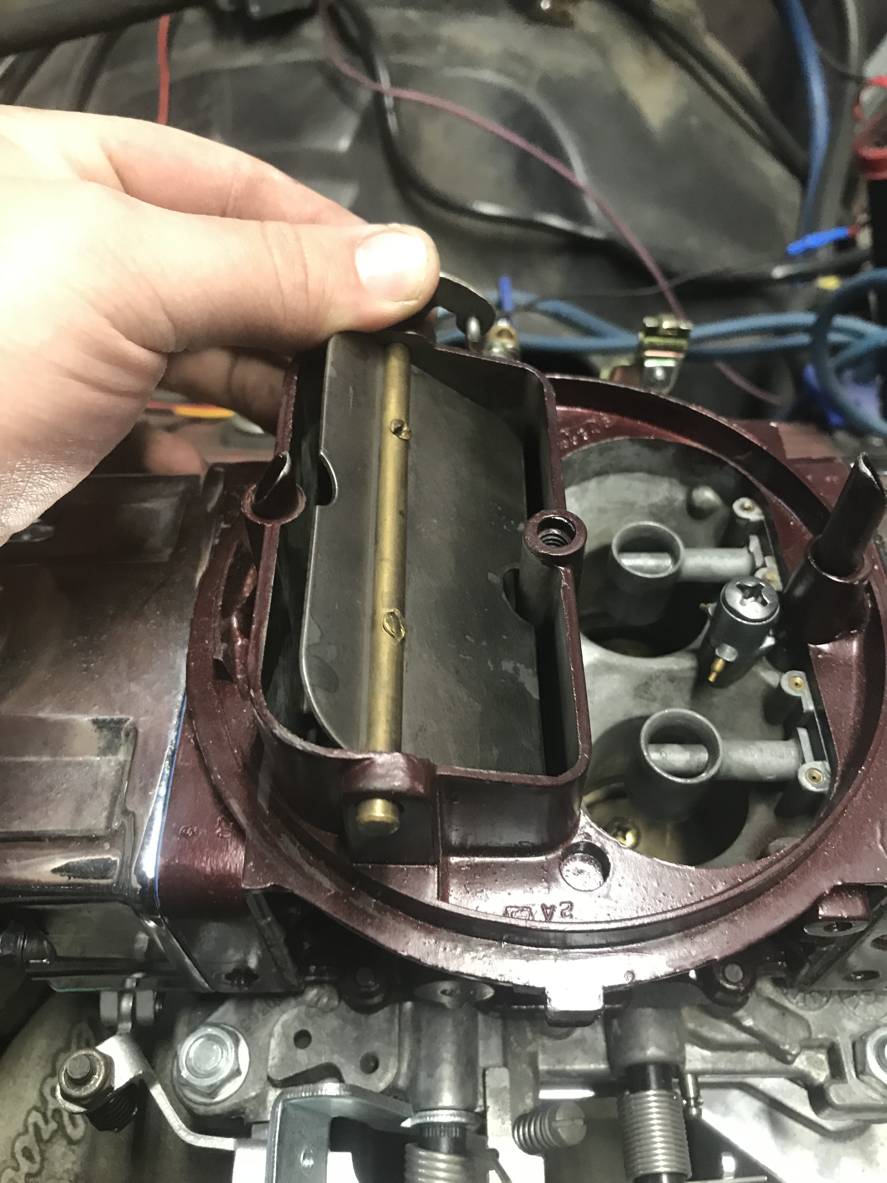

That's another thing: have you adjusted the accelerator pump?

Try cracking the secondaries open a little. That should allow you to close up the primaries enough to cover the transfer slots.Now that’s awesome.

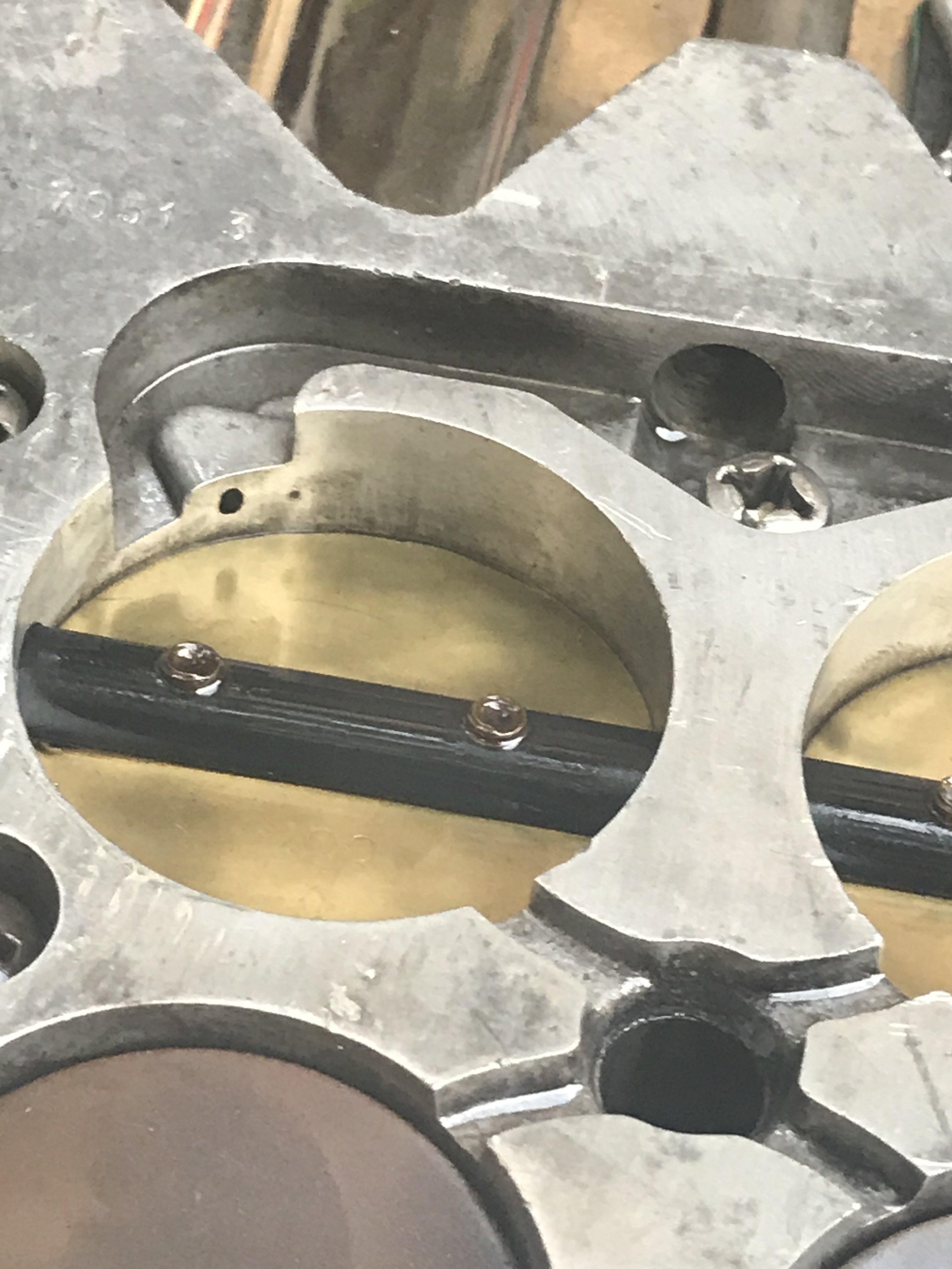

My transfer slots on the other hand, sort of aren’t. The primaries are way too open.
And the secondaries aren’t even showing the slot.
