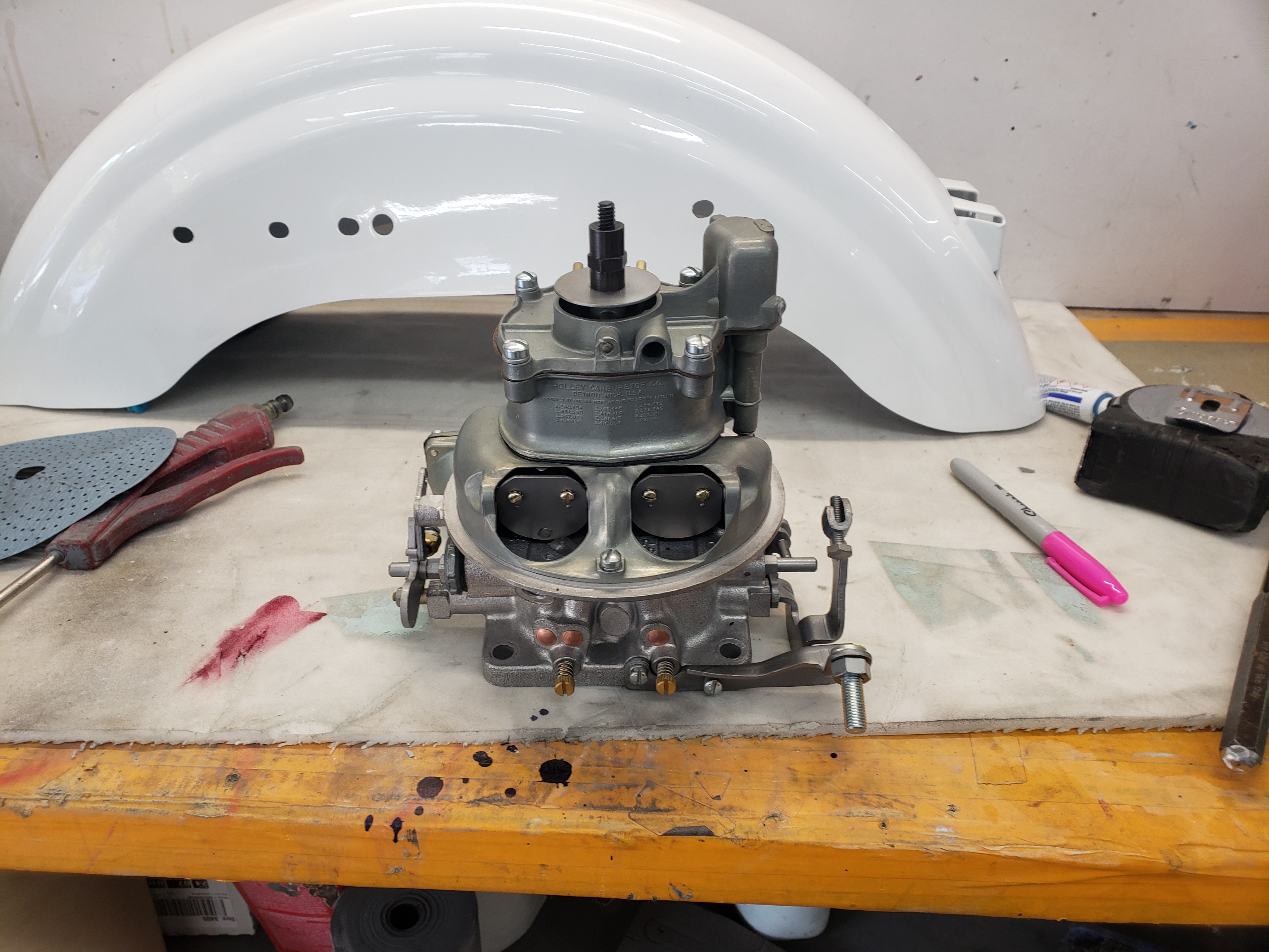

Now This is a carb.Got this in the mail @ work today.its a holley tea pot
