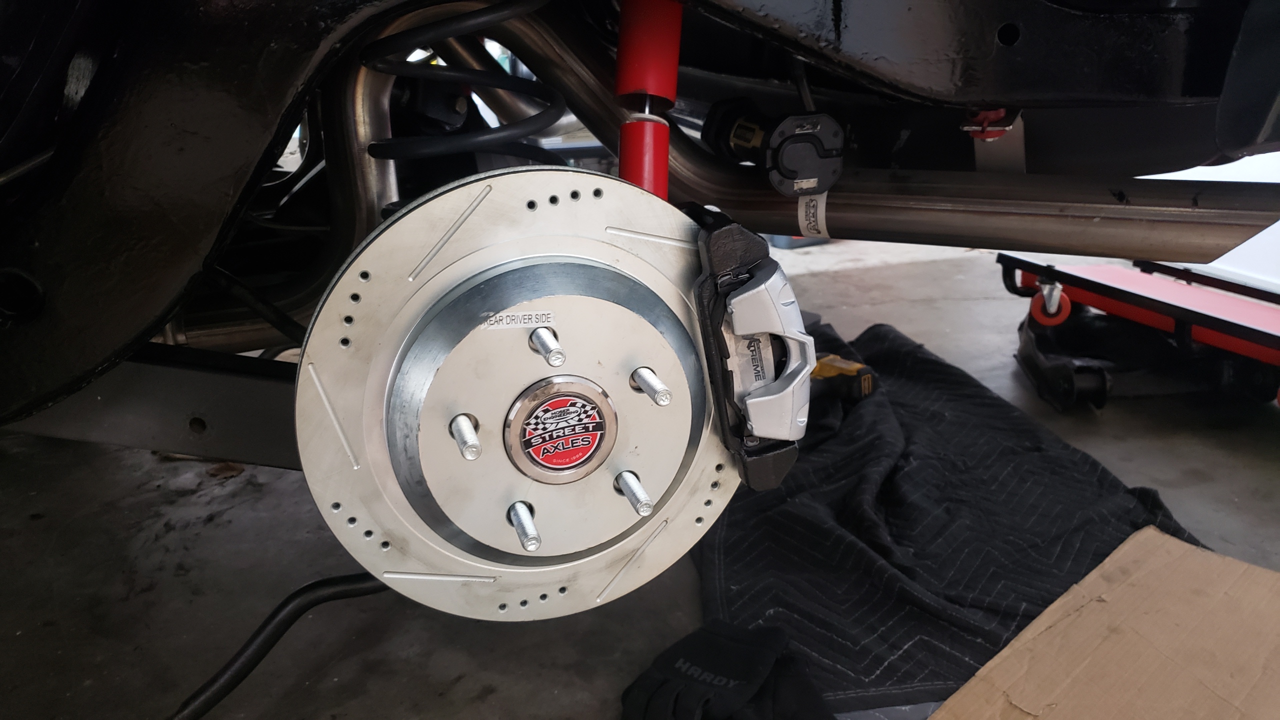

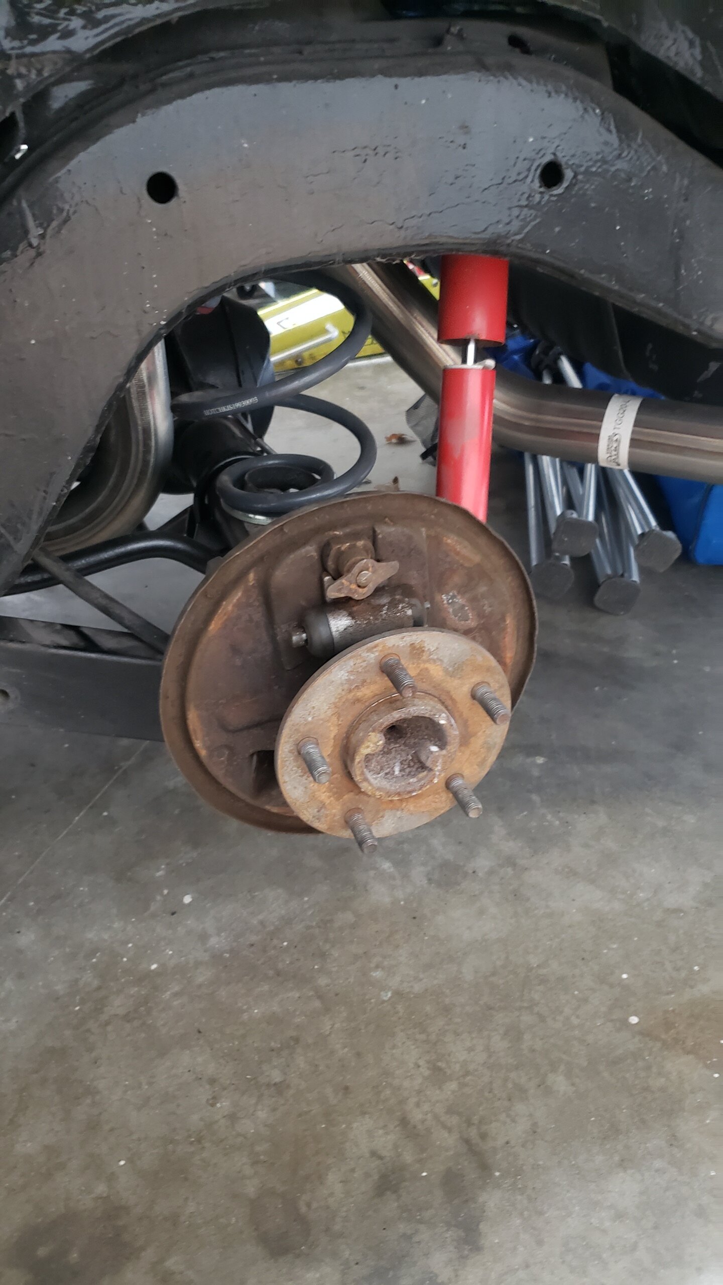

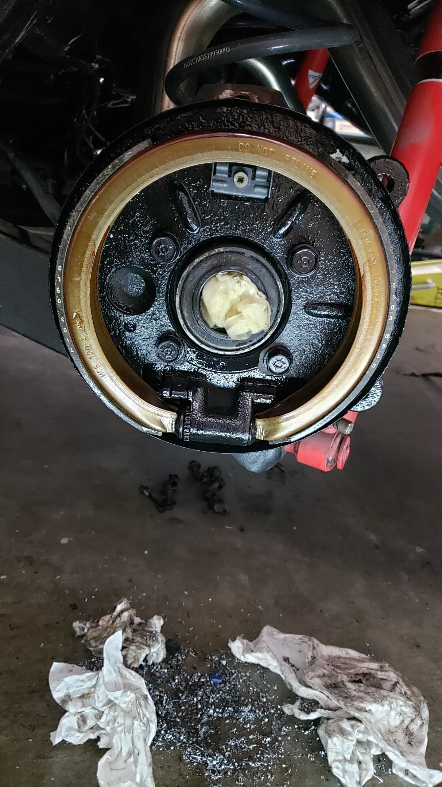

I did this swap over the winter when I had the 8.5 rebuilt. Fast forward several months now... the brakes work fantastic, but the guy who rebuilt the rear got the pattern too tight I think. It whines at highway speed, goes away with foot out of it. Few install pics...View attachment 228822View attachment 228823View attachment 228824View attachment 228825
