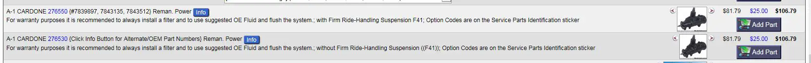

Guys, I don't mean to interfere but I think you have a bad part number posted above. Based on the RockAuto website the F41 or SS box is the 27-6550. The regular run of the mill box is the 27-6330. Take a look below. I snipped this from the RockAuto website. I was looking up for an 84 Monte SS, 305.
Reactions: gthmcty1
EDIT: I see what you are referencing, Texas82GP.. the 6530 is without sport package, 6550 is sport package. I will double check what box I actually got from NAPA.
The number I posted is the 27-6530, but I don't know the nuances. I just went in to NAPA and had them look up a Monte Carlo SS box. I can confirm later, but I'm pretty sure that is the part number I referenced.
