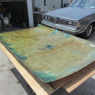

So I dragged the headliner boards and the sheet of plywood down from the attic out to the driveway. Sitting in the hot July Sun was bad so I decided to thin the resin with lacquer thinner. I kept adding small amounts until it thinned out nicely. At first it would not mix but then you felt the resin loosen up and relax. I still reduced the hardener down to 1/3 the recommended amount because of the ambient 85° heat. That worked out OK and it was pretty brush-able. One coat covered pretty good too. Once totally hard I will try for a second coat. The thinning definitely extended the cure time which is a good thing. I even held the cup of resin in the shade of my body just to keep the Sun from kicking it off too fast. IMG_0438.JPG

CK80- you were right, the second coat went on much easier and covered better. It took 16oz of resin to do a complete second coat on both boards. It has a nice smooth finish now. I will stash it in the garage to wait for better weather to try and do the cloth. MAN it is hot this year.

It looks good, Mark.
Looks like you're ready to rock n' roll. Was your rear headliner board in better shape? I found that was the case when doing mine.

Yes Jack. The rear part was way better. But still some damage from 39 years of abuse. We are having one of those hot and humid NY Summers again. YUCK!
