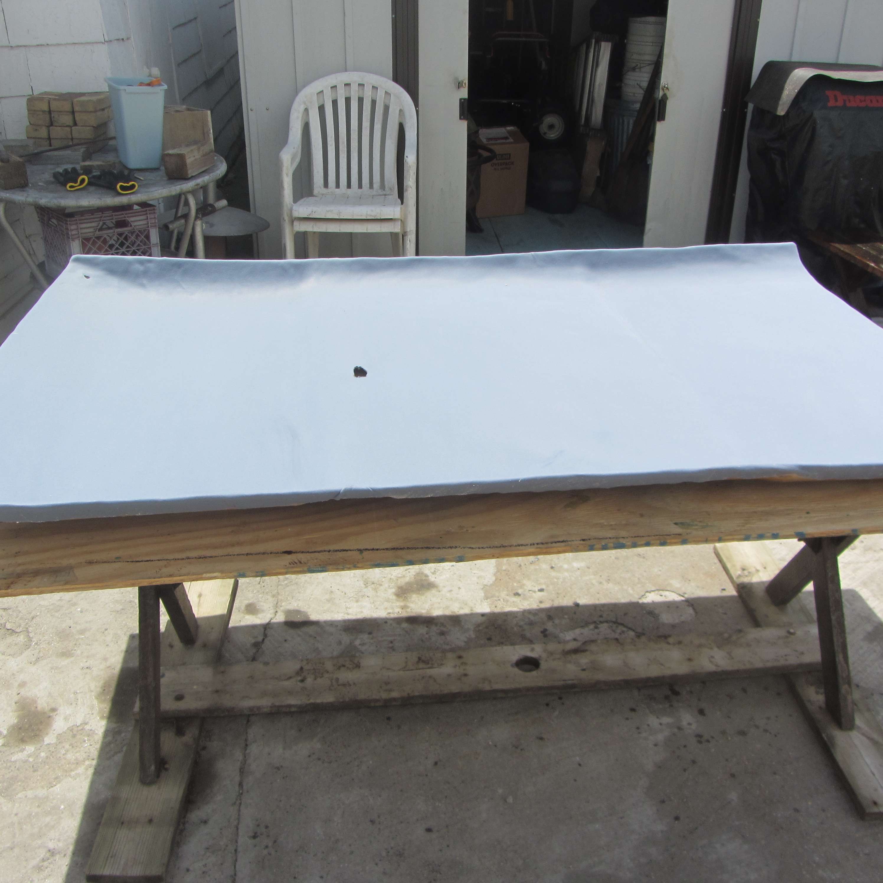

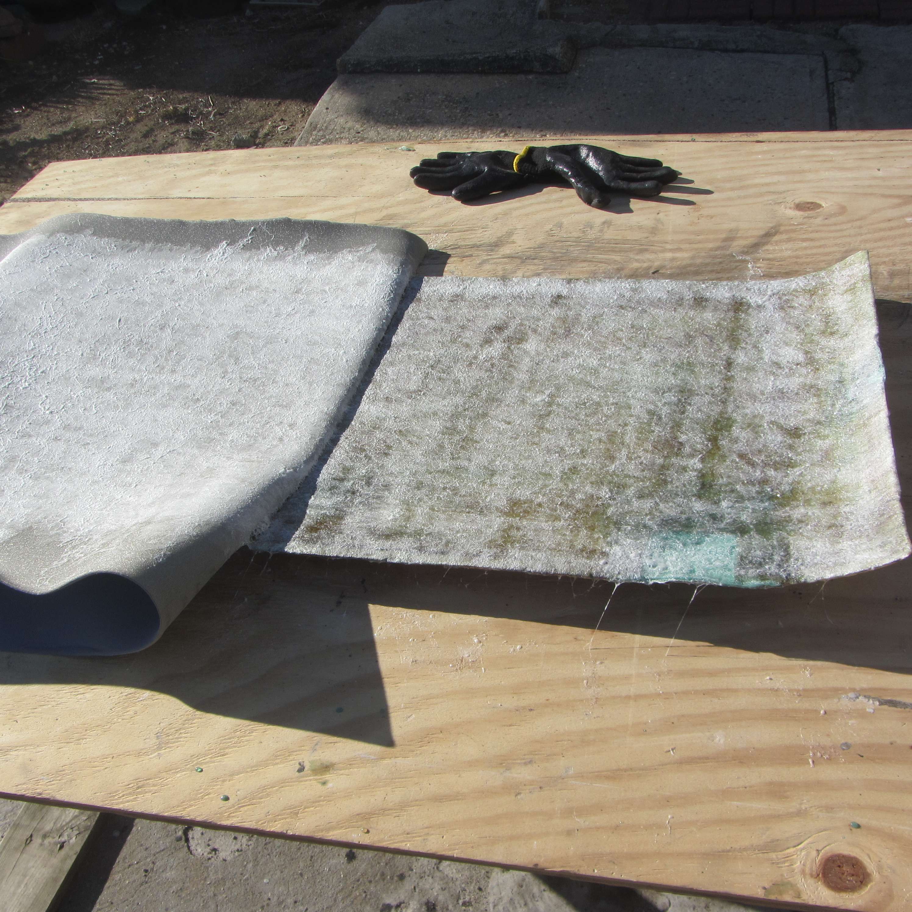

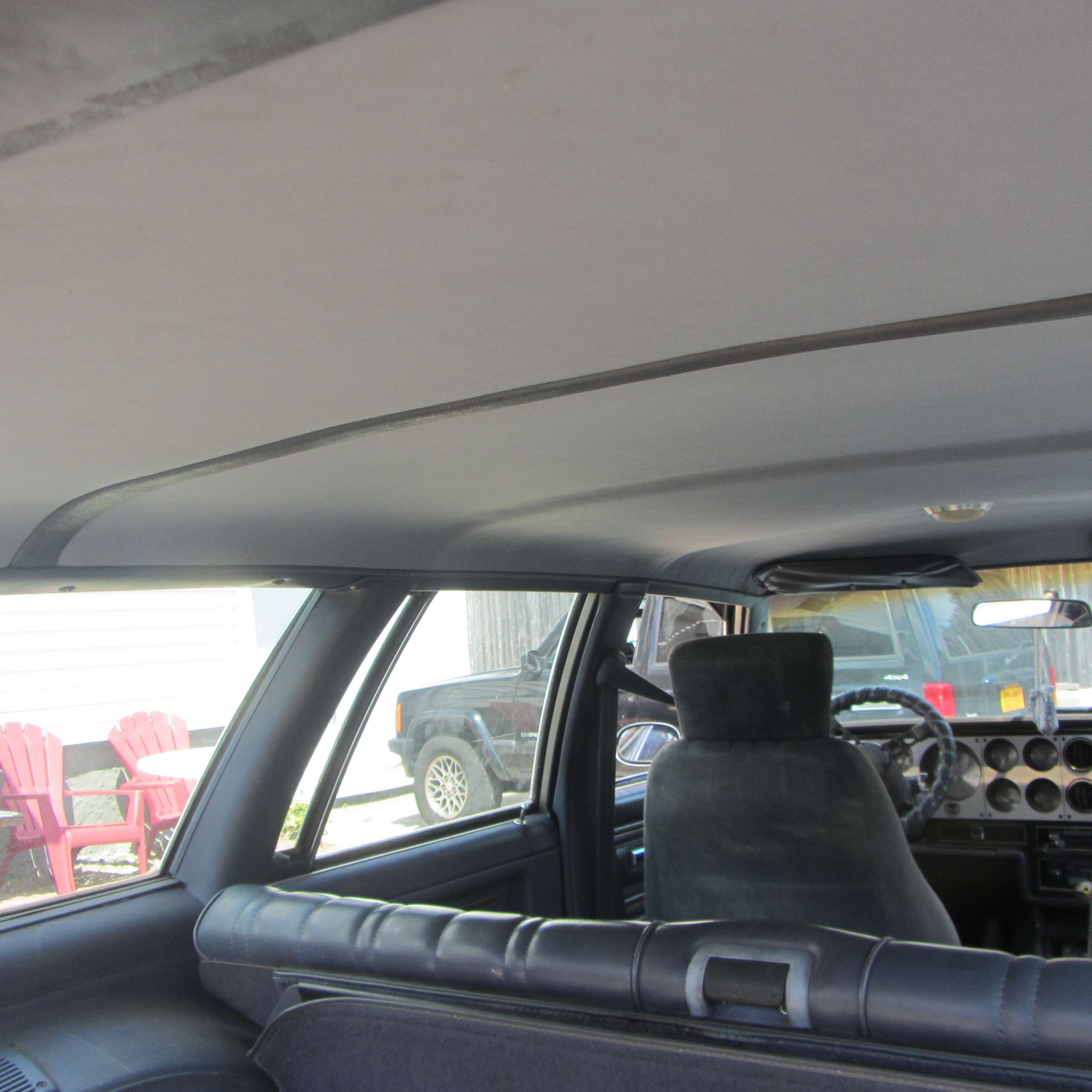

Well the oven finally shut off so I finished the job. I laid out the board on a plank of plywood and glued the cloth on a 1/3 section at a time. I used the Permatex [27828] headliner glue. The directions said to apply at least three coats but I think that is excessive. I thought two cans would do but I ended up getting a third can. By the end I found a thin first coat then a thick second coat worked better. If I did that first then two cans would have been enough. Just be sure to get real good coverage. My "helper" managed to get a couple of wrinkles in it too so be careful who you draft for this job. It went back up on the roof OK but of course the clips and moldings fought me all the way. TIP: begin reinstalling the moldings from the FRONT and work your way back. As hard as the plastic clips are to find it took me a while to locate some 1/8" push nuts for the roof courtesy lamp. Dorman makes an assortment kit [13441] but only the store that the interwebs said didn't have it- had it. Another tip is to locate the holes for the sunvisors and coat hangers FIRST or you will be stuck later. I screwed up and now I can't find the coat hanger holes. I also used some flat head screws instead of the rear molding plastic clips as mine all broke. Otherwise it is all done and man am I glad. Nothing worse than a drooping headliner. IMG_0445.JPGIMG_0446.JPGIMG_0450.JPG
Well the oven finally shut off so I finished the job. I laid out the board on a plank of plywood and glued the cloth on a 1/3 section at a time. I used the Permatex [27828] headliner glue. The directions said to apply at least three coats but I think that is excessive. I thought two cans would do but I ended up getting a third can. By the end I found a thin first coat then a thick second coat worked better. If I did that first then two cans would have been enough. Just be sure to get real good coverage. My "helper" managed to get a couple of wrinkles in it too so be careful who you draft for this job. It went back up on the roof OK but of course the clips and moldings fought me all the way. TIP: begin reinstalling the moldings from the FRONT and work your way back. As hard as the plastic clips are to find it took me a while to locate some 1/8" push nuts for the roof courtesy lamp. Dorman makes an assortment kit [13441] but only the store that the interwebs said didn't have it- had it. Another tip is to locate the holes for the sunvisors and coat hangers FIRST or you will be stuck later. I screwed up and now I can't find the coat hanger holes. I also used some flat head screws instead of the rear molding plastic clips as mine all broke. Otherwise it is all done and man am I glad. Nothing worse than a drooping headliner. View attachment 204742View attachment 204745View attachment 204746
Looking good! If you're lucky, maybe lasts 15-20 more years as well
It looks great, Mark.
Nice job. Makes me want to do mine over again....but not looking forward to it. 🙁
Don't feel bad, I ended up not reinstalling the coat hooks. All the years I owned this car I never used the coat hooks, or hung garments.
Thanks guys. It was a lot more aggravating than I remember. Or maybe I am getting crankier in my old age. :rant:
