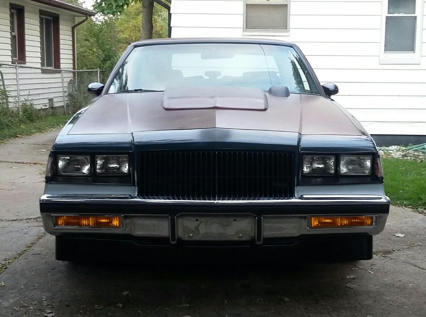

Looking to clone my regal
You will have to find an 84' and up Regal, GN or T-type header panel to look like a clone, all of these parts are available in the aftermarket but if you can get them used you will probably save money, on mine instead of painting my grill I bought a new 87' black GN grill.
Thank you for your help as well you remember the site you found the grill on and i see you got the chin spoiler in the bottom front how much does all that go for
Wow really nice work! Beautiful regal! Really inspiring as im still young tryinf to figure this out!, also a question where did you find your rims from those honey comb style?
Thanks car has been threw a lot since I got her Dec of 96
I got the wheels from FBodystore.com you have to get 4 fronts w/zero offset
Okay thank you! Yeah i had a problem with previous wheels that ended up needing spacers they went in the spacers gave over my tired flew of while test driving my car slide across the ground costing money out my pocket! Really upset about that experience but am back to where i left off hoping for no mess up so the regal im a zero offset right? And 4 front wheels? That will work (no spacers?)
If you want to have a gn without changing out alot of panels you could do an 82 GN clone, still would use the domed hood and could use the rear spoiler.
The front spoiler is from Gbodyparts.
You can pick up 16" x 8" mesh wheels from a few vendors for $719 plus you need center caps.
Okay thank you for your help!! Yeah i plan on using both and definitely the spoiler as i already drilled it into my trunk 😬
Ok sweet!, thank you for the links I appreciate your help! I been working hard to buy these parts! Im planing on buying those rims for sure! Thank you again!
Most people were not even aware of GN's pre 84' existence so when you say GN clone a black 84' and up is what will come to mind. IMO.

True but I was just letting the OP know there was an option. I'm not even bringing up T Types and WE4 packages.

Also not sure if the OP knows there was a difference in the instrument cluster and dash between 81-83 and 84-87.
