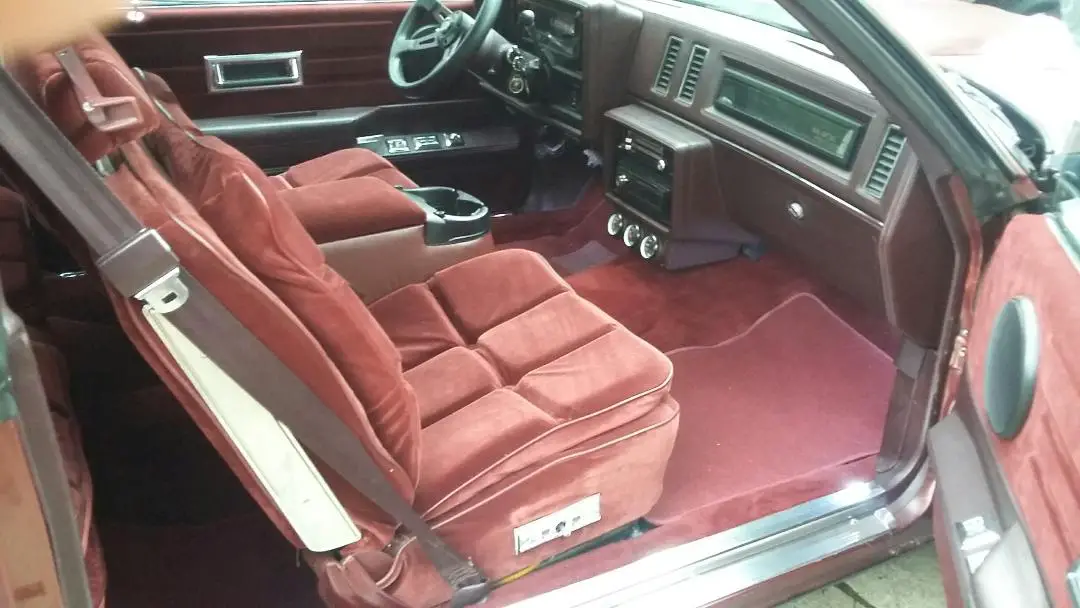

Personally I would rather make the car my own instead of making an exact clone where every part has to be correct or it's not right, on my Regal I have new burgundy interior and a SBC under the hood, it will look similar to a GN or GNX on the outside when painted but that is where the similarities end and I am fine with that.

Yes i like the ideas including yours of making it your own i think thats how its gonna be bit when i can or have the money for that small adjustment im gonna go for it! And beautiful car by the way! Great build looks amazing!
