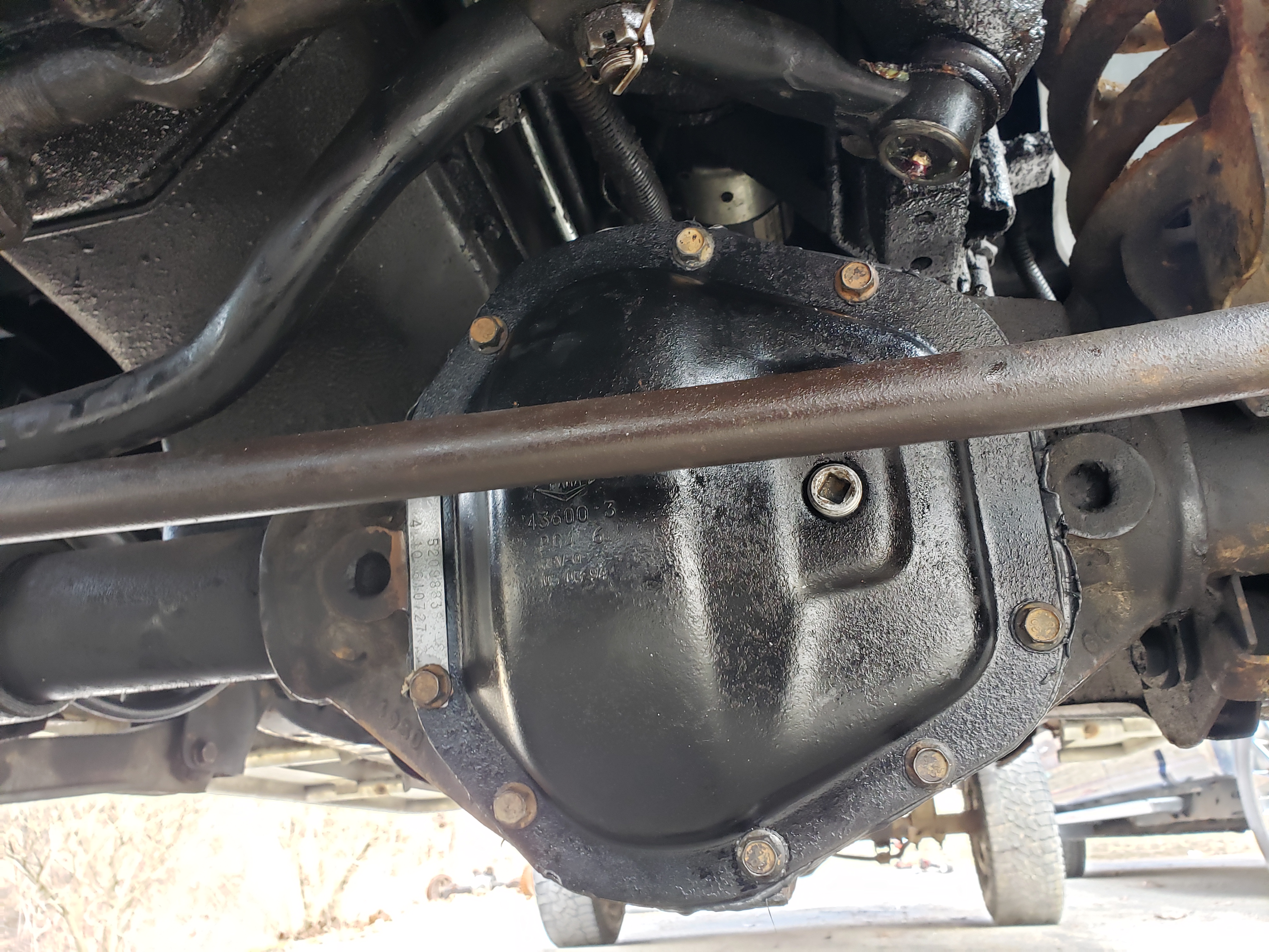

Spent today changing out the oil in the front differential. It looked normal inside. It looks like it was done before because the differential cover was RTV'd. 4.10 gears per the tag which confirms what the door tag shows. I used One Minute Gasket to seal the cover back on and filled it with conventional STP 80w90.

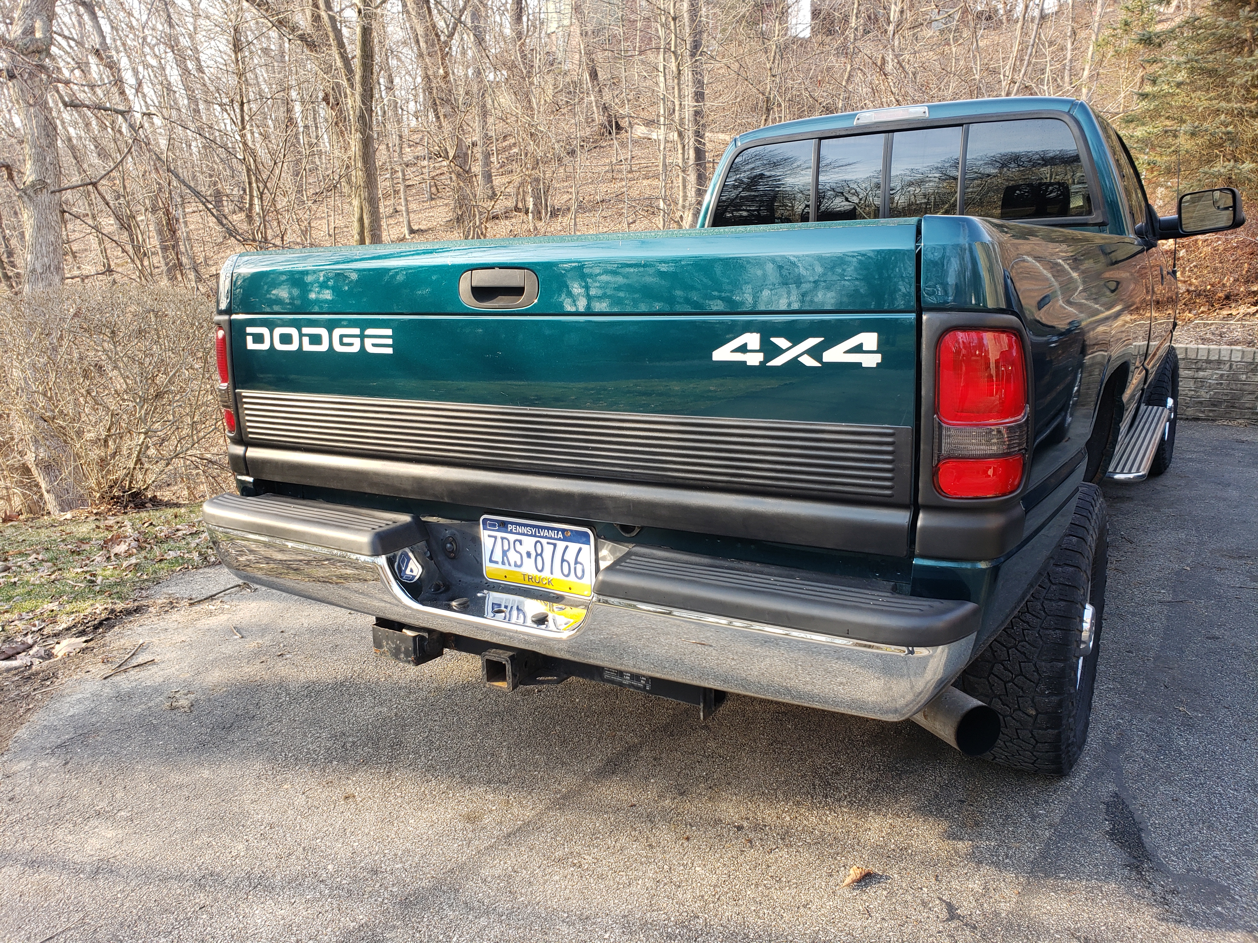

I decided that for now I'm not gonna remove the trim piece on the tailgate, but I took the heat gun and made it black again. This is the first time I've ever used a heat gun on trim but it worked well. We'll see how long it lasts.
I polished out the paint on the gate with my DA polisher and some Meguiars M105. It's not perfect but it's a big improvement and matches the rest of the truck a lot better.
View attachment 193748View attachment 193749
