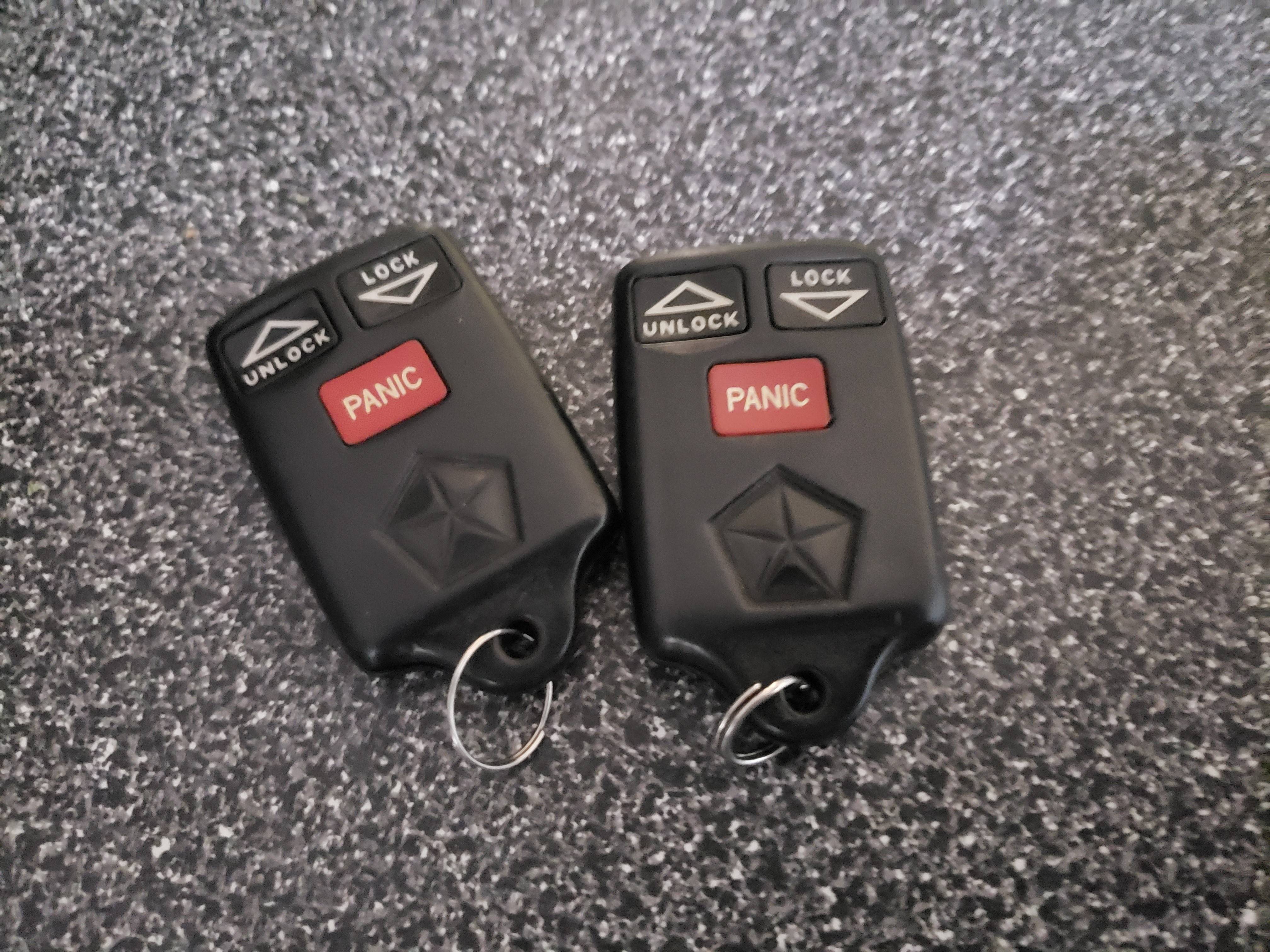

I ordered a pair of used OEM keyless remote fobs from Ebay after getting the build sheet. They cost $10 shipped. I programmed them yesterday, took less than a minute and they are working. The panic buttons don't do anything but the lock and unlock functions work.

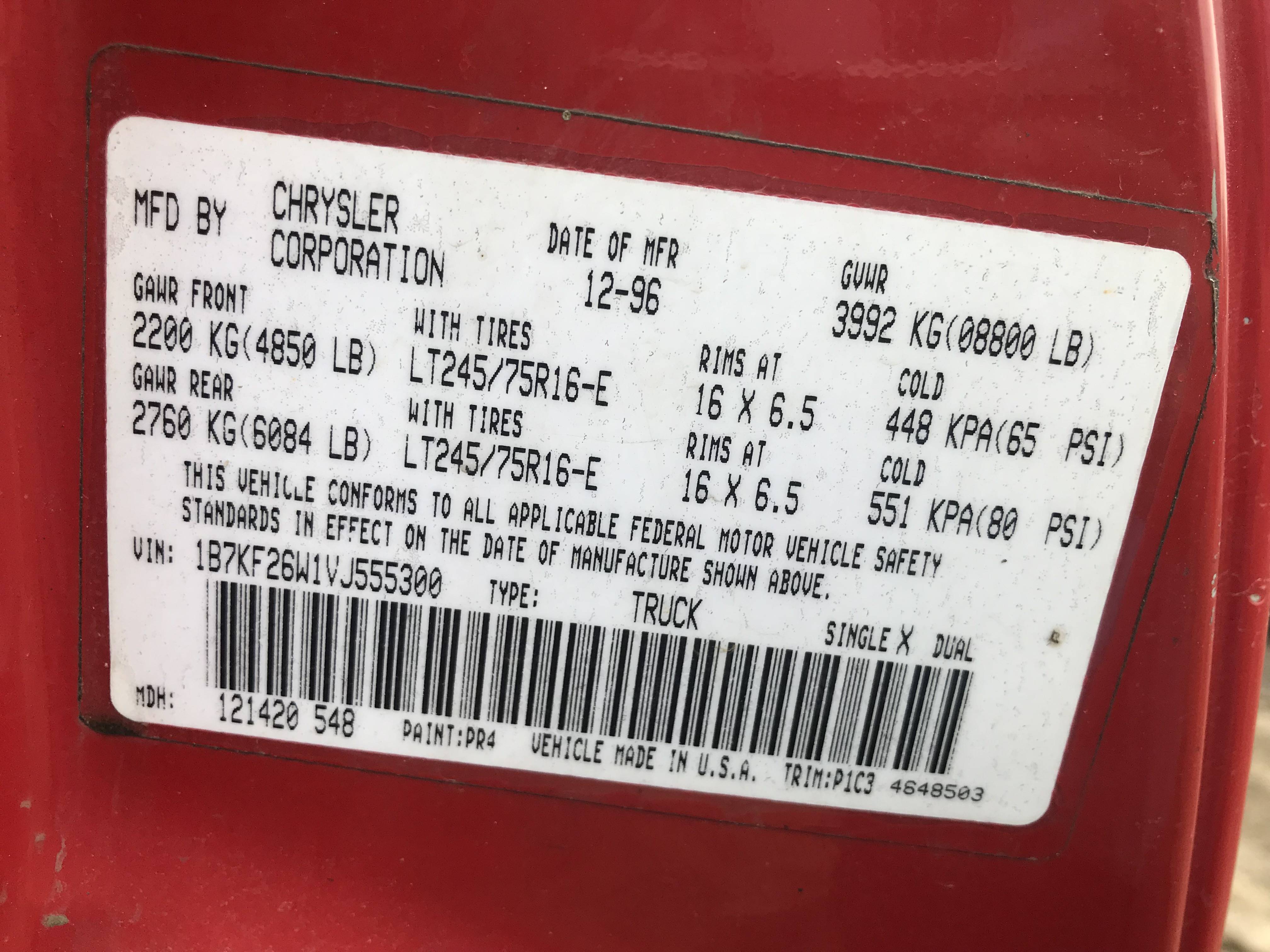

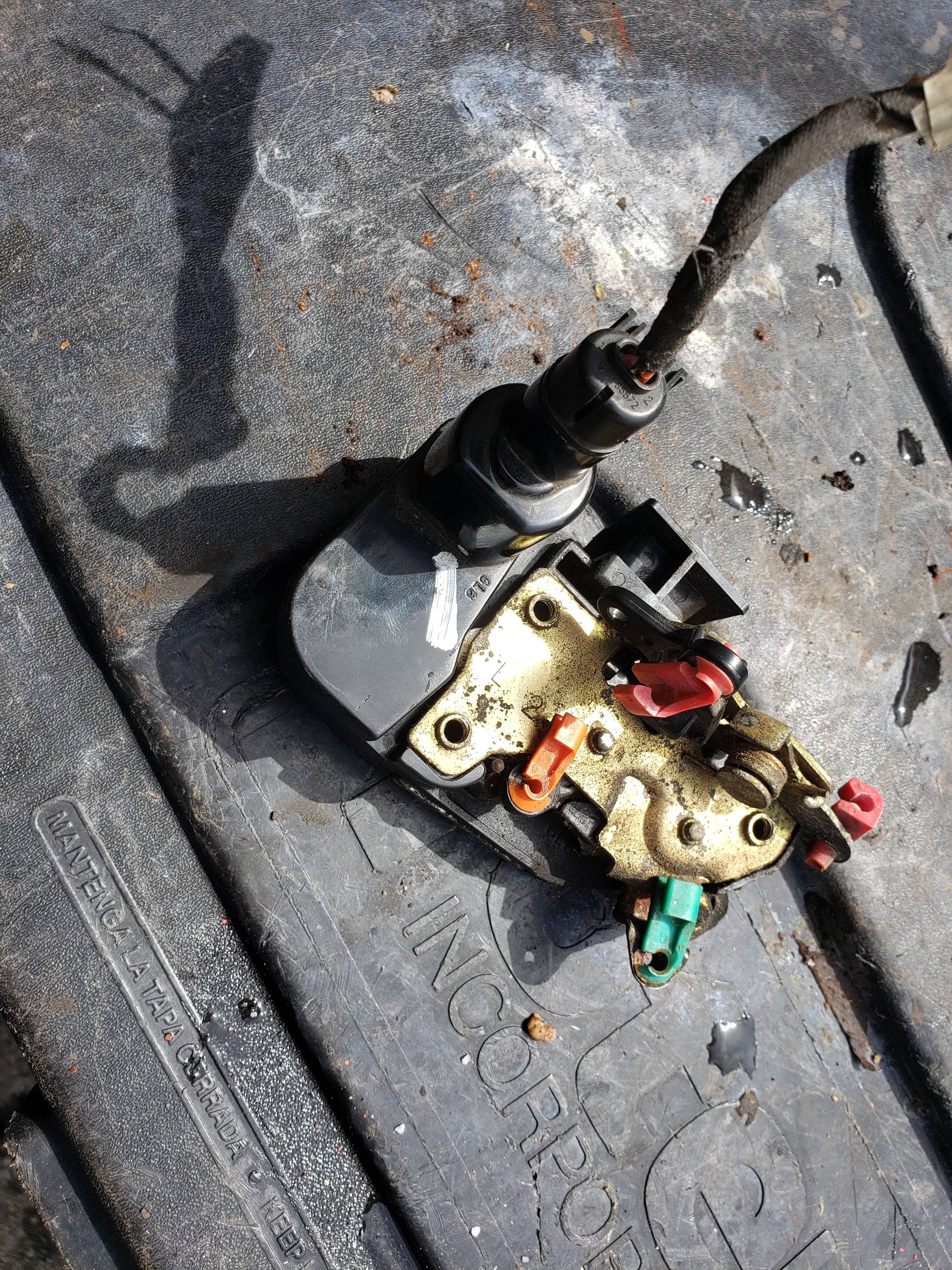

The drivers side door lock actuator hasn't worked since I've had the truck. I could hear the motor running but it won't do anything. I removed it and cut apart the casing to see if I could fix it but the gears were stripped. I checked the price on a new one from the parts store and it was $130. I thought that was utterly ridiculous so I went to the junkyard today and grabbed one for $10. I brought a 9v battery with me and tested it to make sure I got a good one.

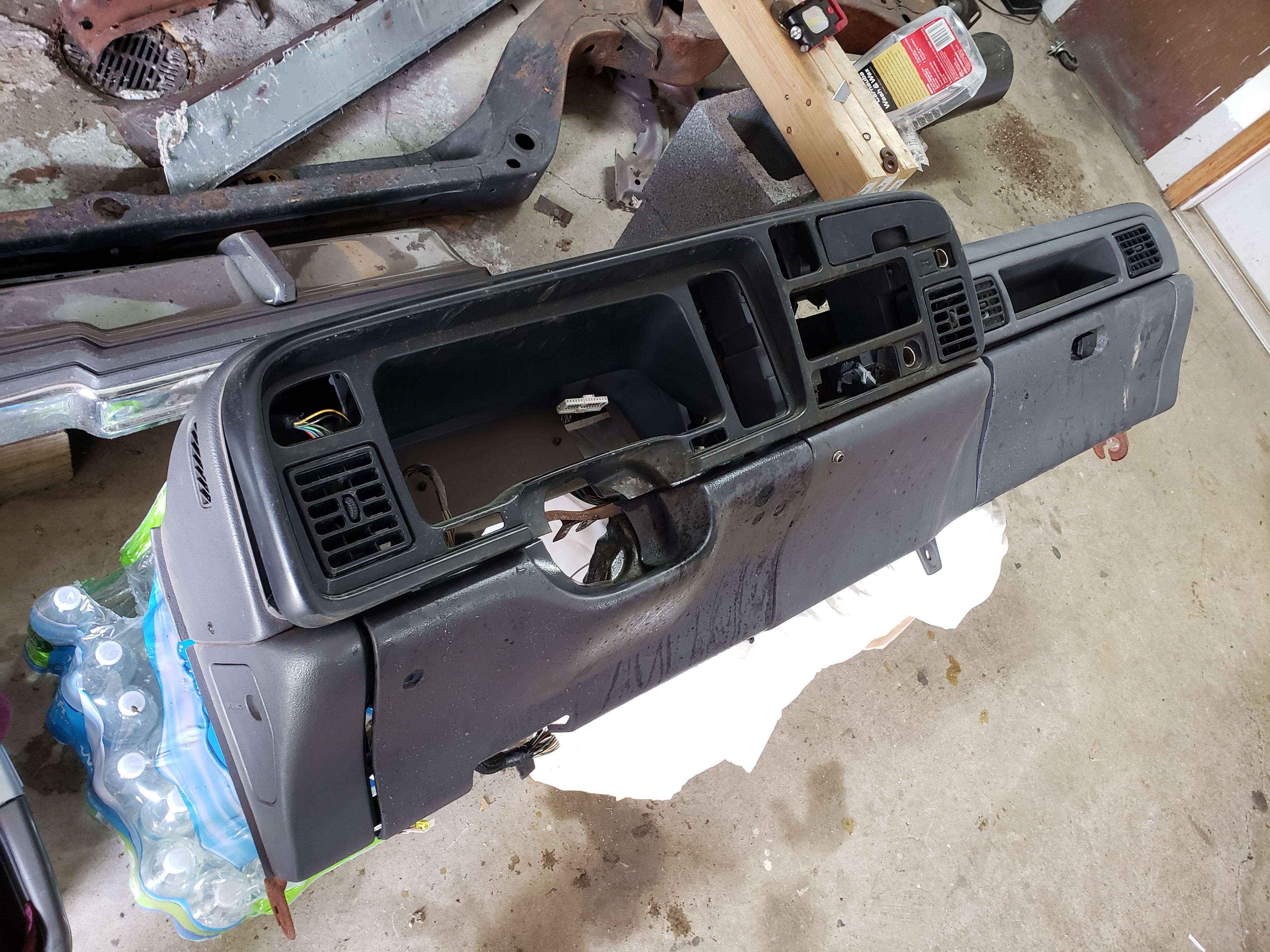

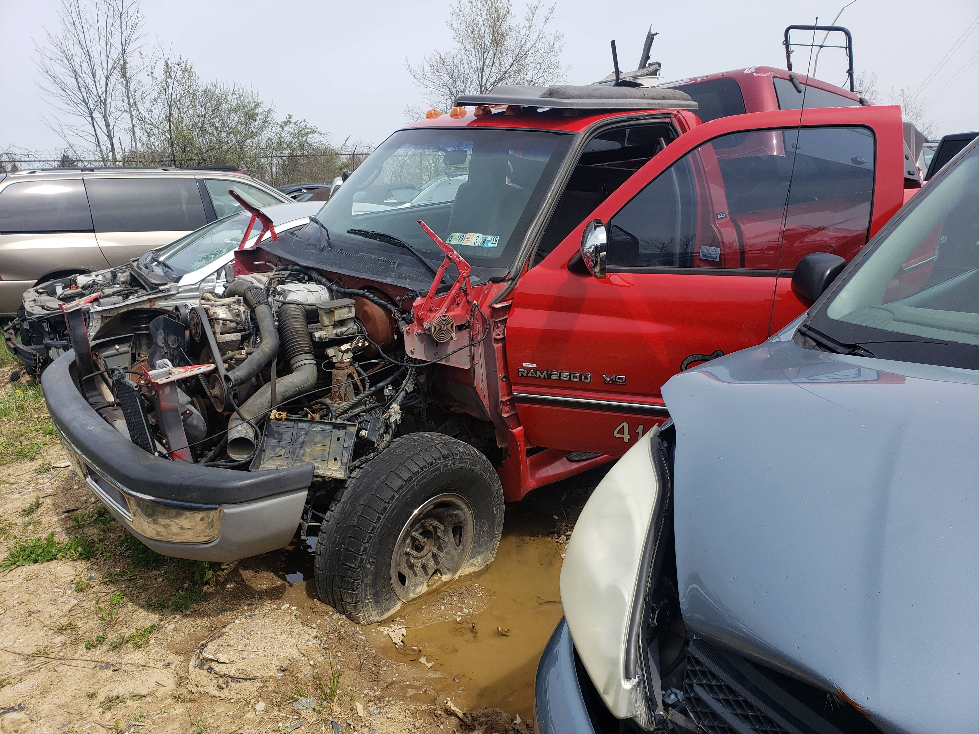

And while I was at the junkyard I found a truck that had a nice dash in it. Last time I left a good dash at the junkyard it was gone in days. So I asked for a price, they told me $150. A dash cap costs $200 so I went for it. I was super nervous pulling it and getting it to the car but I got it there in one piece.
Initially I thought it was the wrong gray, there were several different versions but upon checking the trim code, it's actually the correct Mist Gray.
It has some holes drilled in the lower parts and it's gonna need a serious decontamination/sanitizing, but it was a nice score.

Which yard & any G goodies?
