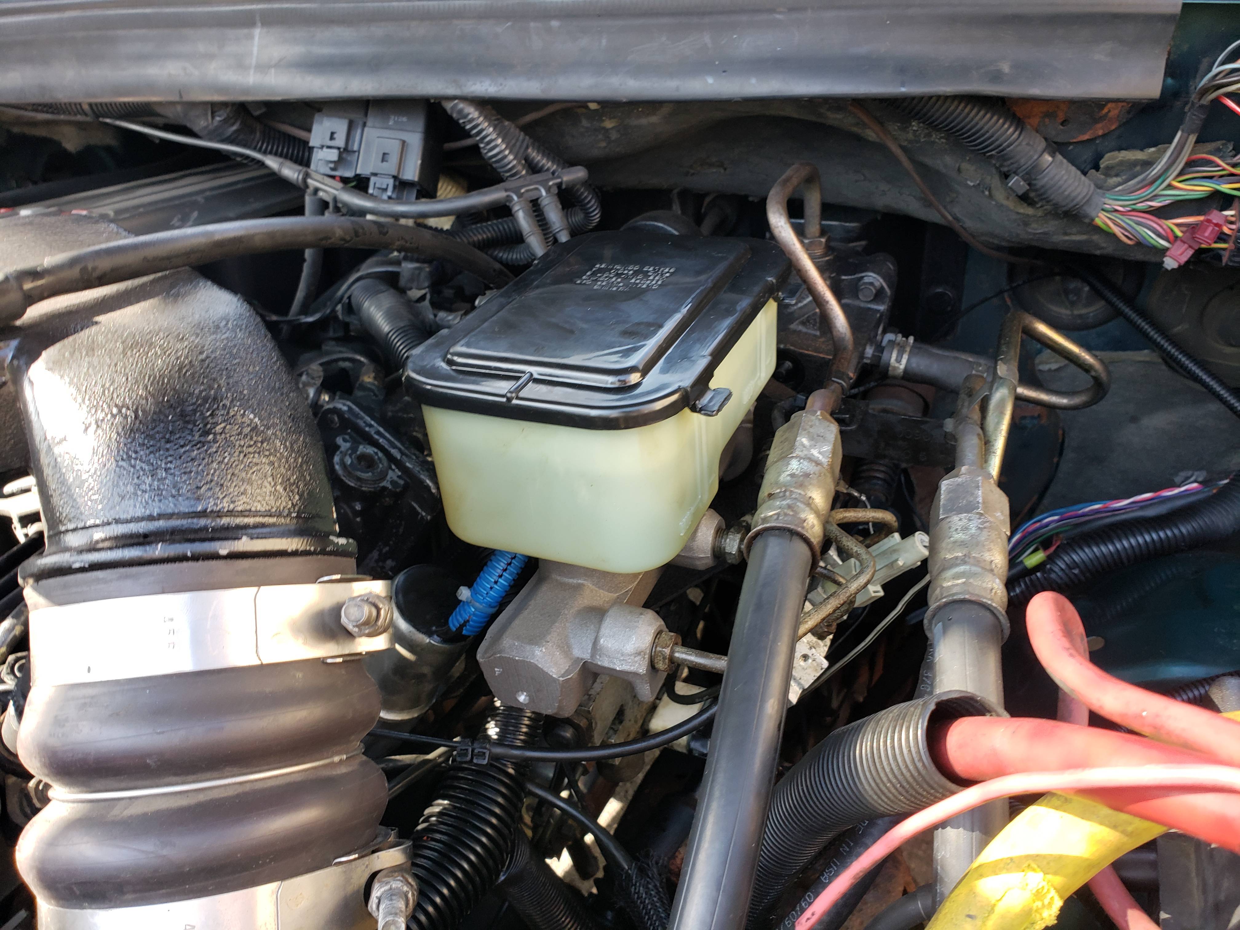

Today I replaced the master cylinder which I had suspected was bad a while ago, but I started driving the truck and never replaced it. When I was adjusting the idle last week I noticed it was wet around the reservoir seals so it was an easy decision to replace it.

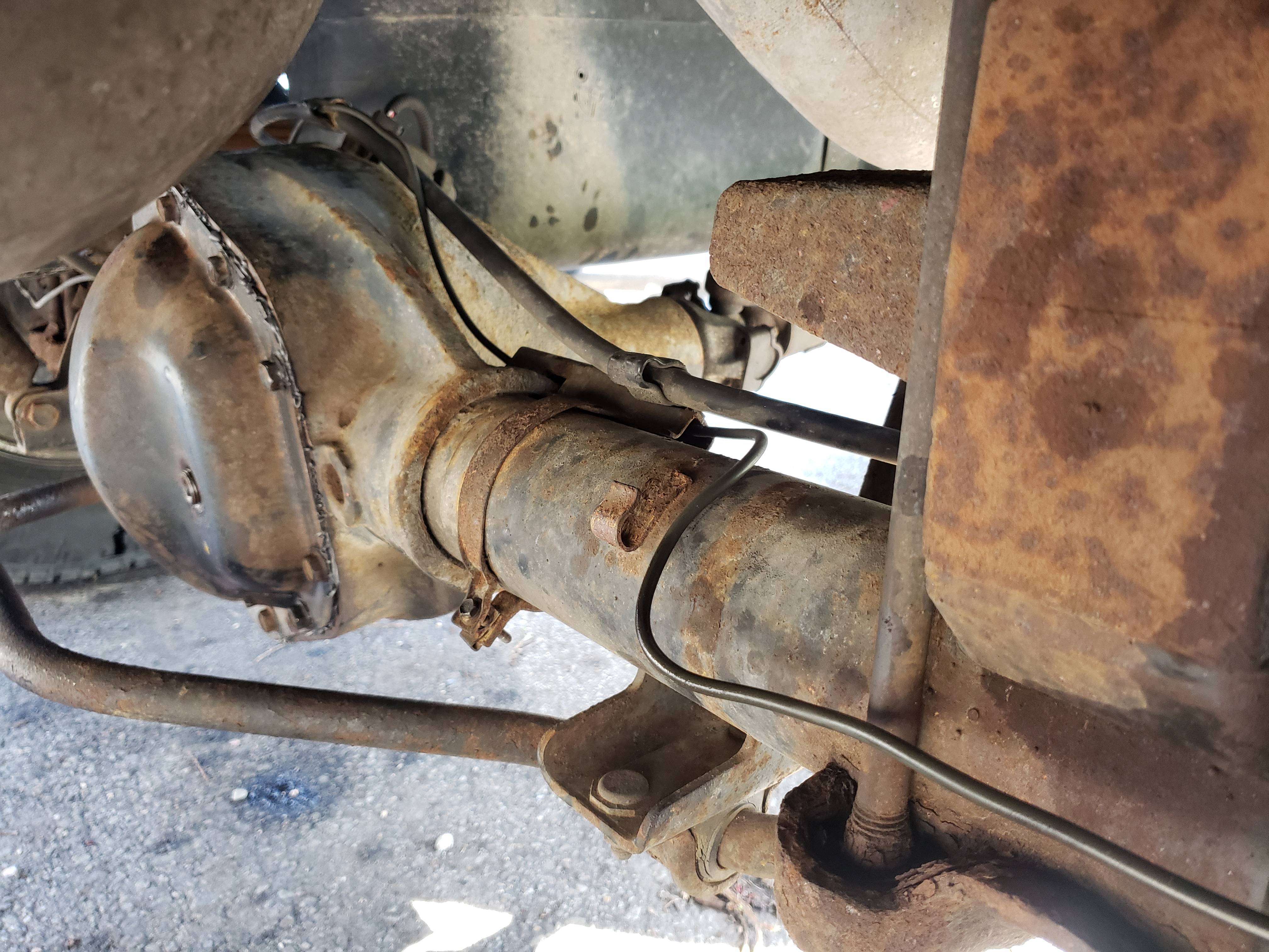

Changing the MC was easy. However bleeding the brake lines is always a pain. 3 out of 4 bleeders opened up fine. The passenger side rear snapped off...
Which then lead to replacing the wheel cylinder...
Which then lead to the brake line being disturbed and leaking...
So I wound up making a brake line from the wheel cylinder to the rear axle junction block. Once that was done I bled the brakes. Its hard for me to tell if there is still some air in the lines, or if the pedal just requires less effort because the old master cylinder was junk. I can stop fine but the pedal feels different. I may try to bleed some more out tomorrow.
