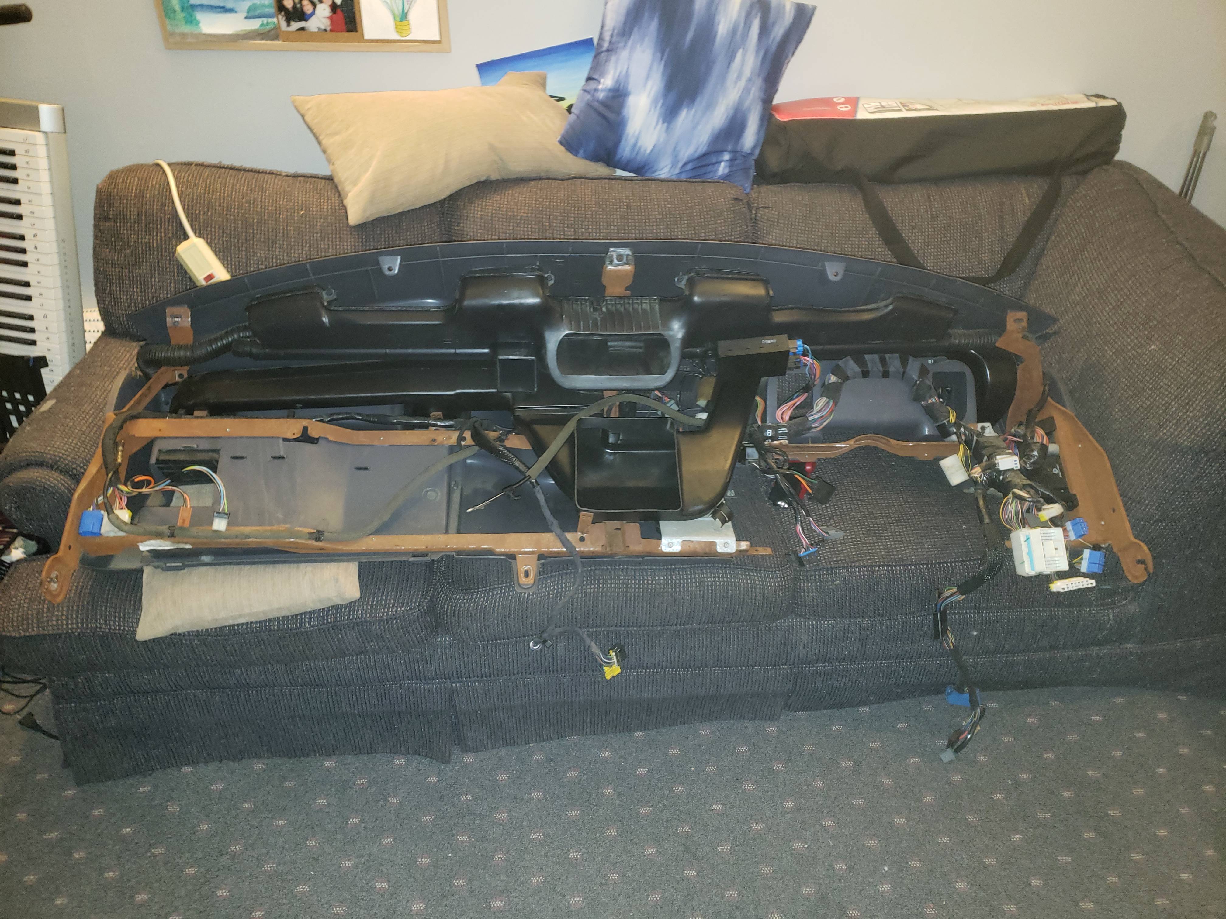

Got my old dash removed, pulled the wiring harness out of it, carefully removed the harness from the new dash and installed my harness into the old dash. Wasnt hard, took a couple hours and had to be careful. No hidden fasteners or anything.
New dash ready to go.

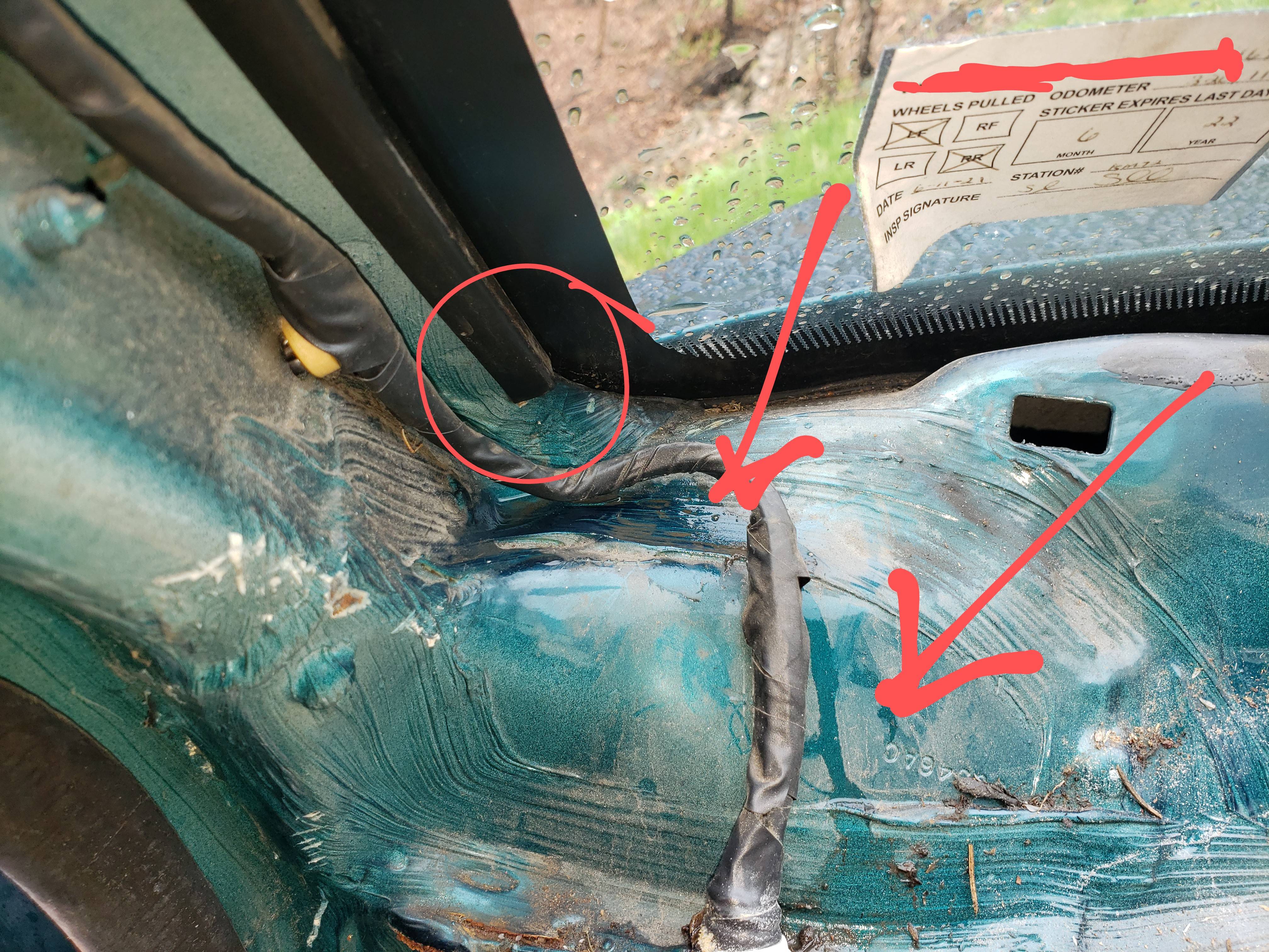

It's been raining on and off today and with the dash out, I found the source of my water leak. Turns out the windshield is leaking. Of course it couldn't just be something easy. So I'll be in contact with my glass guy.
View attachment 197594View attachment 197595

Yeah, I almost missed it. Just barely saw the puddle in the corner of the windshield. I just hate doing windshields. Always feels like opening a can of worms. Rather, chasing water leaks is opening a can of worms. I went through this whole mess with my old F-150. Fortunately the Dodge has a much better, simpler cowl and firewall design.

Not eager to deal with any of them, I decided to take a closer look at the leak myself. I soaked the area with soapy water and used the air gun to blow from the inside. I didn't see any super obvious leaks around the windshield itself, but I found a hole behind the metal rail that holds the weatherstripping that wasn't sealed and would've allowed water through. I used some Permatex Windshield and Glass flowing silicone around that hole and I put some around the seam in the windshield frame for good measure. After letting it dry for a couple hours I sprayed it down with a hose for about 5 minutes and the leak seems to have stopped. I'm cautiously optimistic. Its supposed to rain tomorrow, we'll see what happens.
