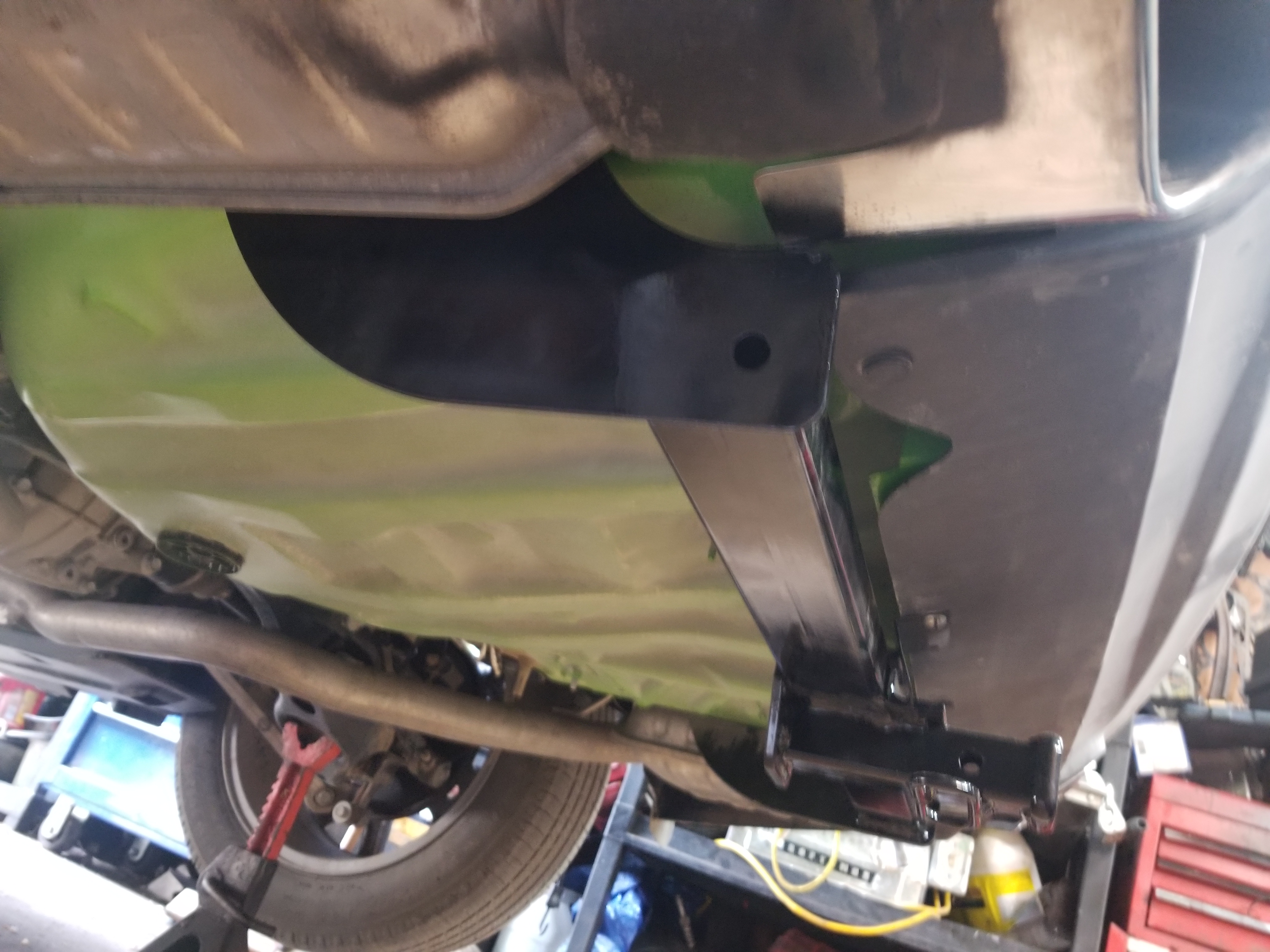

I backed it up beside the Dakota with the boat on. The Dakota's hitch is 13" off the ground. The Challenger is 8 3/4", I figure a 4" 1 1/4" rise hitch should put it about perfect. I will pick one up tonight and do a test hook up on the Challenger.

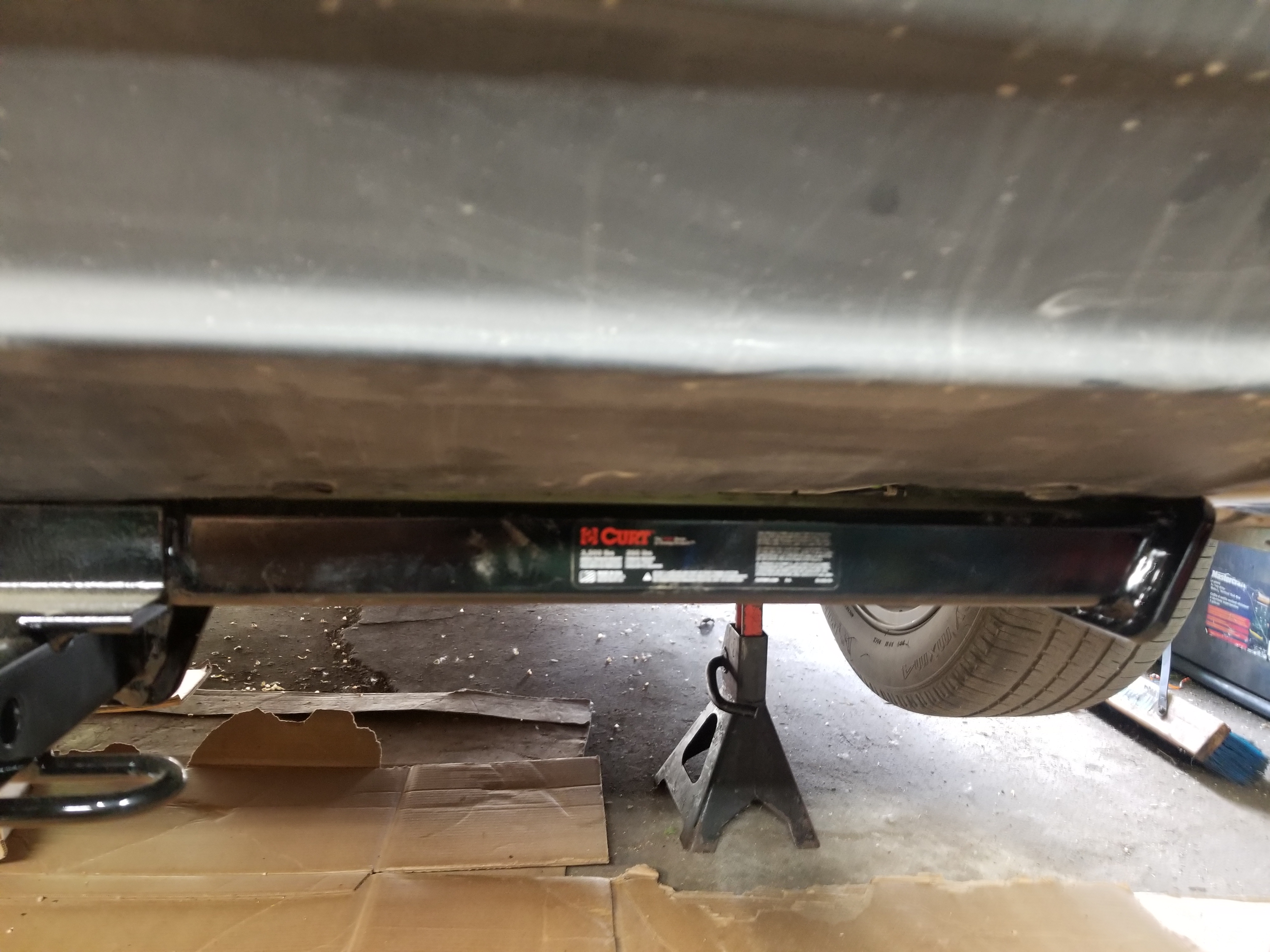

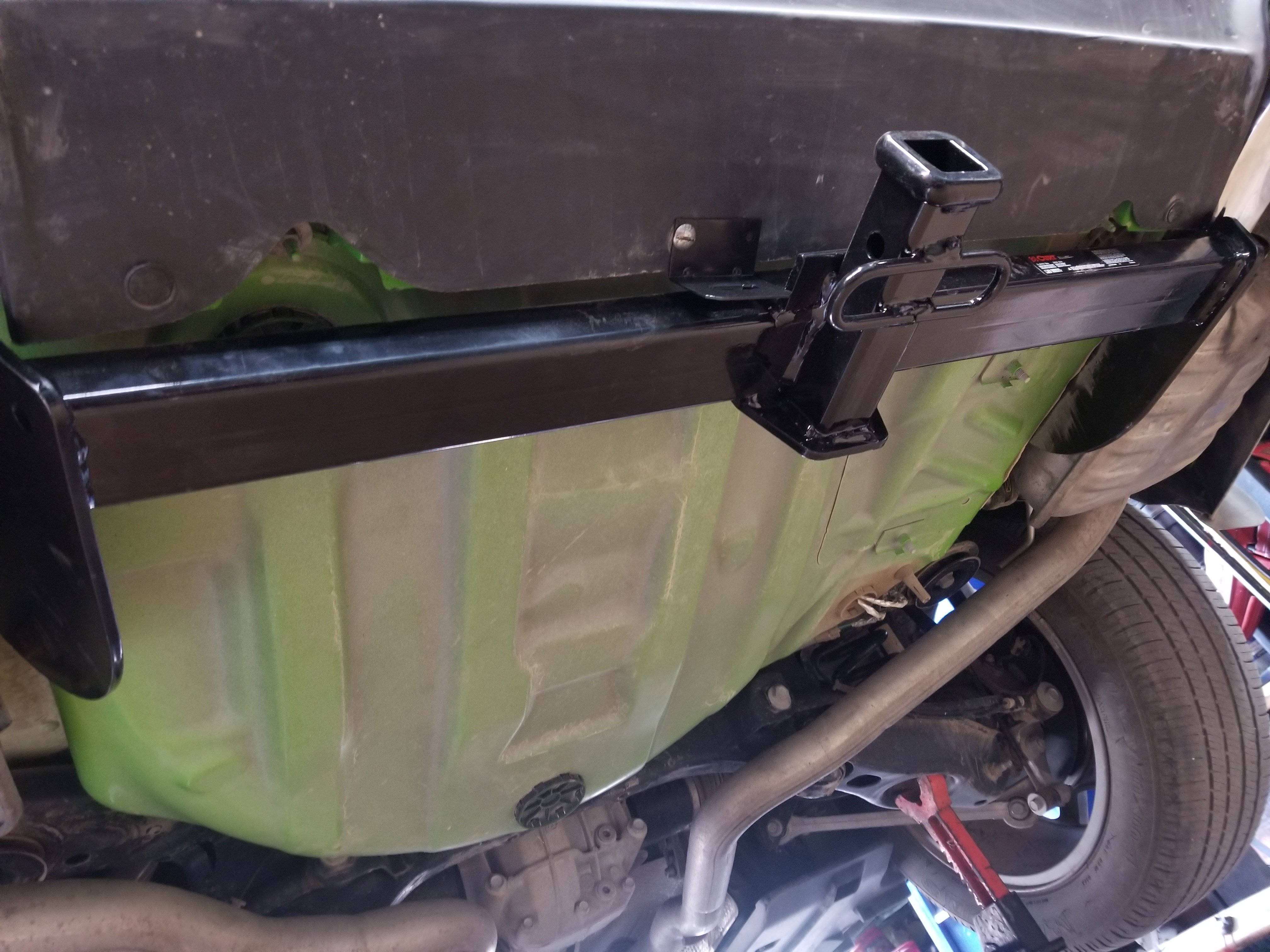

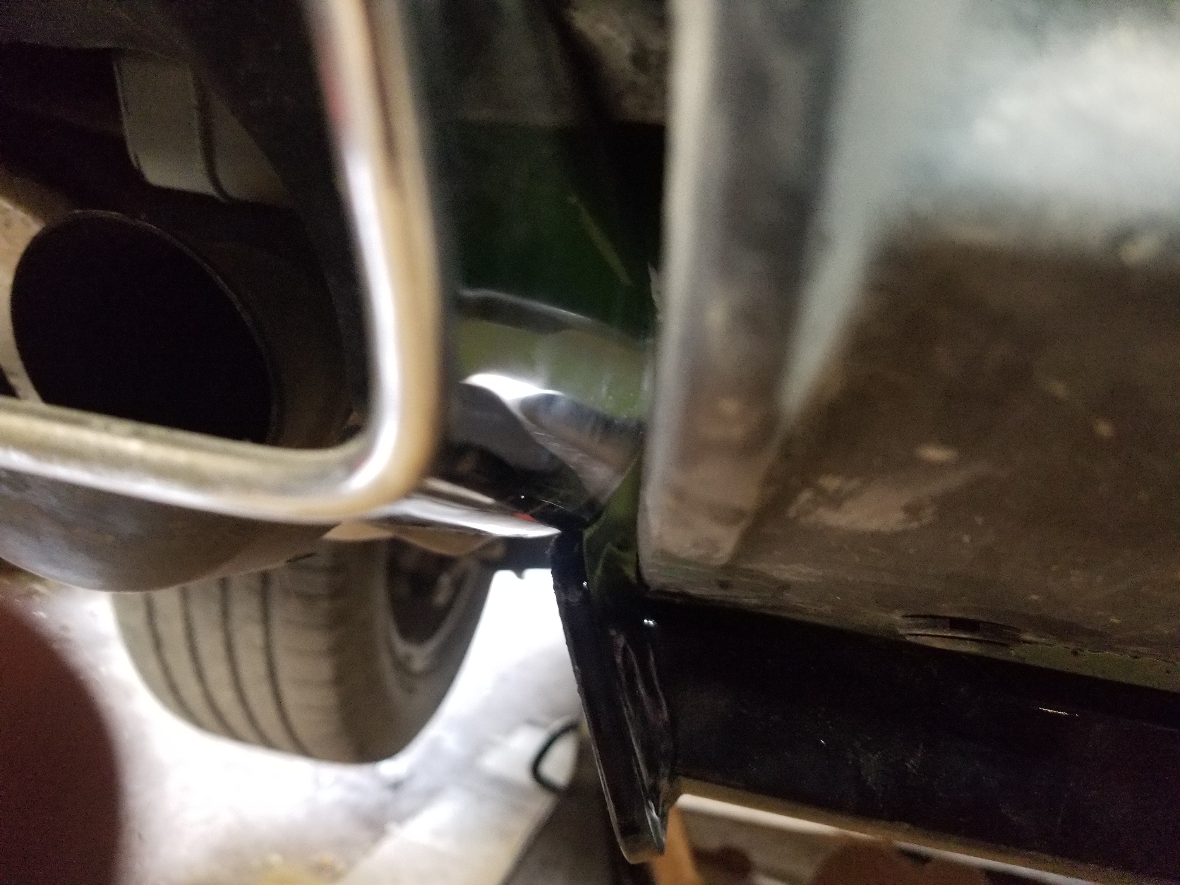

Got the 4" rise hitch, maybe just slightly higher then the Dakota. Should work quite well, long enough to clear the bumper, even at 90 degrees. Getting the Curt 56230 wiring harness has been a PIA. It has been sitting ordered on Amazon for weeks, supposedly they had two in stock when I ordered it.
