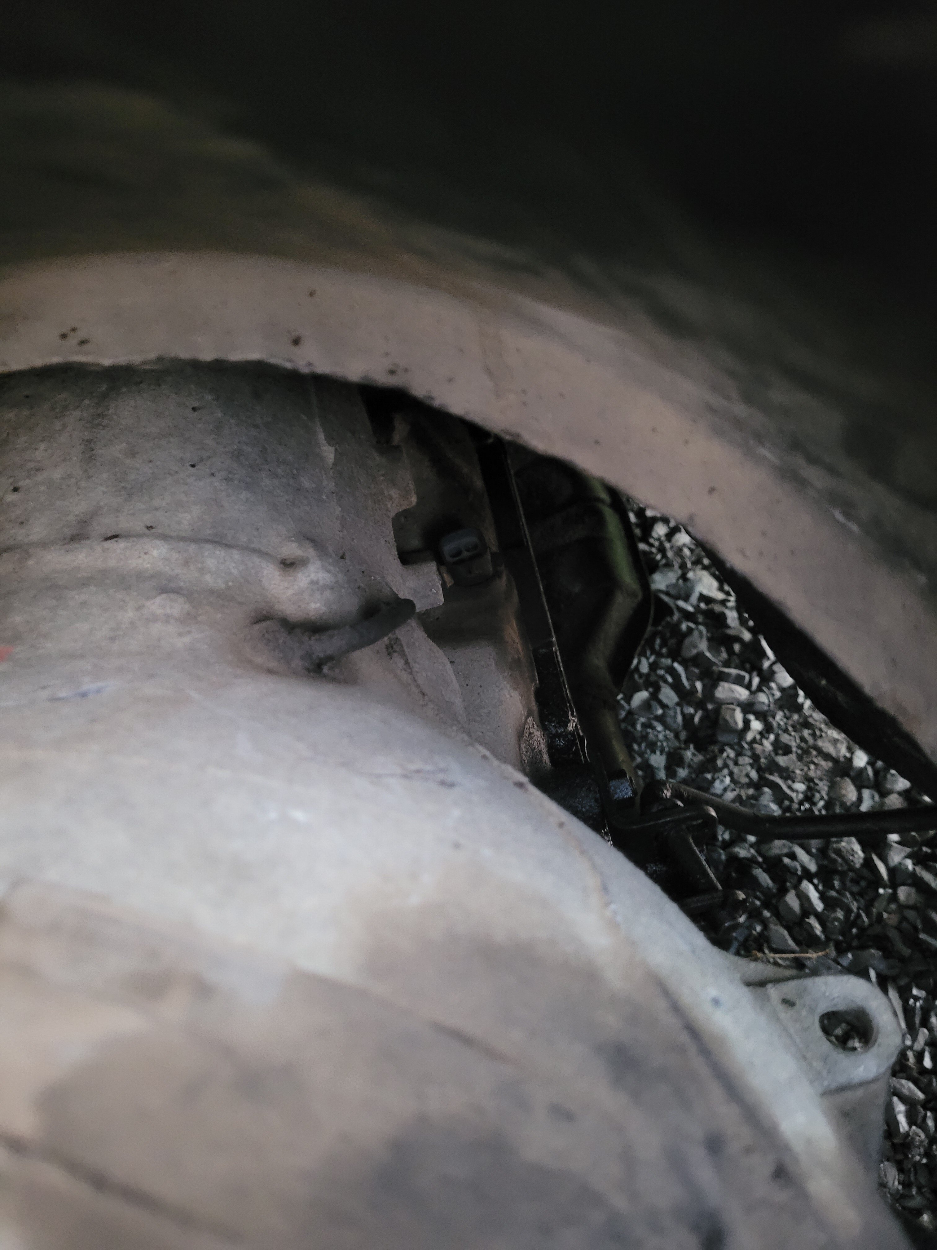

some pics of the trans. unsure of the year, it has a plug that has nothing connected to it. says Buick on it lol.
Really just for documentation. trans gives me no issues, shifted smooth and only leaks a little bit. i'll replace it eventually but not now.
got a flexplate for this year to be safe. picking it up tomorrow. gonna try and have a bow on this (get it) by the end of the month..
Either a TH250C or a TH350C. If there is a stud and nut for band adjustment by the cooler lines, it is the weaker TH250C. In good condition, it will live many miles behind a 305.
