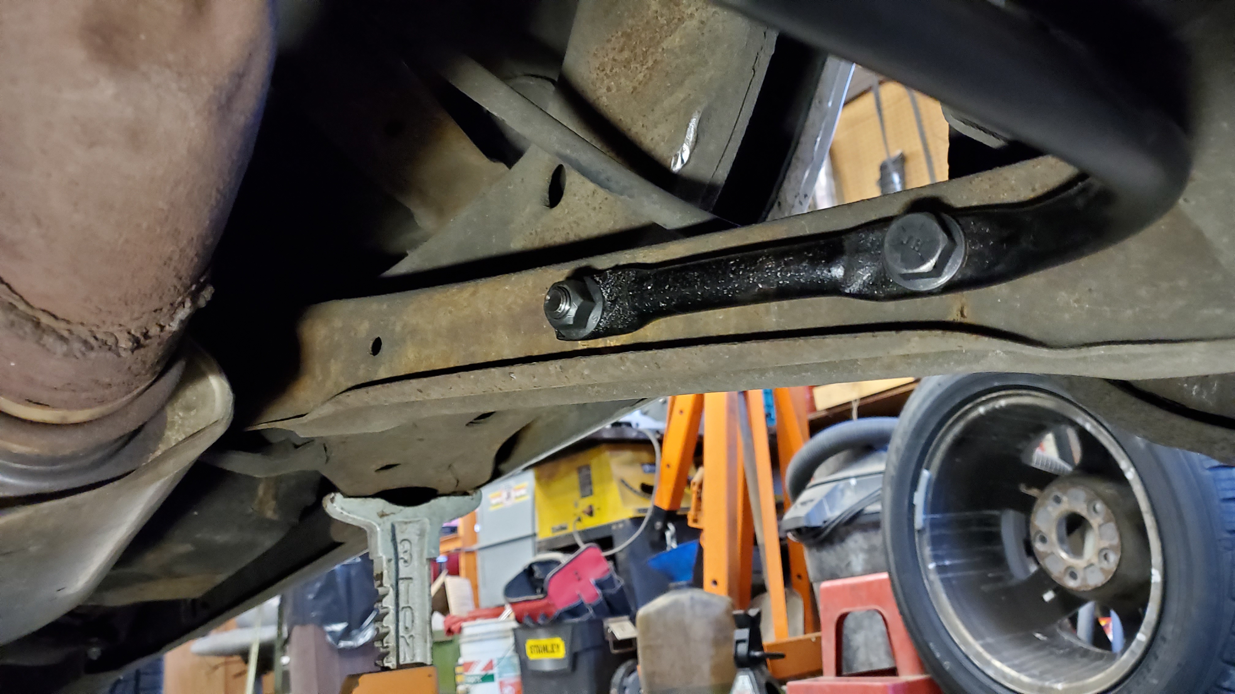

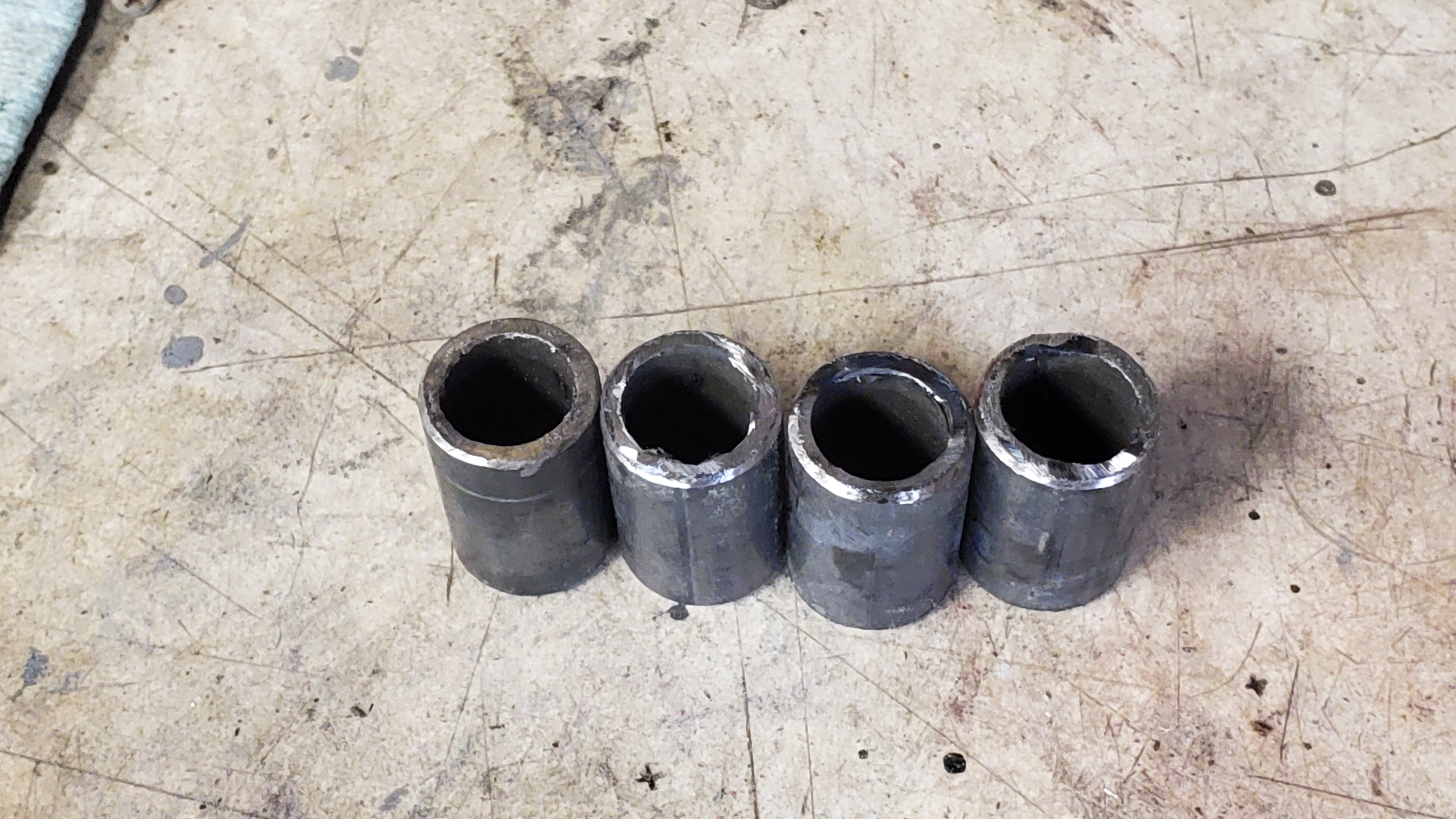

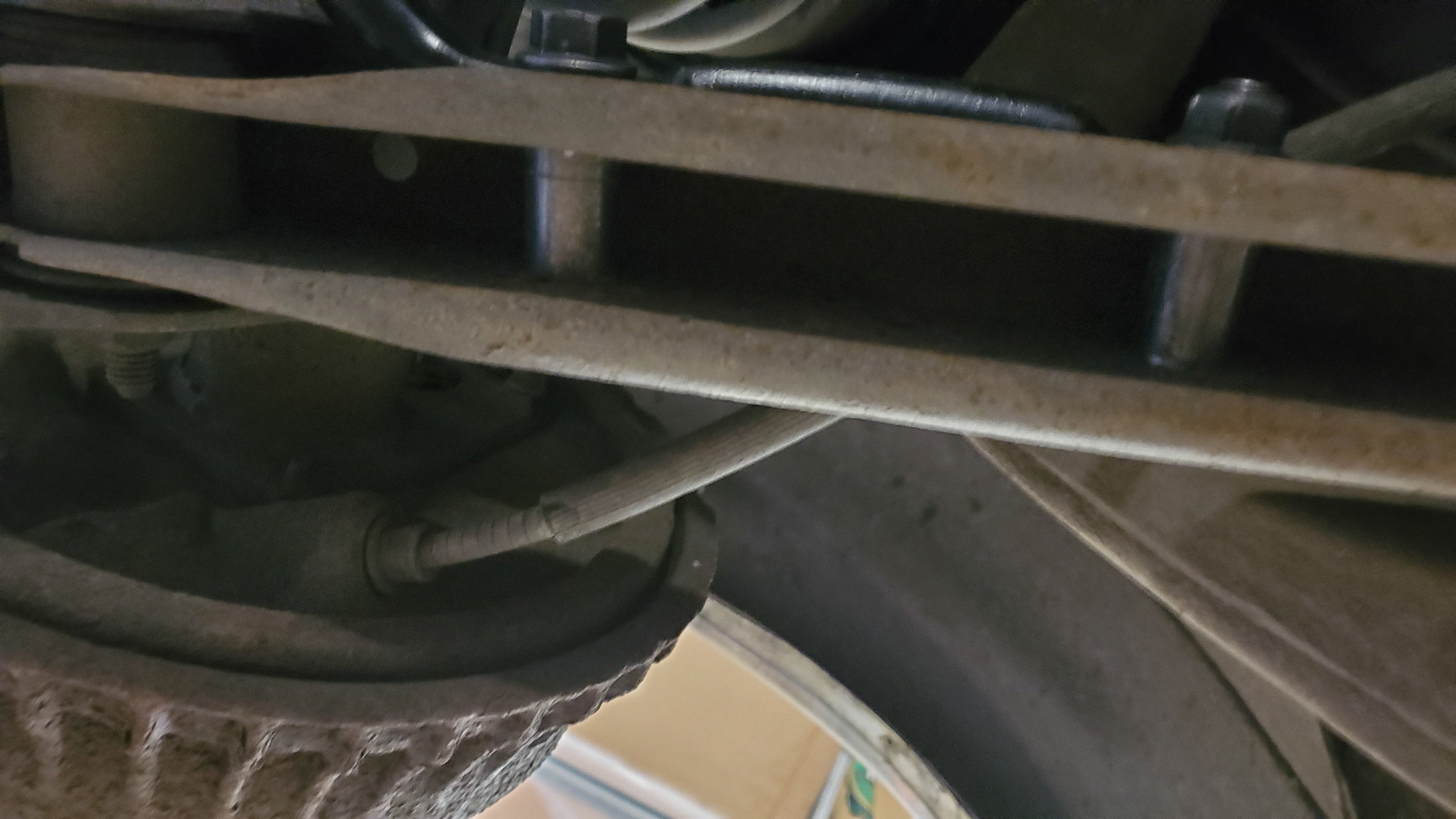

What’s with the bolts one facing in the other out something obstructing installation or was that the easiest route my stock SS face inwardFinally got around to installing the F41 rear bar I picked up from member Doug Chahoy a while back. Grabbed some 1/2" grade 8 flange hardware and a black pipe nipple from de sto yesterday. Crew cabs don't have the inner support for sway bar bolts, so I cut spacers from the black pipe to keep the control arms from collapsing.

10-4 I’m going to por15 my barr tonight after I mock it up ck fitmentI just couldn't get the holes to line up. I'm a hack!!!![]()

Years back when there was a place called Builders Square I picked up some hinge plates & made them into the inserts for my sway bar. I'll have to dig them out so I can make some new ones.Finally got around to installing the F41 rear bar I picked up from member Doug Chahoy a while back. Grabbed some 1/2" grade 8 flange hardware and a black pipe nipple from de sto yesterday. Crew cabs don't have the inner support for sway bar bolts if it didn't come with one, so I cut spacers from the black pipe to keep the control arms from collapsing.
