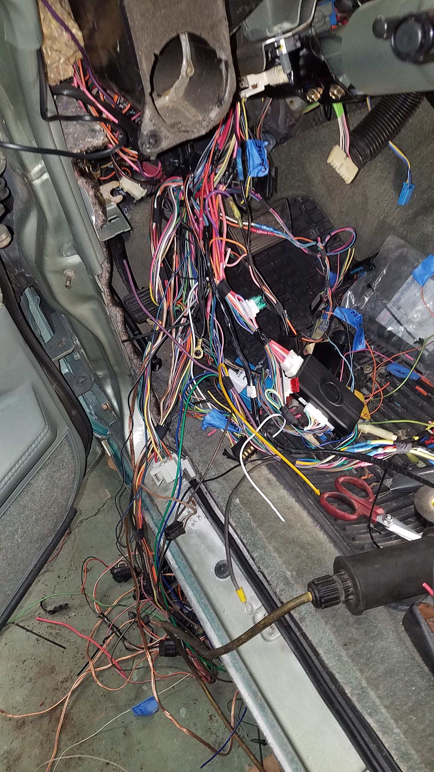

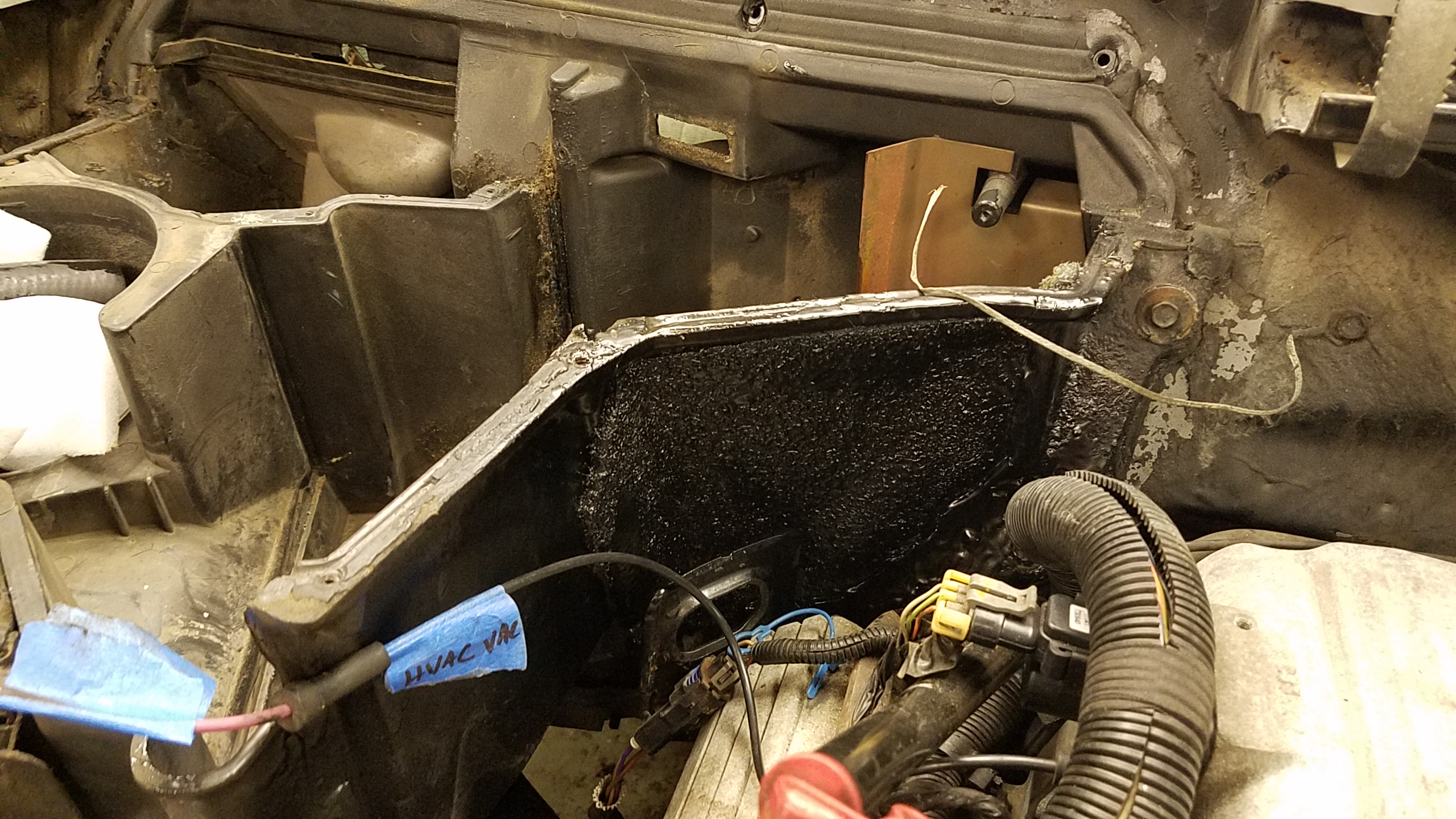

In other news: I got the through firewall wiring in, cut out the OBD 1 wires, started looming the new stuff in, so I can run the fuel pump, trunk release, and fuel sender to the back. Also, V2 of heaterbox repair......
