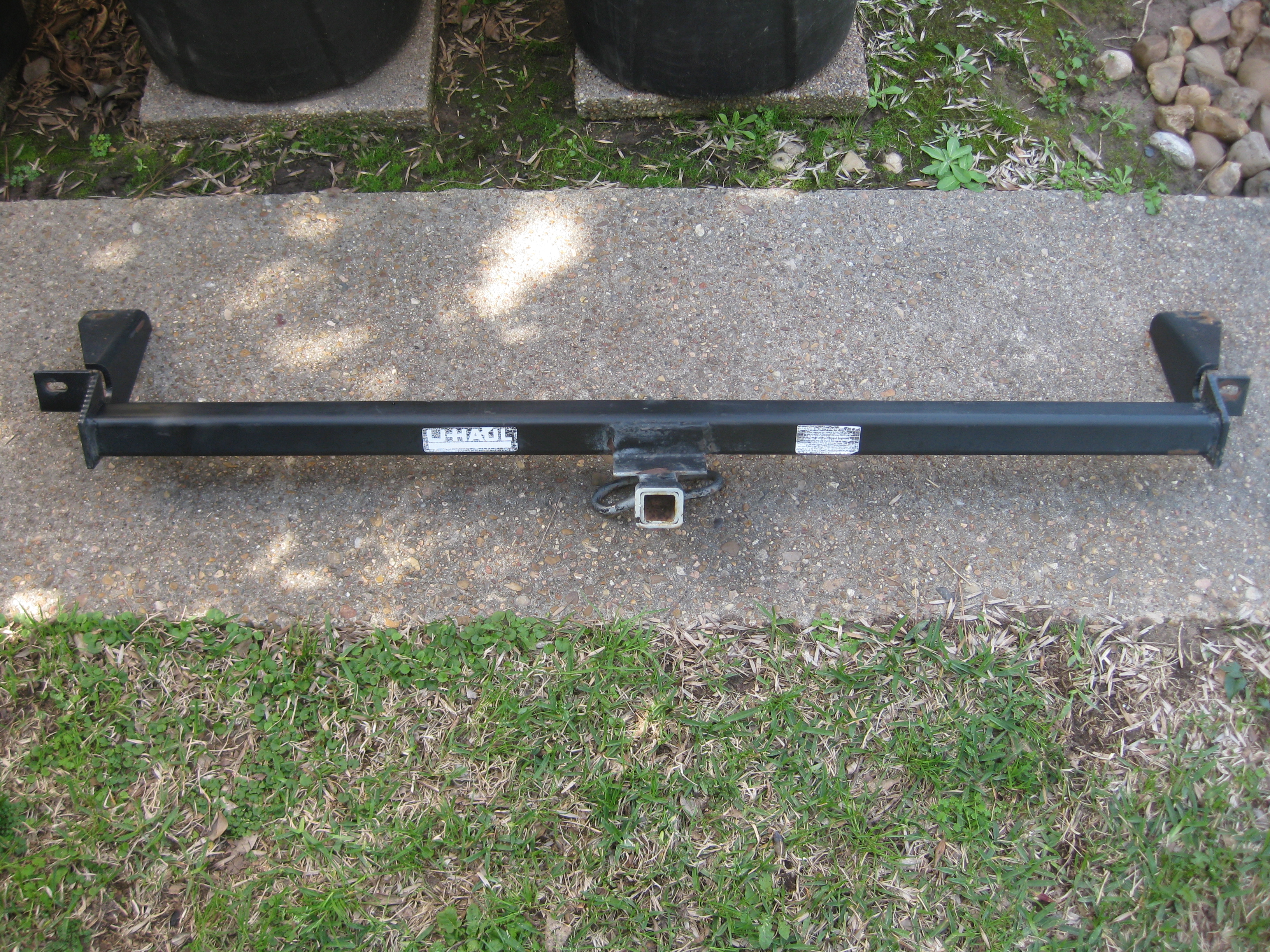

Nice score on the trailer hitch, James.. I'm envious.
You never come across a full hitch in the junkyards. It's usually the typical bumper hitches which my car had previously.
I like that you're accumulating all the cool parts before hand. It makes it fun when it comes time to reassemble the car.
Well, I probably could have painted the frame today, but did not. It warmed up to 66 degrees, but the morning started at 37 degrees, and I had already made plans to go to the J-yard today. It was 50% off today. I was going for the 2 Dr Blazer rear sway bar, but they didn't have one, so that didn't happen either... They usually have them, and I was just waiting so I could buy it for $11. Well, in my opinion I got something better. Trailer hitch. I have been wanting one for a while now to use a rear frame brace, and a cargo carrier. I will never tow anything with the car. In 5 years of hunting G Body parts in the yards, I have never come across one. They had an 84 Cutlass in the yard. Mine for $12.
You can see the chain "ring" is bent. I will remove them for a cleaner look, and they will not be necessary, since I'm not towing. To be cleaned and painted soon...

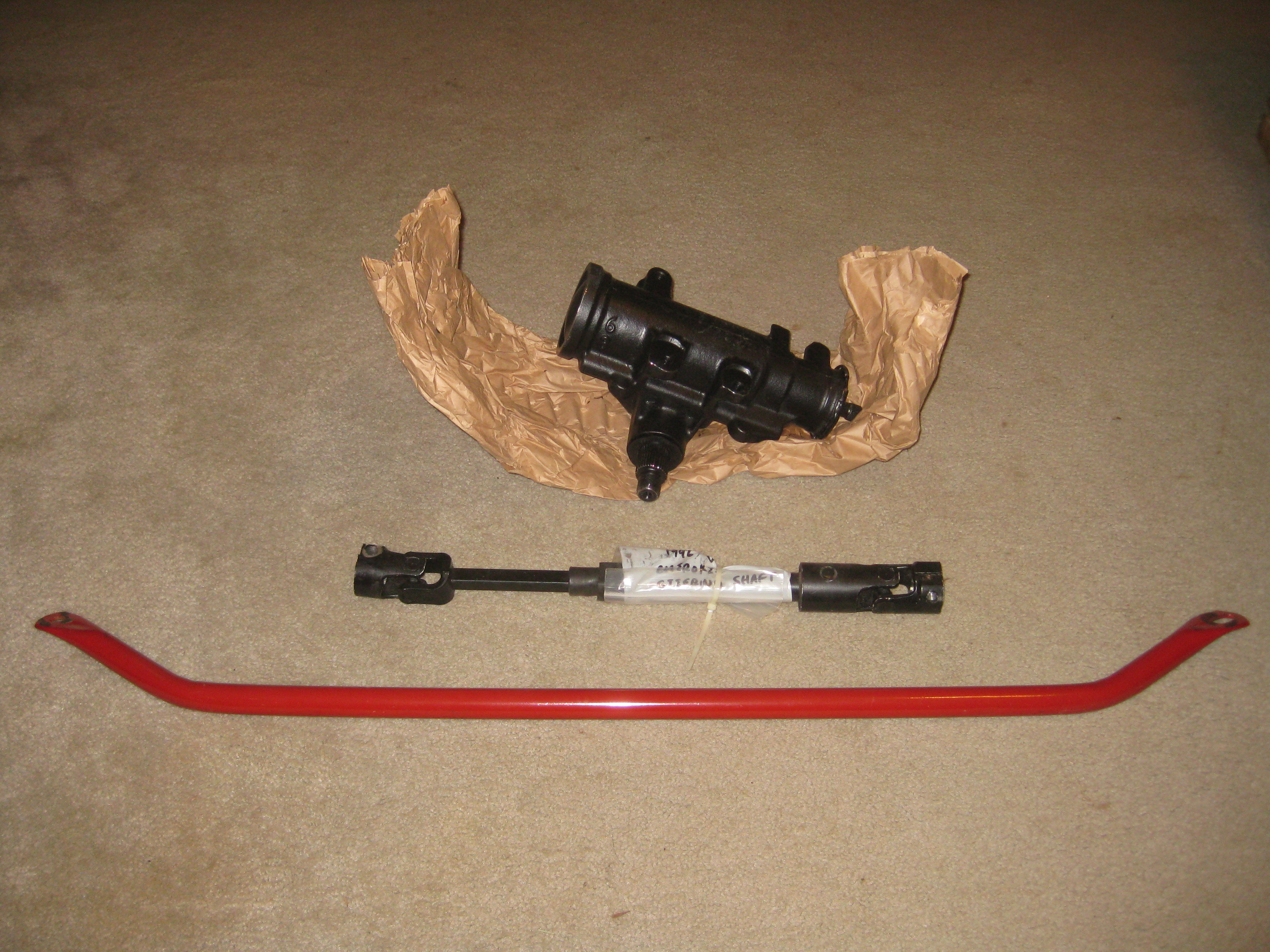

I also picked up the NAPA Monte SS steering box. I sure hope this is a correct quick ratio box. I'm skeptical, but it was listed as the correct box w/ Z65 sport suspension.
These are $141 at my local store. Lifetime warranty... I also dug a Jeep steering shaft, and GP frame brace out of my stash.
Now my car is a 78 ( splined column ), but I have (5) steering columns ( splined, DD, Manual & Automatic ) so I have options. Worst case... I weld the proper U-joint to the Jeep shaft, or use the best original G Body shaft that I have.

The NAPA 88-277101 should be equivalent to GM #7843135 if they rebuilt it right.
There's a myth I heard about MCSS gear boxes that they were somehow the hot ticket and were somehow better or quicker than the 442 box. I don't understand that one. The 2-door 83-88 Sport/HD/F41 suspension G-body cars all share the same exact production part number of 7843135. If there were any differences at all, it would be a different part number. Which is odd, because NAPA lists this as a direct fit for a Z65 Monte ss, but not a Cutlass. WTF.
Unfortunately, these rebuilders don't care if it's the sport suspension or not. If it's an 800 series it's an 800 series, thus, it fits. In the box it goes. Casting numbers could be the same, but the guts may be a tad different. Have to say, $141 isn't a bad price for a rebuild. Rebuilding them isn't cost prohibitive. If you have a good set of spanner wrenches, a kinda large flat blade screwdriver, a mallet, some bent scribe tools for removing that end cap ring, a pitman arm puller, seal drivers, and some patience, you can get a good rebuild kit and redo your own. You could probably do it with some even more rudimentary tools, but if you have 'em, use 'em. It takes a bit of skill, but it's not super difficult. Just keep your balls in the right order! 🙂 Gates and ACDelco rebuild kits share darn near the same p/n. Gates is 350430. ACDelco just adds a 36- in front of it. (36-350430). About 25 bucks free ship with prime from Amazon.

Here's pics of the box I'm using. It's a fast box. I only paid $200 for this one.
I could not agree more. That's why I'm skeptical. But like you said...$141 for a rebuilt box with a lifetime warranty... It's clean, and has new seals. I'll be sure to post feedback when I get it on the road.
Did you check lock to lock on that steery box yet to see if you got what you think it should be?
Not yet, but that's the plan. Gotta replace a section of fence at the house. Hoping to get to the shop on Saturday, and test it.
