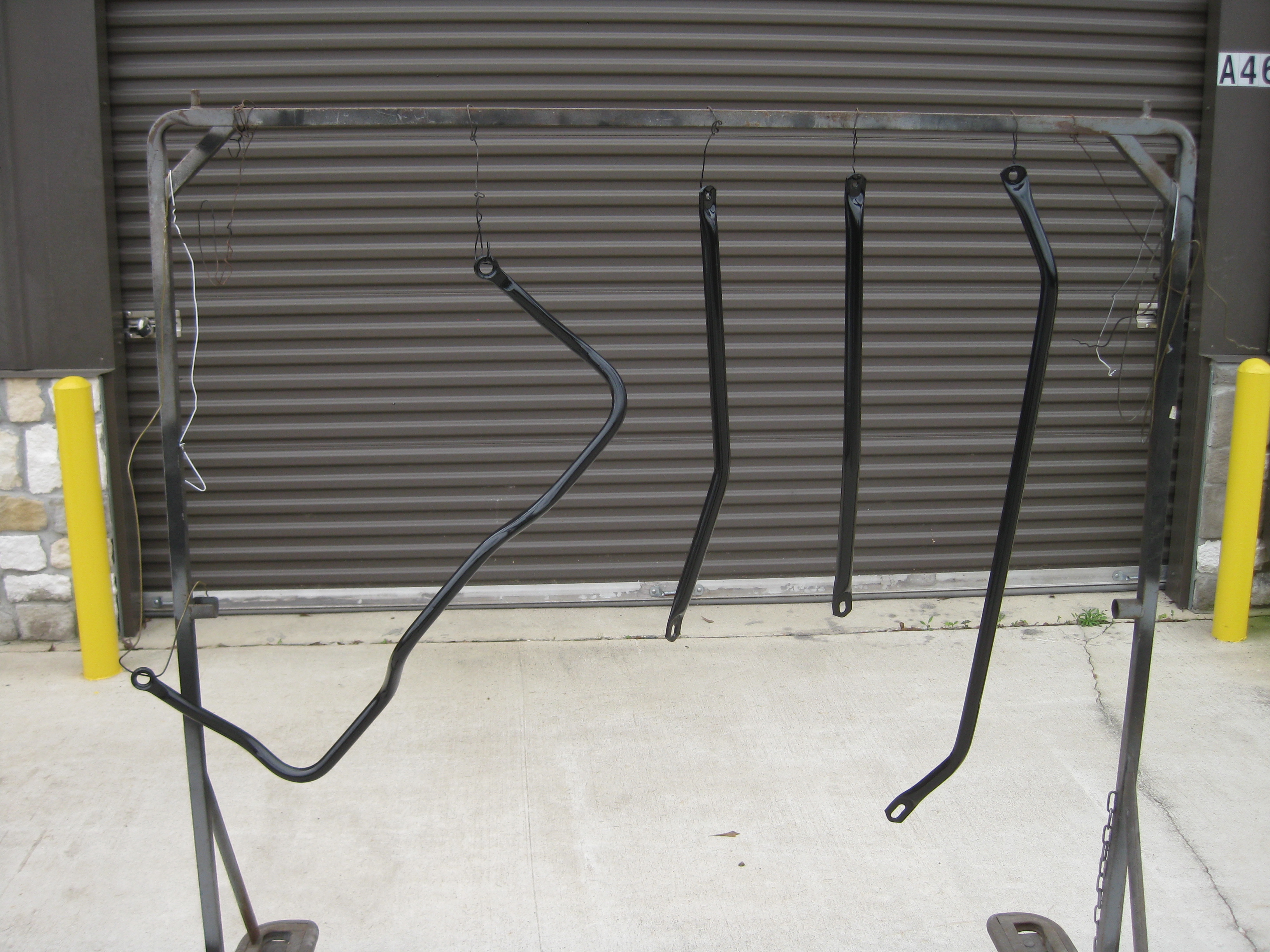

A few things to report... I got the front jounce bars, GP front frame brace, and Blazer rear sway bar primed and painted today.
Got the trailer safety chain "rings" removed from the hitch. I still have some clean up to do before prime and paint. I'll have it painted next weekend.

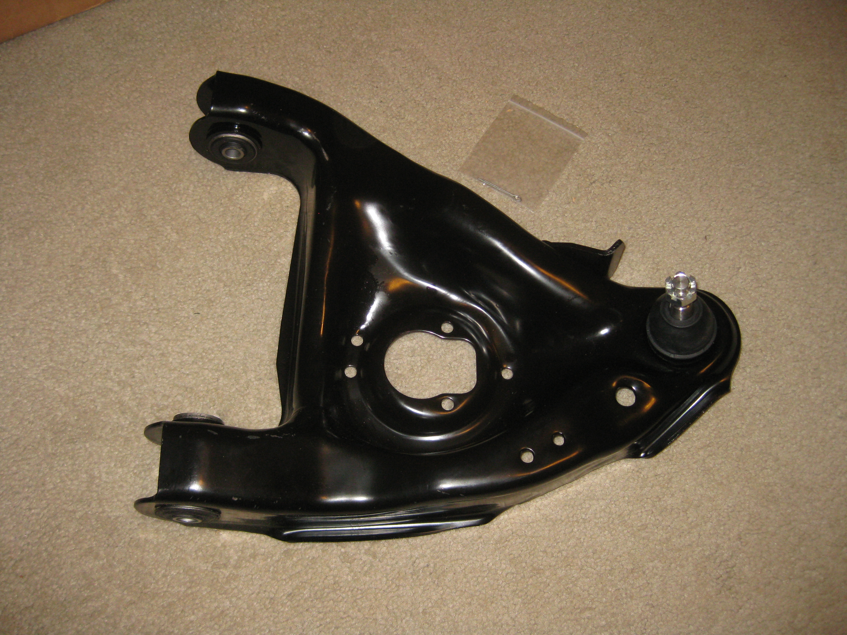

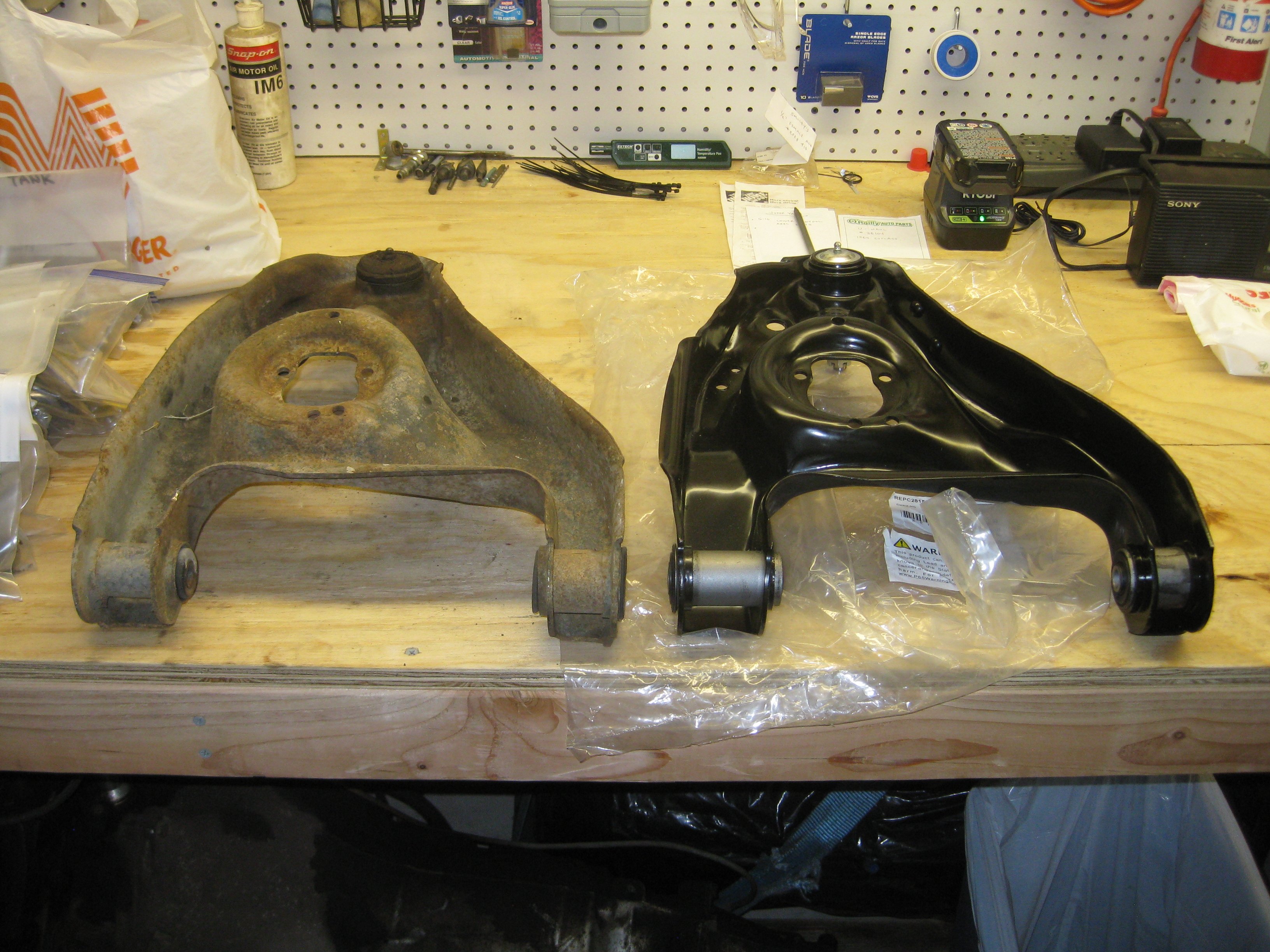

I also ordered (1) s10 lower control arm. These come loaded with bushings, and ball joint. The bushing sleeves are larger in diameter. So I need s10 lower control arm bolts. I'll get those from the junkyard for nothing $$. These control arms are clean, painted, and very tough to beat for $49. I wanted to compare with my original G Body arms before buying both. I'm going to buy the other side, and install the larger diameter bolts.

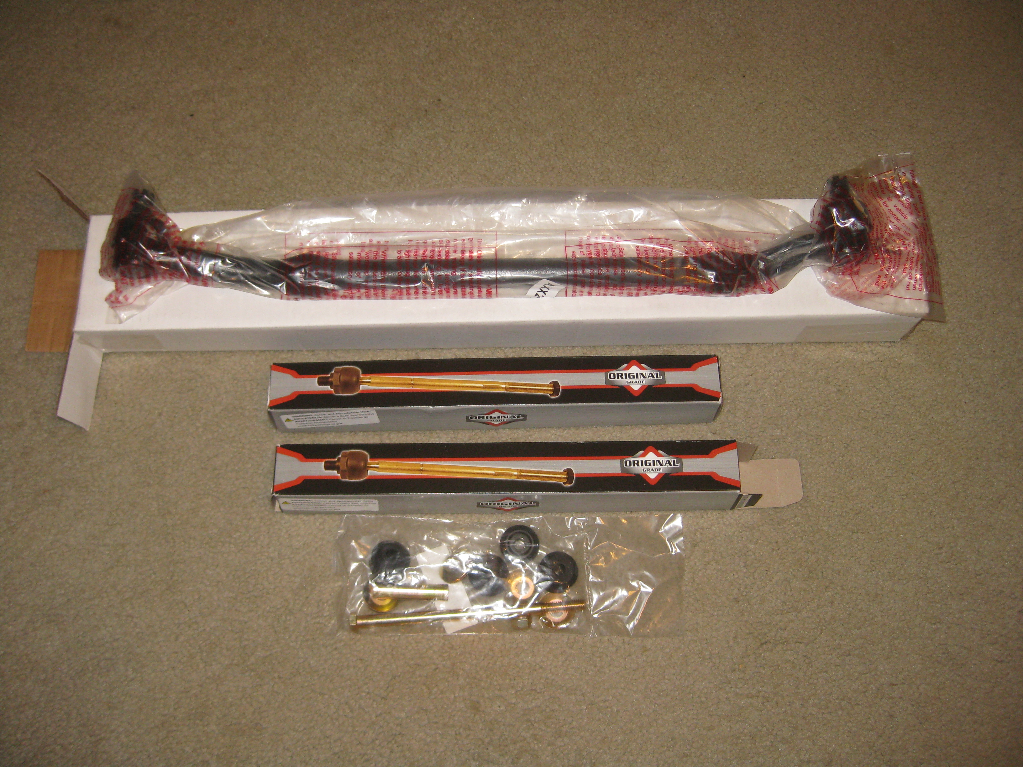

I also got a couple parts cheap from Rock Auto. Camaro front sway bar end links @ $1.69 each, and a AC Delco center steering link @ $27.79.

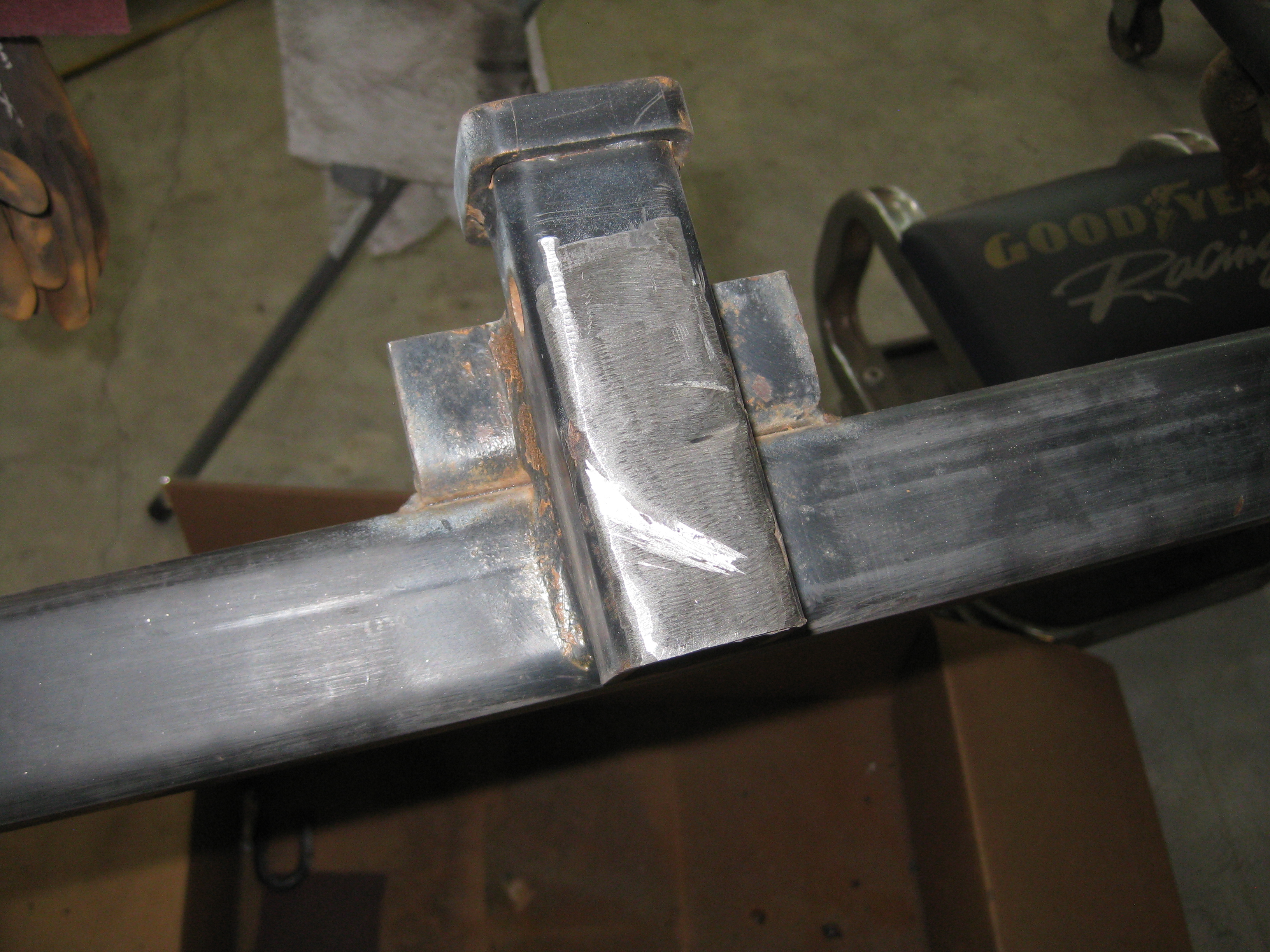

I have finally made room in the shop to be able to have the frame in it's own place, and the body in it's own place. Now I can start getting the suspension back together. I got the trailer hitch/frame brace, UMI rear shock brace, and the Jegs dual exhaust crossmember mocked up.
I received the other S10 lower front control arm. Can't beat $49 and the fact they are complete with bushings, and ball joint.
I went ahead and bought UMI S10 control arm bolts. They were cheap enough, and much easier than removing them at the J-Yard. I test fitted them, and they fit perfect.
