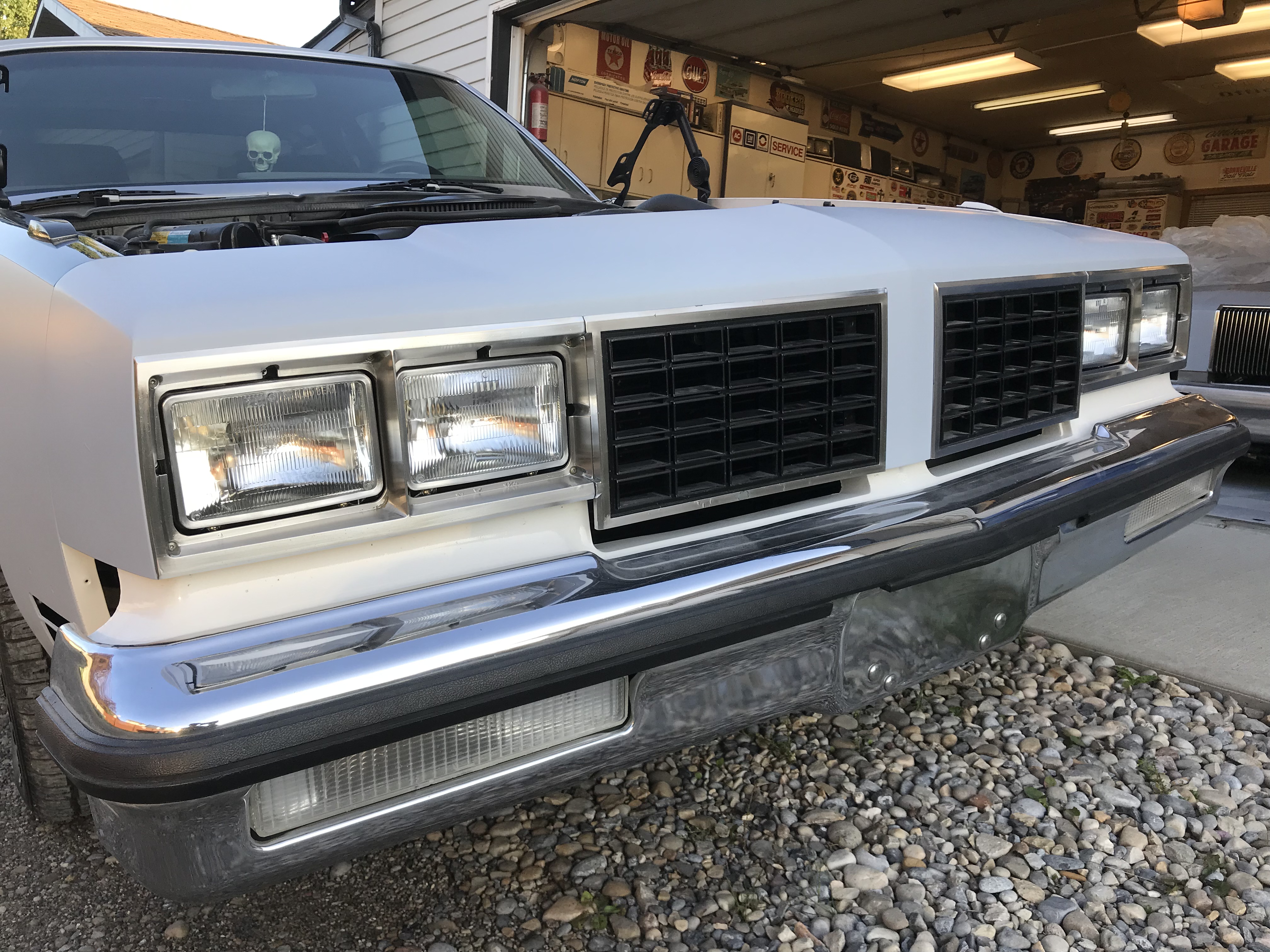

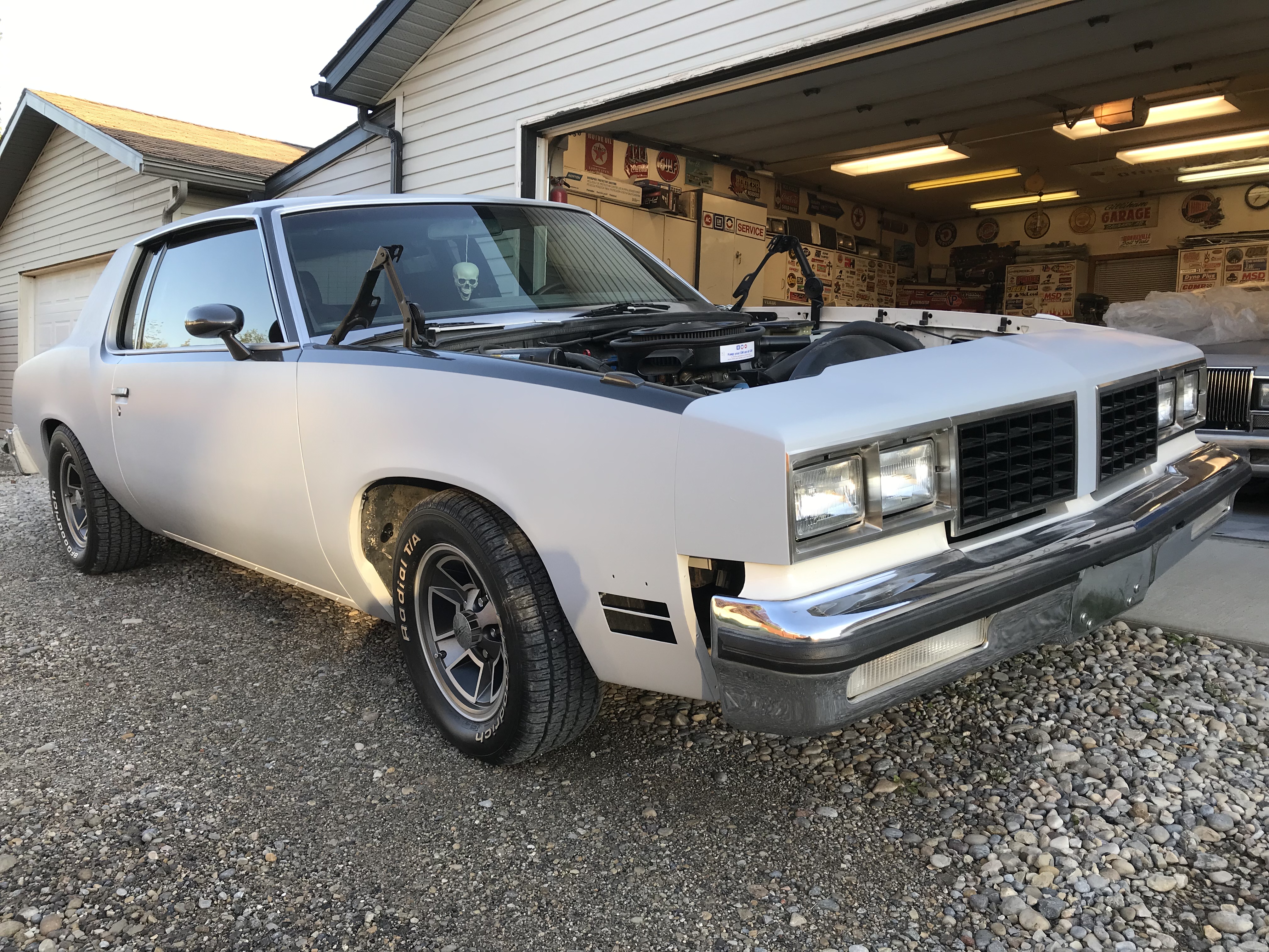

That car is gonna be a show stopper in the near future. I cant wait to park my gongshow next to it so it looks even more fabulous.
The face Donovan secretly makes when someone suggests doing something half assed.
Hahaha
Thanks buddy. I wouldn’t sweat yours not looking “pretty” yet, by the time (and if I have anything to say about it) we’re done, it’ll look just as good if not better too. Especially if you still want me to help out with some of the bodywork on it.
And yeah, I just can’t bring myself to half-*ss anything. Especially when the materials are so expensive, there’s so much labor involved, and so much can go wrong with the end result.

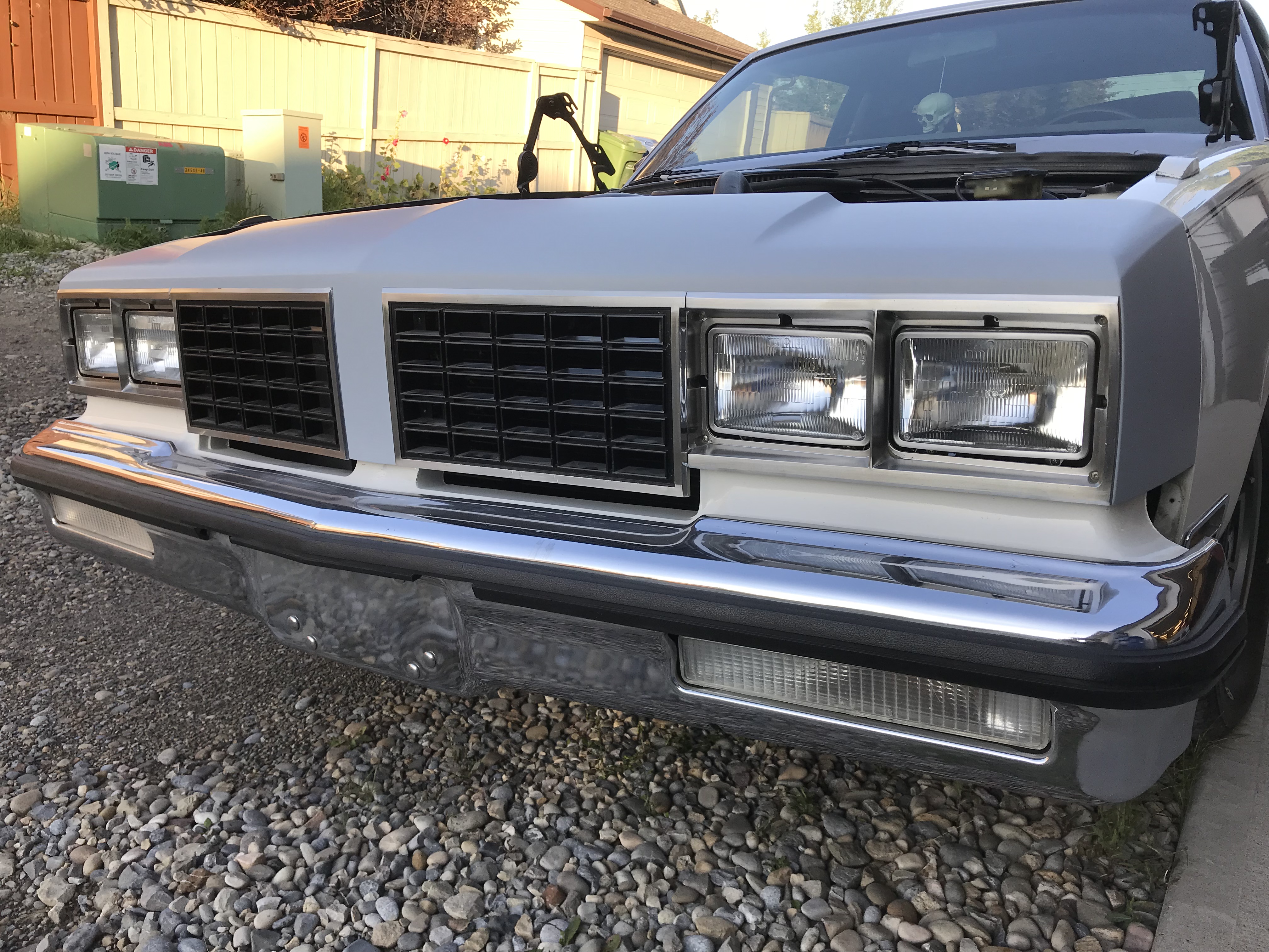

Not a whole lot to report on from the Rktpwrd skunkworks lately, just a whole ‘lotta sanding and stripping of the hood.
I had been doing most of it inside the garage, but after the last big cleanup I had to do because of the utter disastrous mess it made, I self imposed a rule that it can only be done outside from now on. This has been good and bad, it’s dramatically cut down on the amount of dust in the garage and all over everything, but with the days getting shorter by the minute it’s also drastically reduced the available time and permittable weather there is to work on it.
Even so, considering there’s 5 layers of product to remove, I’ve been making decent headway on it. All the sides have been stripped down to bare metal, along with approximately 60% of the surface.
Here’s just SOME of the nasties that were there before I started. Hard to believe a body shop let this go out the door:
This particular offence is an “outie” from the underside, judging by the location it was probably caused by someone closing the hood on a too long air filter stud. They’re just lucky they didn’t punch it right through!
Where I’m currently at in the old paint stripping process:
