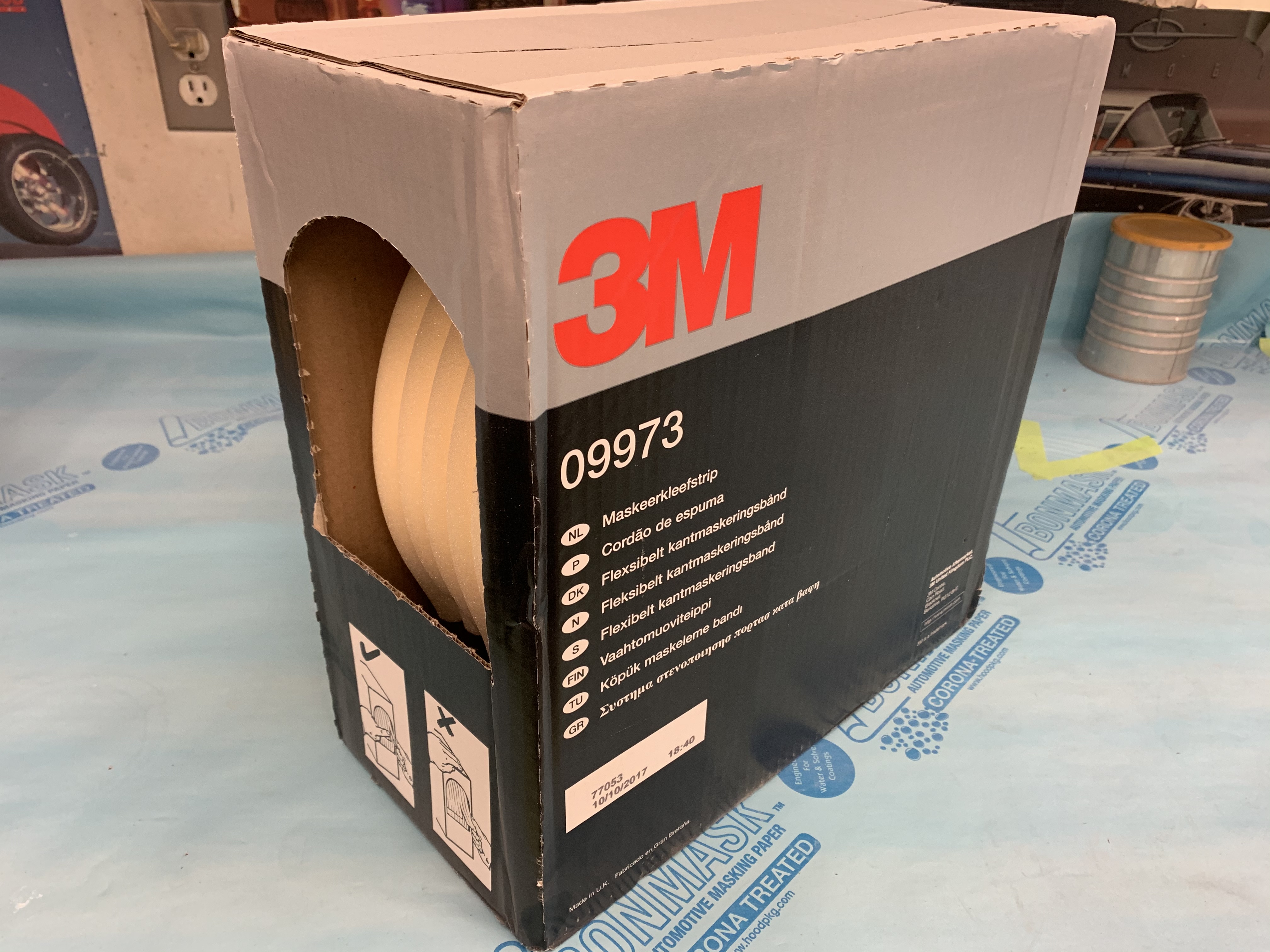

So along that line of thought, there’s several ways to skin that proverbial cat too. But most of them vary depending on the area to be masked. Personally, I plan on making almost exclusive use of this stuff...

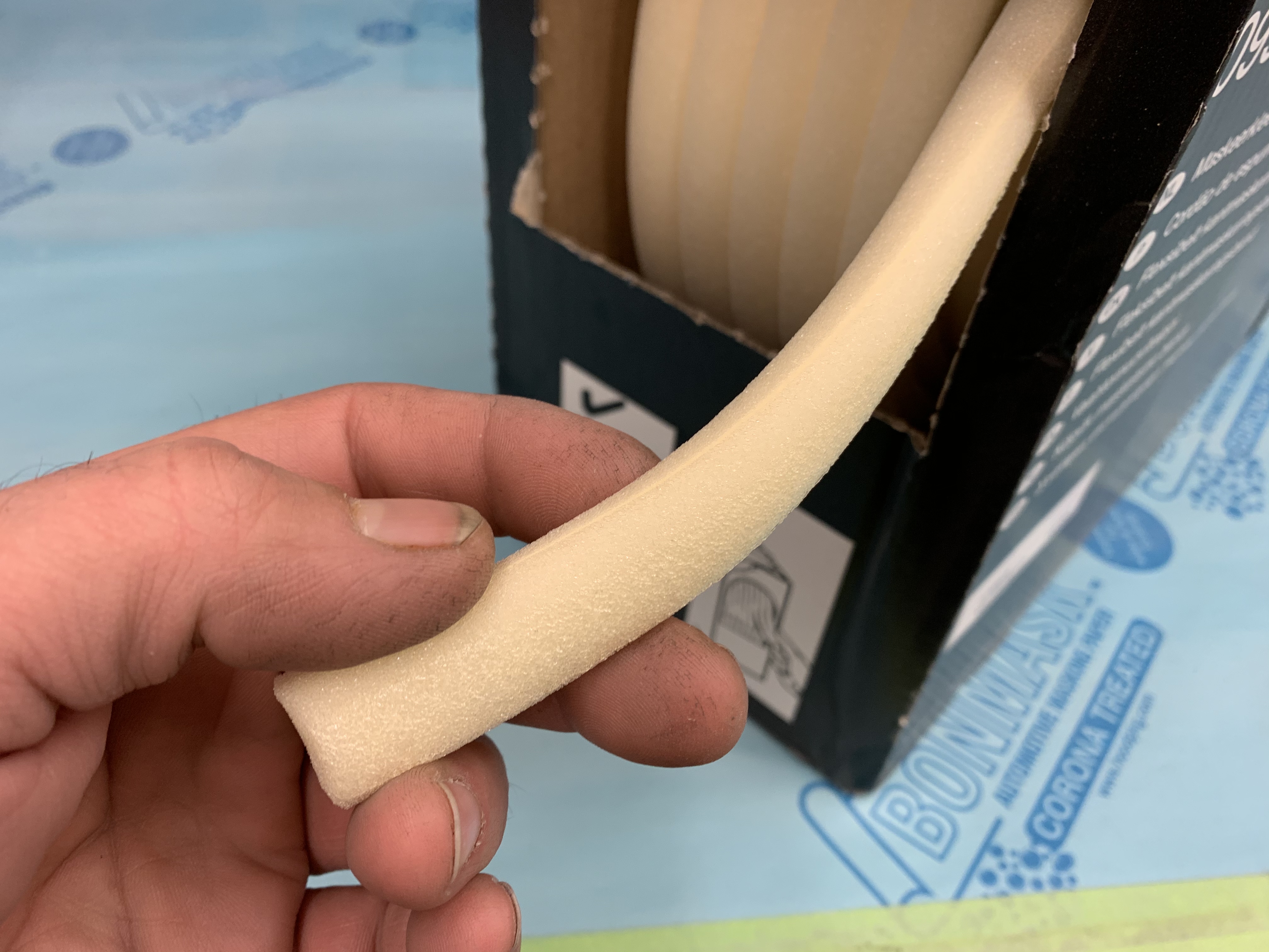

....it’s a round foam product with a very sticky adhesive on one side. It’s used to obviously prevent paint from going where you don’t want it, but because it’s round it doesn’t leave a hard edge. It leaves a soft edge that can be carefully blended into the underlying paint if desired, but that’s usually not bothered with. I plan on using it inside anything that has a gap: Doors to quarters, trunk lid to quarters, trunk lid to filler panel, hood to fenders, etc etc.
About the only place I can’t really use it is in the door to fender gaps. That’s because there’s absolutely no access to the backside of that gap when the doors are closed. All is not lost here however either, some careful masking on the back inside of the fender gap, followed by back masking the door side while it’s still open, will protect this area once the door is closed. Like I said, various masking techniques will need to be used in different areas.
As for paint coverage on the edges? Two things; 1), I always make sure to back mask the panels when I paint the insides to ensure the edges get coverage, and 2), by using the techniques I outlined above, paint will still end up on the edges without leaving a mask line because of the soft edges. If there is any discernible difference between the inside and outside edges, it’ll be in a place that is all but impossible to see. (Like the backside of a fender edge).
