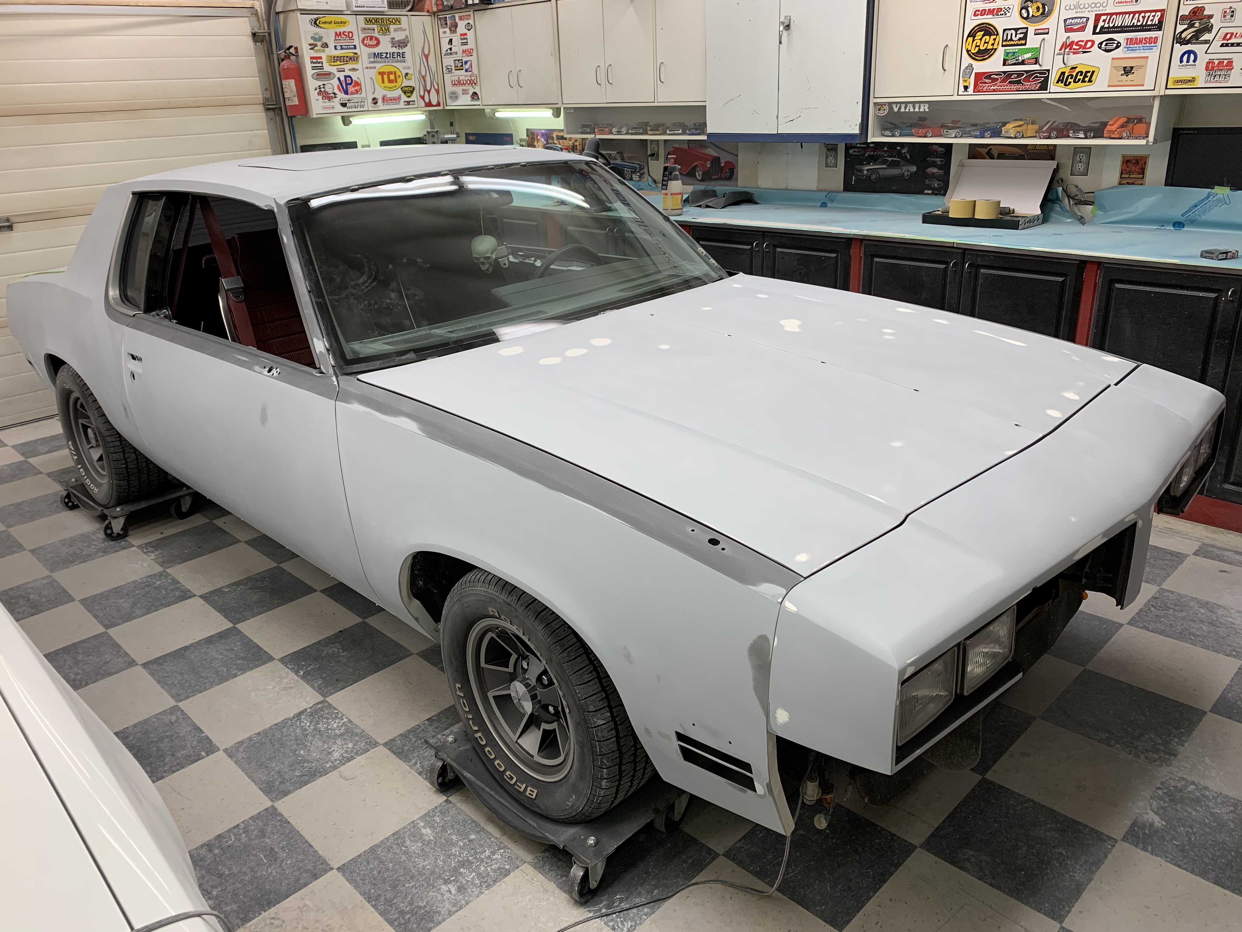

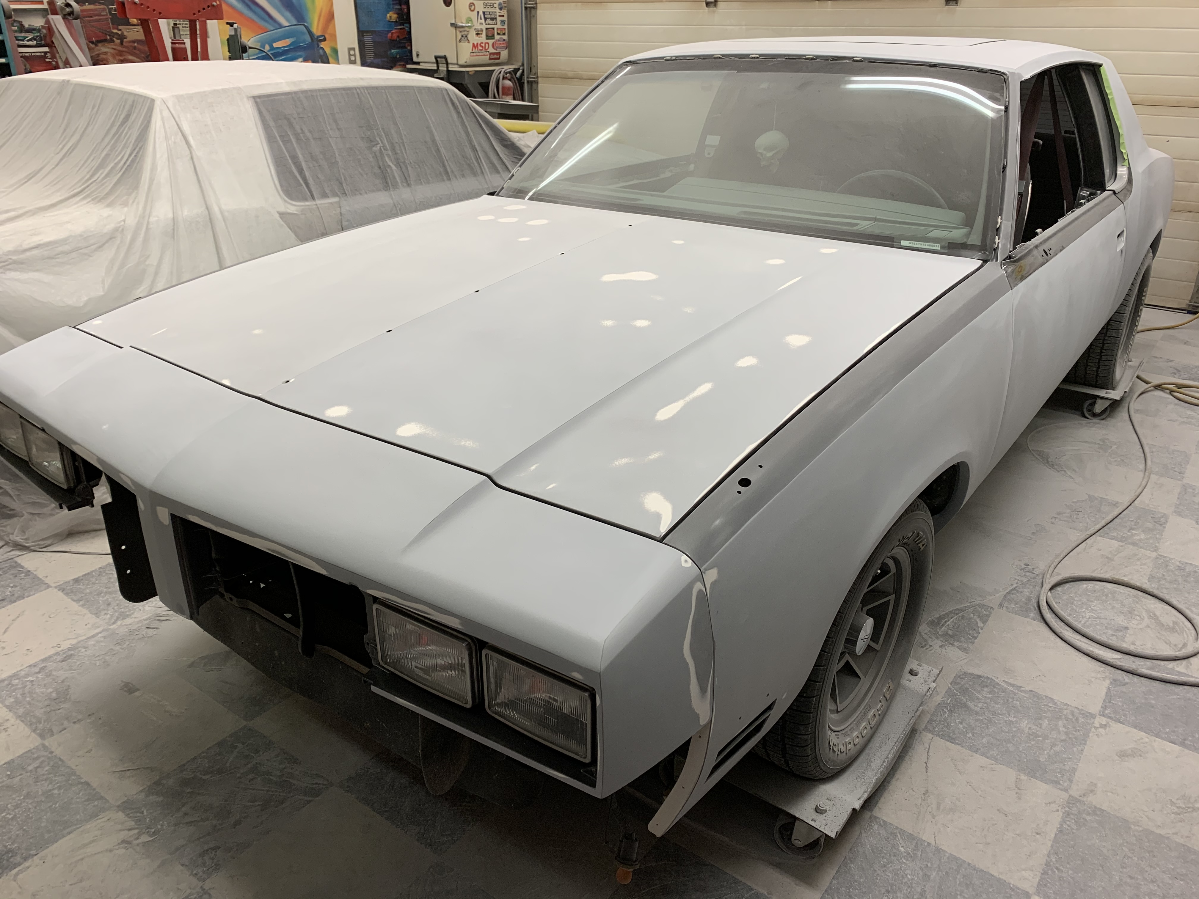

The car is now 100% completely blocked out, I finished up the tops of the doors and underneath the quarter glass mouldings in 320 a couple days ago.
Here she is now in all her dusty glory:

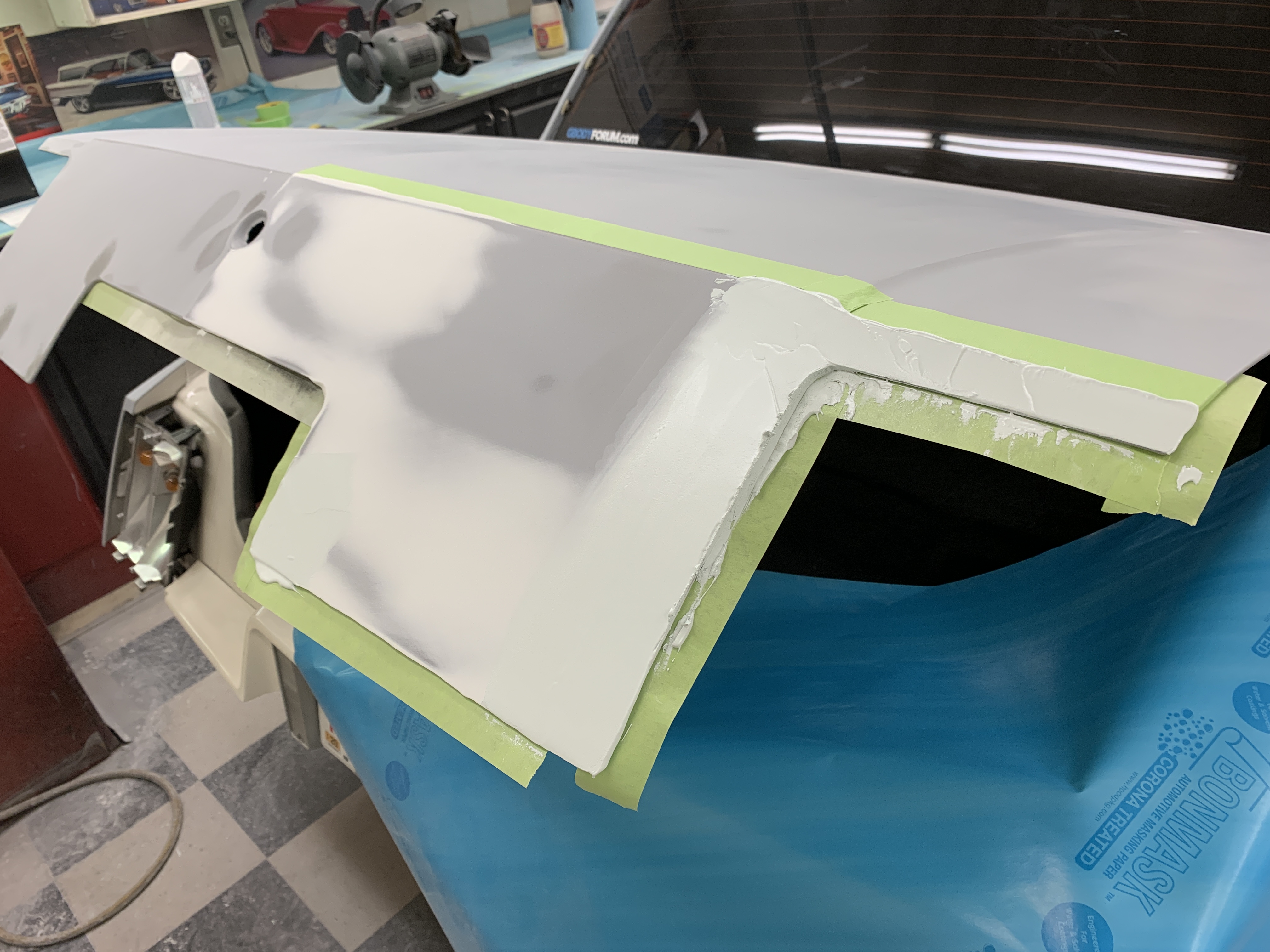

That means I’m into repair mode now. By rights, I should probably be starting from the top and working down fixing all the little issues I come across, but I figured it might actually be better to go after the worst offenders first. That means the trunk lid and hood. So with that mindset, I tackled the trunk first. Sanded all the areas that I knew were going to be too low to fill with more primer in 180 grit, then skimmed them with some USC polyester finishing putty:
This stuff is safe to apply over properly cured and sanded topcoats including primer.
Then blocked with 80, 120, 180, and 220. Felt like I was starting all over again!
The tape on the edges and the masking paper underneath is to catch any “oopsies”. This putty is quite runny which is great for filling low spots and pinholes, but you really gotta watch the edges. It’ll drip right off before you know it.

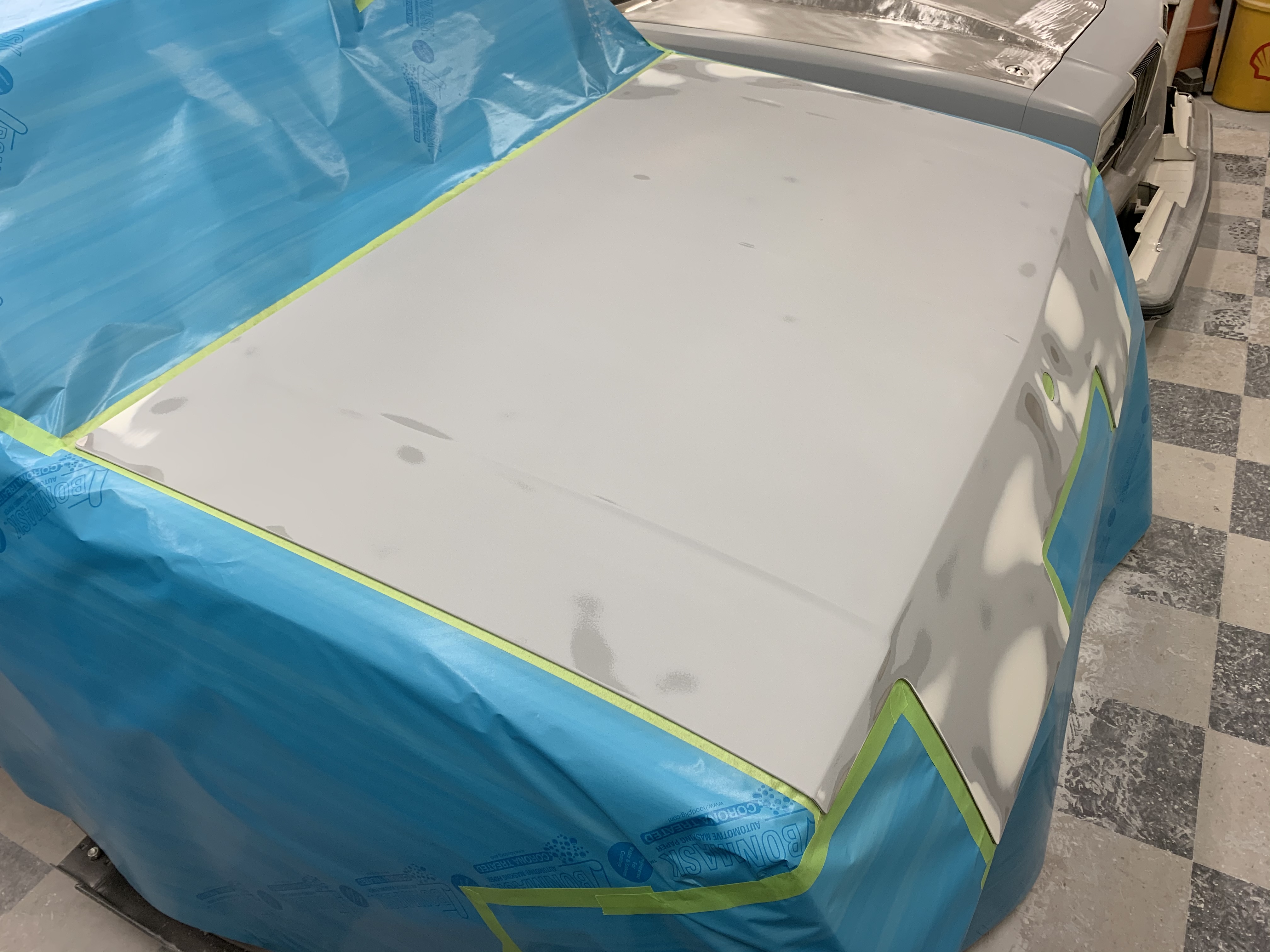

Once I finished blocking it out and addressed all the edges, I gave it a thorough wipe down with wax and grease remover then masked it up.
This bish is ready for another 4 coats of high build!
Some of you might be wondering why I’m getting ready to shoot primer on just this panel already? There’s lots more little repairs to do on the rest of the car, why not just repair everything first, then prime everything at the same time?
Couple reasons.
First of all, it’s much easier to tackle the entire car if you break it down into one panel at a time. Get just this panel done, get it right, then move onto the next. That’s gonna include blocking it out to 220 again without burning through anywhere. Fingers crossed there. 🤞🏻
Second, it’s a lot less daunting of a task to mask just one panel than it is the whole car. And we all know how much I love masking. Sure, I’ll use more tape and paper that way, but those are relatively cheap in the big scheme of things.
And thirdly and most importantly, the Omni high build primer I’m using has an extremely short pot life. At a maximum of only 5 minutes flash time between coats, I’m damn lucky to get 4 full wet coats on before it begins to harden and becomes unusable. There’s almost no possible way I could go around the whole car and get coverage on everything I’ll need to with that small a spraying window.

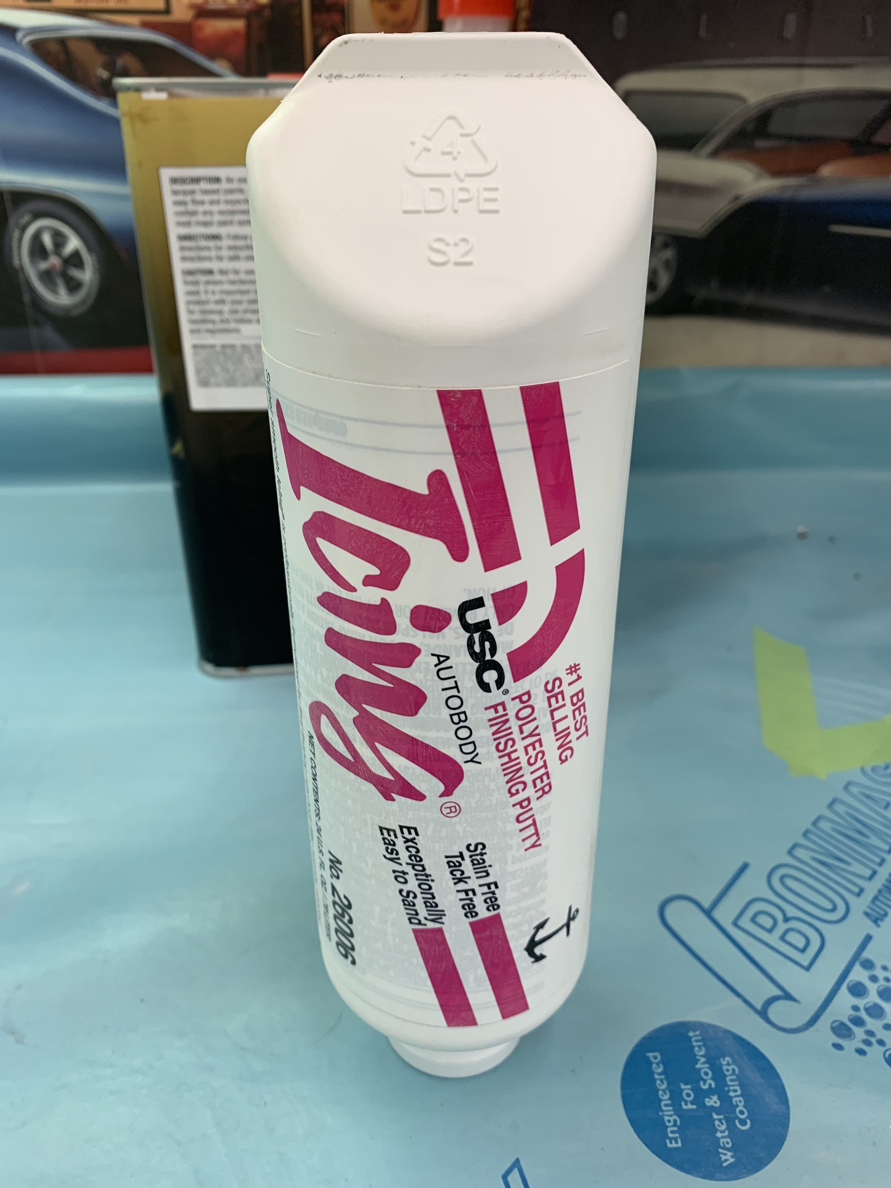

Is this the garbage you speak of? Im glad it was only 10 bucks.Thank you Jeff. I really appreciate the support. It all helps, especially at this stage.
Yes, I will be able to use finishing putty here, not spot putty. Forget about spot putty, that stuff is garbage. It’s non-catalyzed and shrinks as it dries.
For the finishing putty I just have to lightly sand the low areas first with the proper grit so it adheres well, either with 180 or 120. it’s a bit of an educated guess based mostly on experience to know which lows will fill with another application of high build, and which will need a skim and blocking with putty first.
