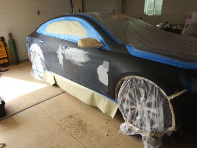

Donovan, is it absolutely out of the question painting it in your shop? I'm just thinking if anyone can pull it off it would be you. I have been lamenting on how to spray mine when time comes. Please tell us getting a "good Paint" job can be done without a booth.... I'm not talking about Riddler quality here.... just very nice.
It's absolutely possible to get good results in a garage. If you are building a car that will be driven, absolute perfection is not required. It will get rock chips. My brother's car already has a good sized one on the front bumper cover andvit has maybe 5k miles on the paint job. This car was painted in a garage....
Donovan, if the booth means that much to you, $500 doesn't seem that much to me. You know more about this than me but I'm told you will have trash in the paint, even using a booth. Color sanding is what makes or breaks the paint job.

I painted my car in the garage. It's alot of work preparing a garage for paint, but it's absolutely doable. With a bit of creativity setting up an exhaust fan(s), lighting, etc.,,,and of course, covering the entire garage to keep the dust at bay and preventing parts of the garage that you don't want over spray on. Let's face it, nothing beats a well equipped, well ventilated spray booth. Sometimes you gotta do what you gotta do. We all have an innate bit of creativity in us all.
Sometimes we have to tap into it in order to get it done.

Sorry for the lack of replies and updates lately, I’ve just continuing to keep really busy in The Skunkworks. I haven’t updated recently because I was getting the feeling y’all are getting tired of reading the same ‘ol thing every time, “masked and primed this, and block sanded that” over and over again.
I get it, it’s dull to read and dull to do too some days, I can assure you. However part of me wants to continue to do it just so you get an idea of just how much work goes into a quality job, how labor intensive it is, and how long it takes.
And before y’all start asking, no the car is not painted yet, in fact all the little areas haven’t even been finish repaired yet. But I’m still hammering away at it, night after night, week after week.
The booth situation is still up in the air too, but I’ll sort something out there as far as that’s concerned.
Starting to finally make some headway, in fact the list of what’s been addressed is actually shorter than what’s left to go.

I’m currently in the midst of working on the driver’s door, the repairs there have been done and tonight I got it masked up for spot priming more high build:
I’ll just be hitting the repaired areas, there’s no real need to re-prime the whole door.
