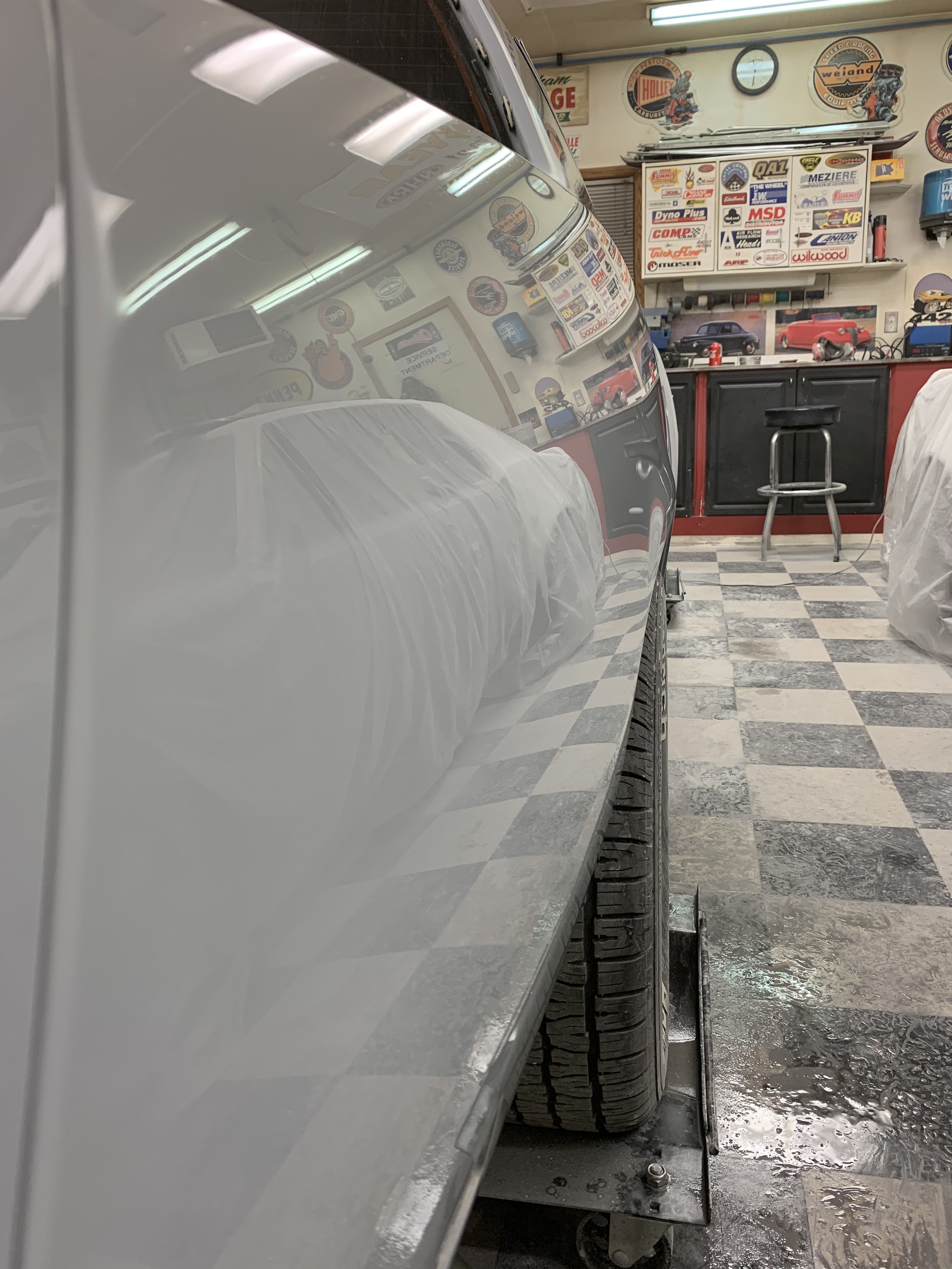

I was up bright and early well before he got there, and got the passenger’s door and fender cleaned, guidecoated and DA’d out in 320, then guidecoated again in preparation for the 400 wet:

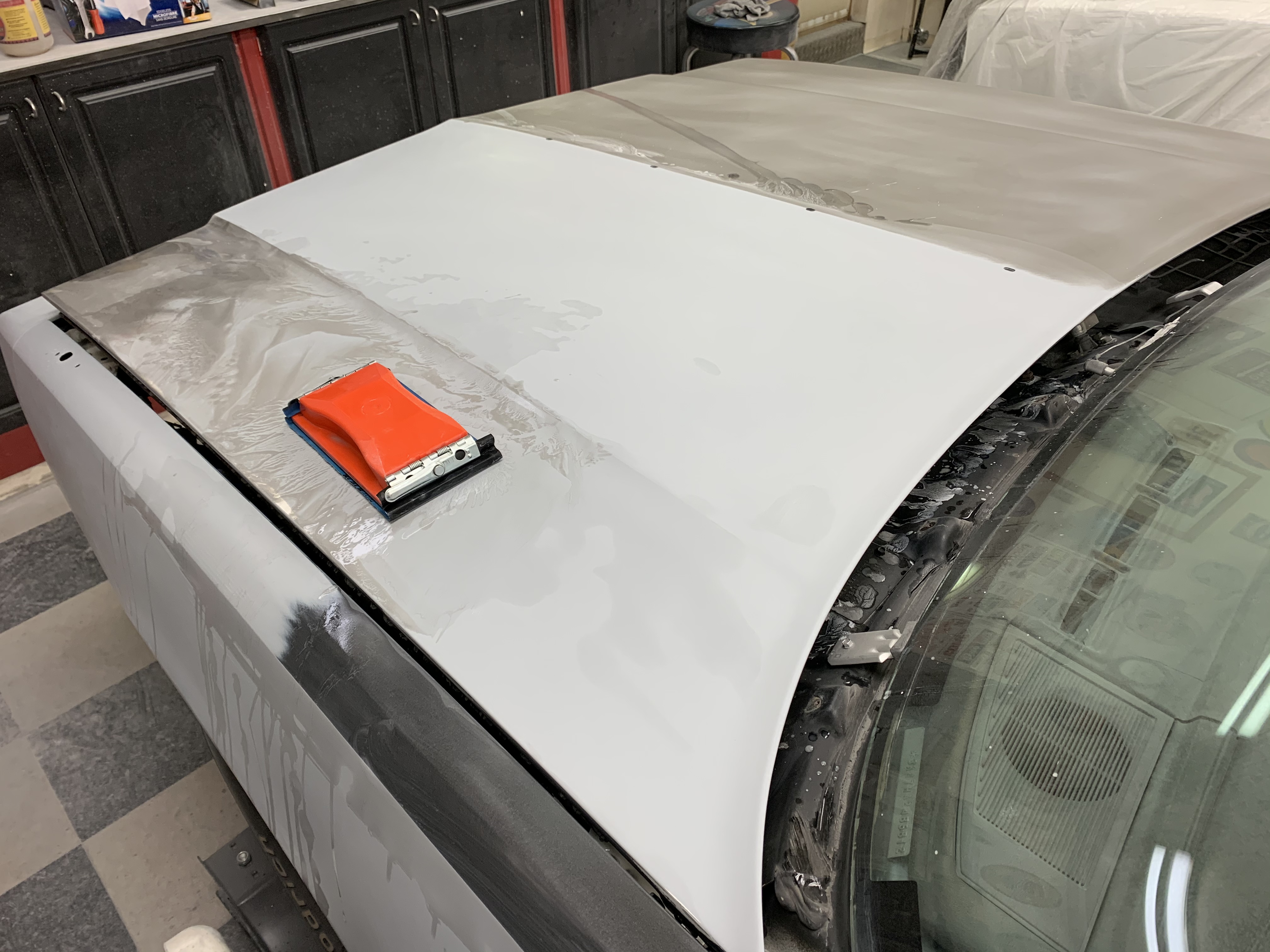

Once he arrived, I got him scuffing up the already painted rocker panels and pinch welds with red ScotchBrite while I started wet sanding the door and quarter. I plan on back masking off of the backside of the pinch weld on the bottom half of the car, so I also had him give the backsides of the pinch welds a good scuff and cleaning with Scotchbrite as well. This will ensure all the dirt and debris is cleaned off so the tape will actually stick there.

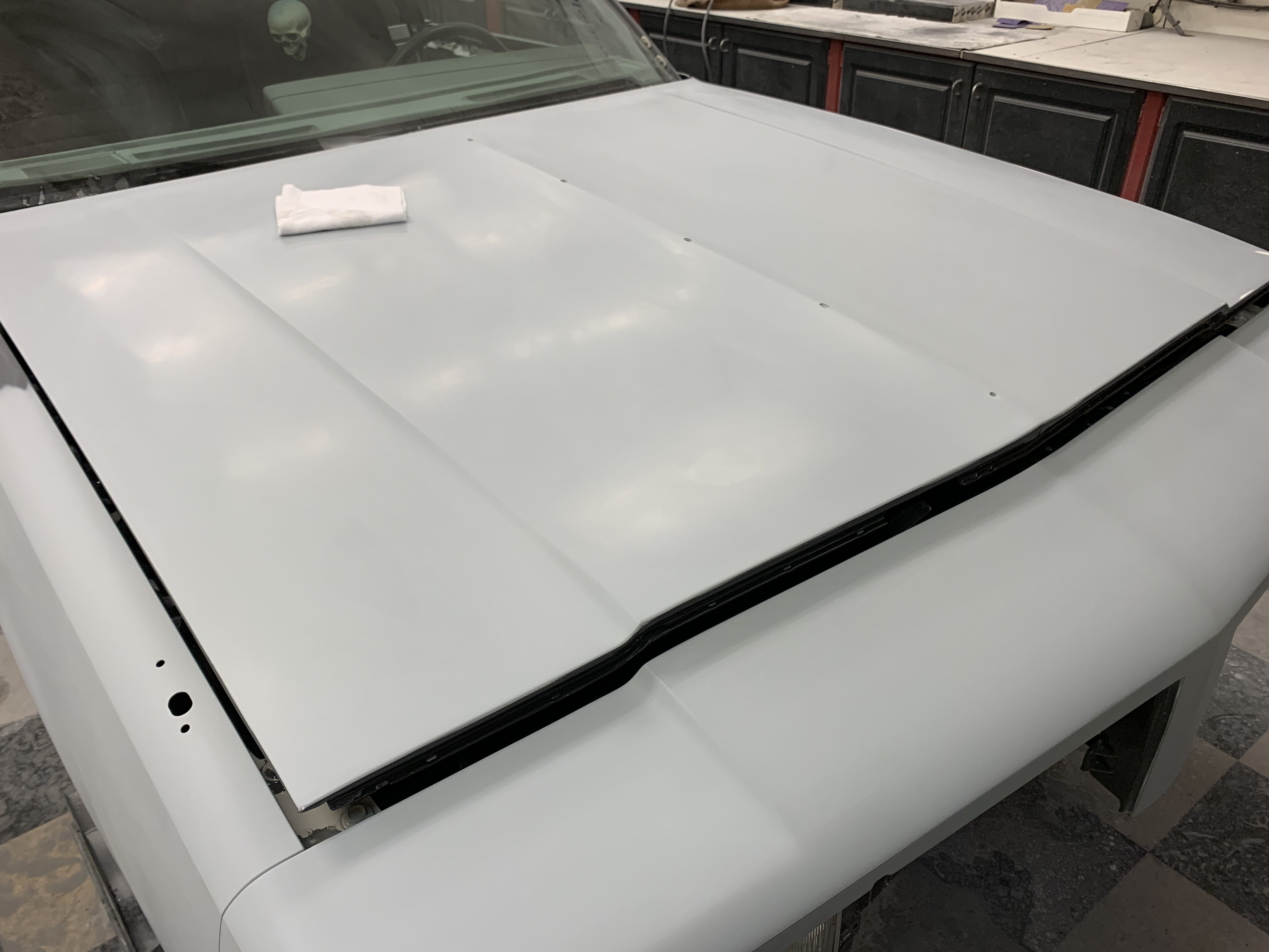

We rounded out the day with me DA and wet sanding the sides of the header panel, and him scuffing the inside flanges on all 4 wheelwells. Now, all the bottom parts of the car are completely cleaned and prepped, and the entire passenger side of the car is completely finished as well.
