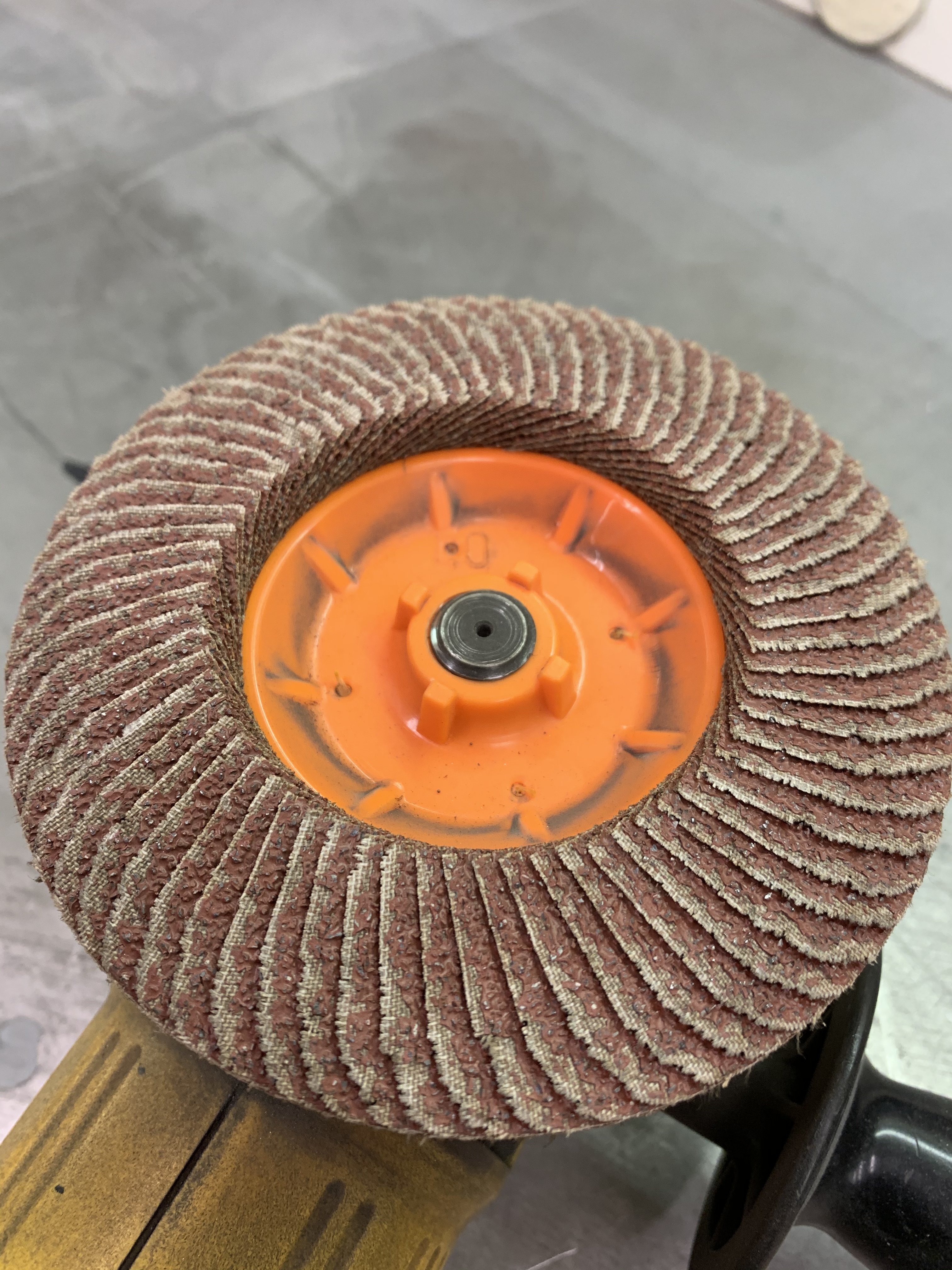

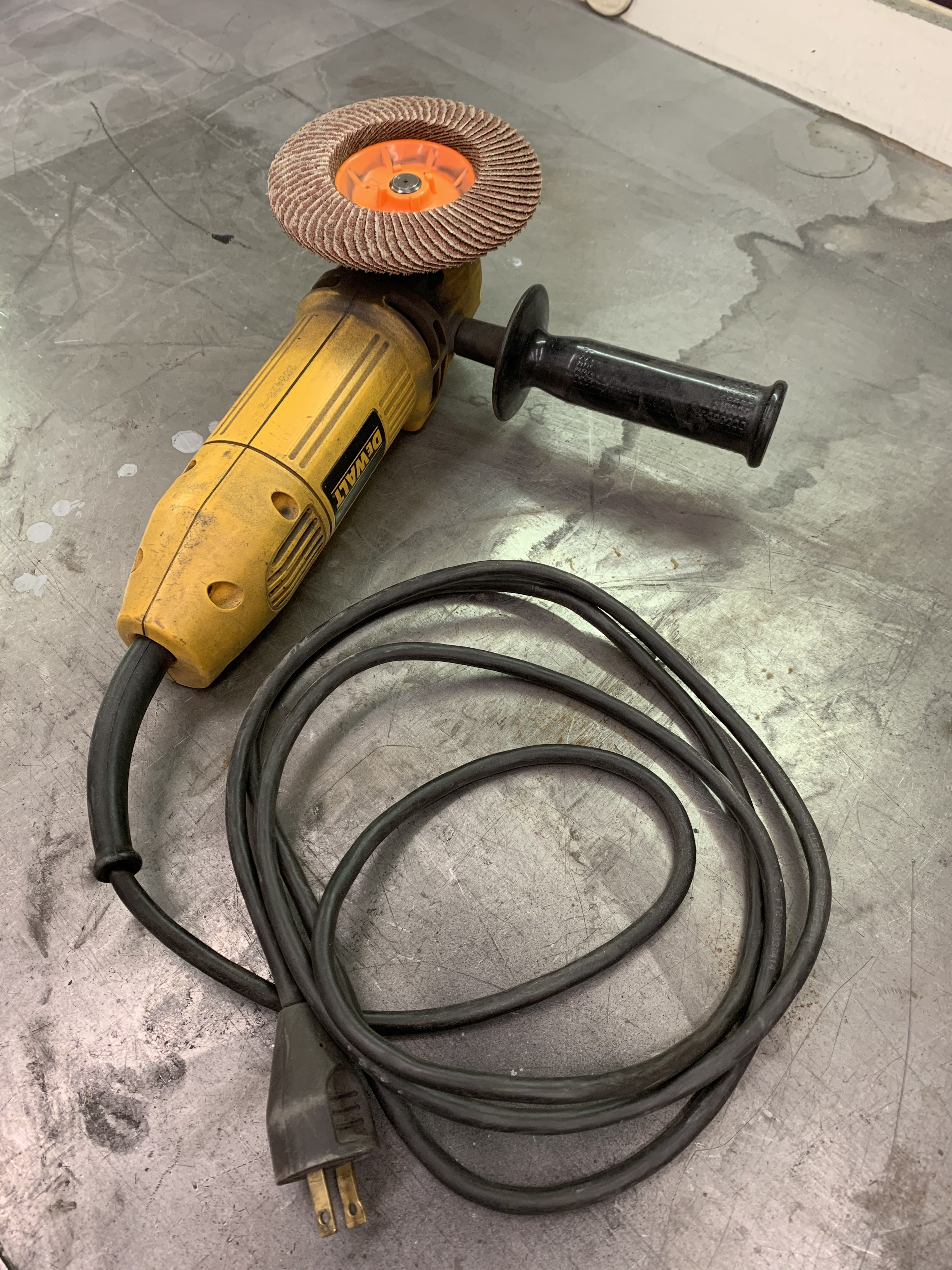

I gotta tell you guys, if you ever have any heavy fabrication to do, pick yourselves up a Walter brand flap disc. I use this one on my 4 1/2” DeWalt angle grinder, and it makes very short work of anything you want it to do:
It knocks down excess material and welds with ease, and if you have a light enough touch, it’ll leave a perfect finished surface. No skipping around like grinding stones, no backing nuts and wrenches to mess around with (they simply spin on), and they last a very, VERY long time. This one was already used before tonight and it still looks like I’ve barely used it....

I use them daily at work. I love them we buy them 40 at a time and use them mainly for deburring the stainless steel sheet as we cut and make whatever we're doing that day. You get very good at having a light touch as you called it, to soften the edges and smooth them out after using a shear to cut the sheets up... They aren't cheap, but well worth it and last longer than the cheap ones too.

Those 4 1/2” flap wheels are great. Someone introduced them to me years ago when watching me making log style headers. They are extremely easy to shape cuts with smoothly.

Do you use a flap wheel on sheet metal too? I’ve never tried it on that.
I wouldn’t recommend it personally. Too easy to put a bunch of heat into the panel. These things are aggressive and will remove a lot of material in very short order. I still prefer to use 40 grit discs on my air angle die grinders to dress sheetmetal welds. Much easier to monitor and manage the heat that way.

What grit do you use to knock down the welds? 40? 60?

Thanks Hutch. I have a couple of those Walter flap wheels in varying grits. The crossmember was ground down and dressed out in nothing more than 40 grit. Hard to believe when looking at what a fine finish it leaves on it.
