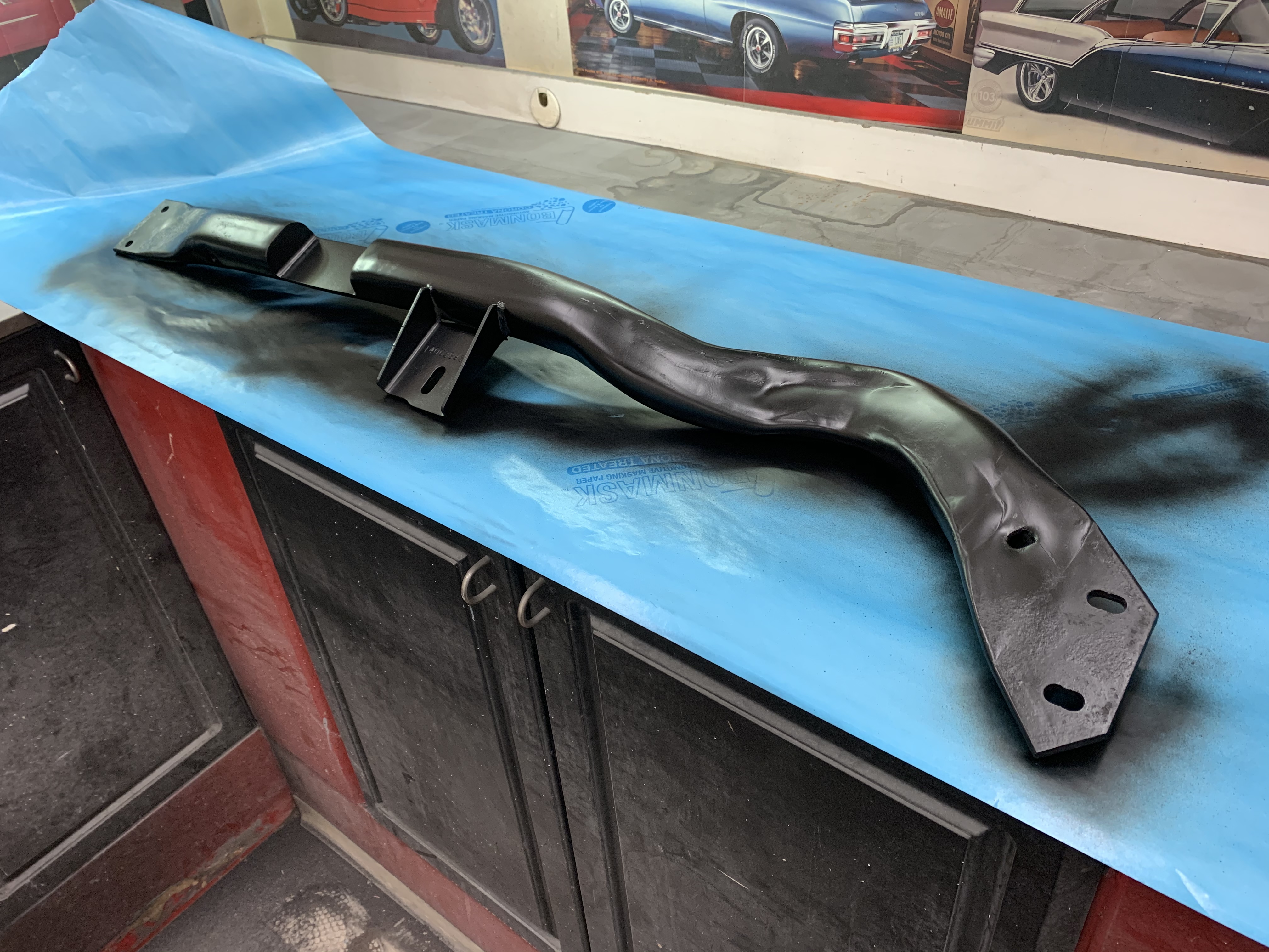

Donovan, once again the level of skill is impressive. I would've never thought to use C channel, but it's super strong and won't be going anywhere. The finish job looks killer, now it's painted it just disappears which is obviously the intention.
Well done man, another custom touch from the Ole Skunkworks garage.

Anyways, tonight after dinner I got right down to welding and grinding feverishly, and before I knew it I was done. I love welding on heavy gauge material, way easier than welding sheetmetal. Laid down a couple of decent beads, maybe not Instagram worthy, but still not bad IMO for a MiG and a guy that hasn’t picked up a welder in at least two years.
I didn’t stop to take pictures in the heat of the moment (pardon the pun), so all you get is finished ones.
I gotta tell you guys, if you ever have any heavy fabrication to do, pick yourselves up a Walter brand flap disc. I use this one on my 4 1/2” DeWalt angle grinder, and it makes very short work of anything you want it to do:
It knocks down excess material and welds with ease, and if you have a light enough touch, it’ll leave a perfect finished surface. No skipping around like grinding stones, no backing nuts and wrenches to mess around with (they simply spin on), and they last a very, VERY long time. This one was already used before tonight and it still looks like I’ve barely used it.
Are you listening Motorheadmike?? It’ll make even YOUR welds look good!

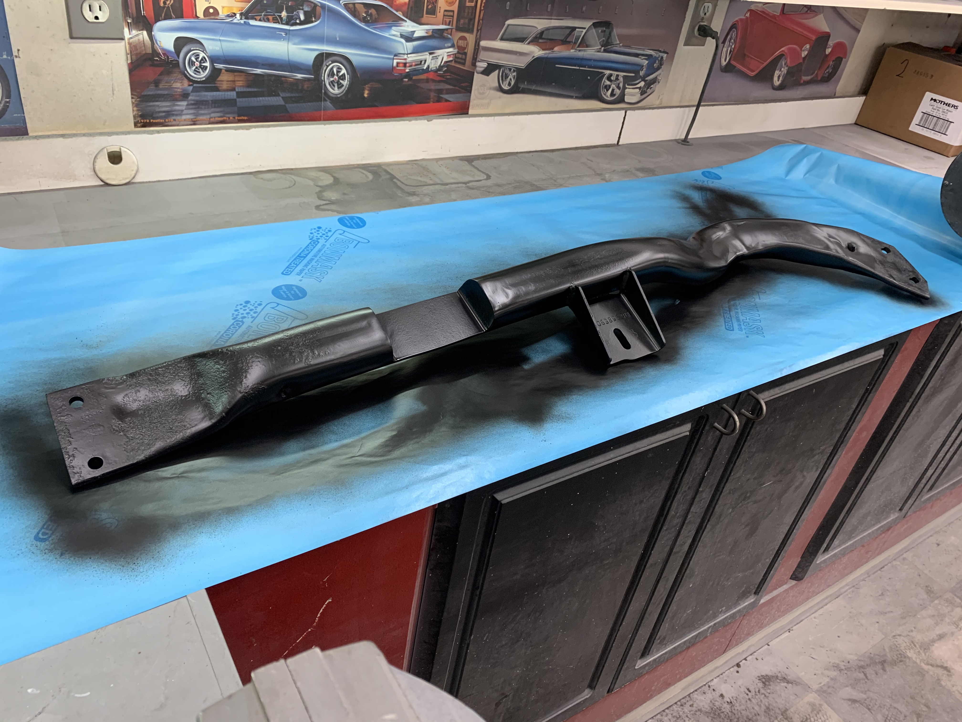

Back to the crossmember, I even had enough time left at the end of the night to get some paint on it.
Done deal:
Tomorrow we reinstall it in the car, and test if the driver’s side pipe is gonna clear.
D.

Hey that crossmember turned out great! I did something similar with mine although not nearly as clean 😉

Great work on the Crossmember. Too soon to say "I told ya so"?
What grit do you use to knock down the welds? 40? 60?
