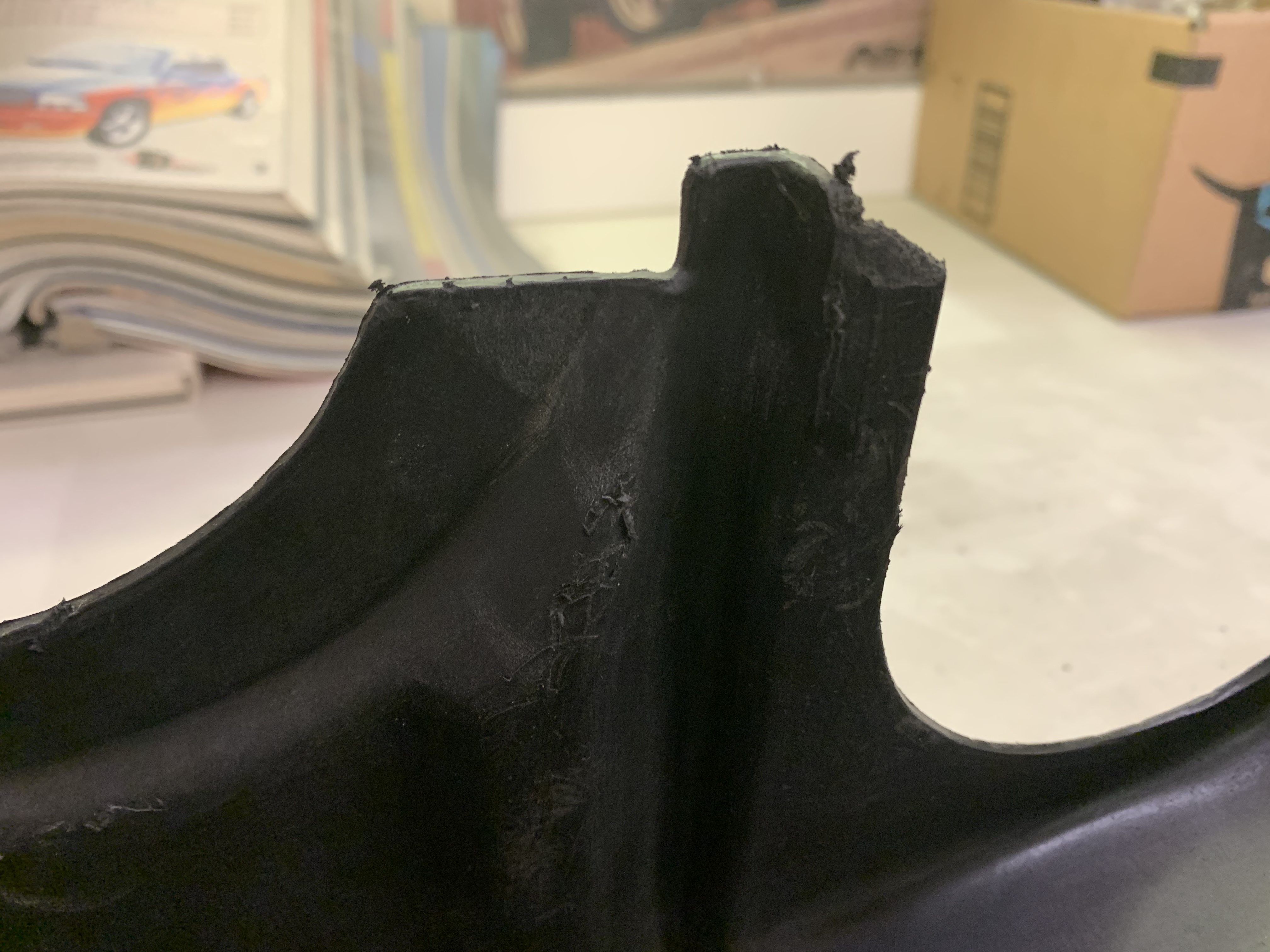

I started troubleshooting a bit more tonight after considering a few new possibilities, starting with the dipstick tube and dipstick. They both were removed to install the headers, so I thought they could possibly be hitting the crankshaft counterweights, making a sound. We tried to reinstall it in the exact same place it came out of, but anything’s possible right?
Well, after manipulating it and starting the car again, that wasn’t it.
I was just about to throw my hands up in frustration for the 137th time, when on a whim I decided to slide under the car one more time to see if this new noise was louder underneath. With the car running, I put my hand on the bottom of the oil pan, i could feel it, but it was faint. Then put my hand on the underside of the plastic inspection cover, and hey! We might be on to something here.
Yanked that plastic POS outta there, started and warmed up the car again, and BAM! No more new noise!
Turns out that the converter bolts or something else was hitting the inspection cover making a deep knocking sound.
You can see the witness marks in the plastic if you look close, and it seems to have been the worst right adjacent to the starter, between the starter and crankshaft:
This is such good news and I’m so relieved, you guys have no idea! I had nightmare visions of dollar signs flying out the window, and months of downtime. SO glad that isn’t the case anymore.
So to recap this whole ridiculous misadventure, the initial strange noise went away after we tore down and reassembled the front of the engine, only to be replaced by this second worse sound, which was the converter bolts hitting the stupid inspection cover.

Did you reef on the cover when you did the headers? Or did they maybe heat it and distort it?
I suppose that might be possible, but unlikely. There’s no signs of distortion from the heat, just the rubbing witness marks. It’s only plastic and fairly flexible, I probably just didn’t get it perfectly in place where it had enough clearance to everything. There’s a bit of slop in the mounting holes, not much, but apparently enough to allow it to come into contact with the moving parts.
The second noise is 100% on me, I didn’t think there was enough play in it to cause an issue.
