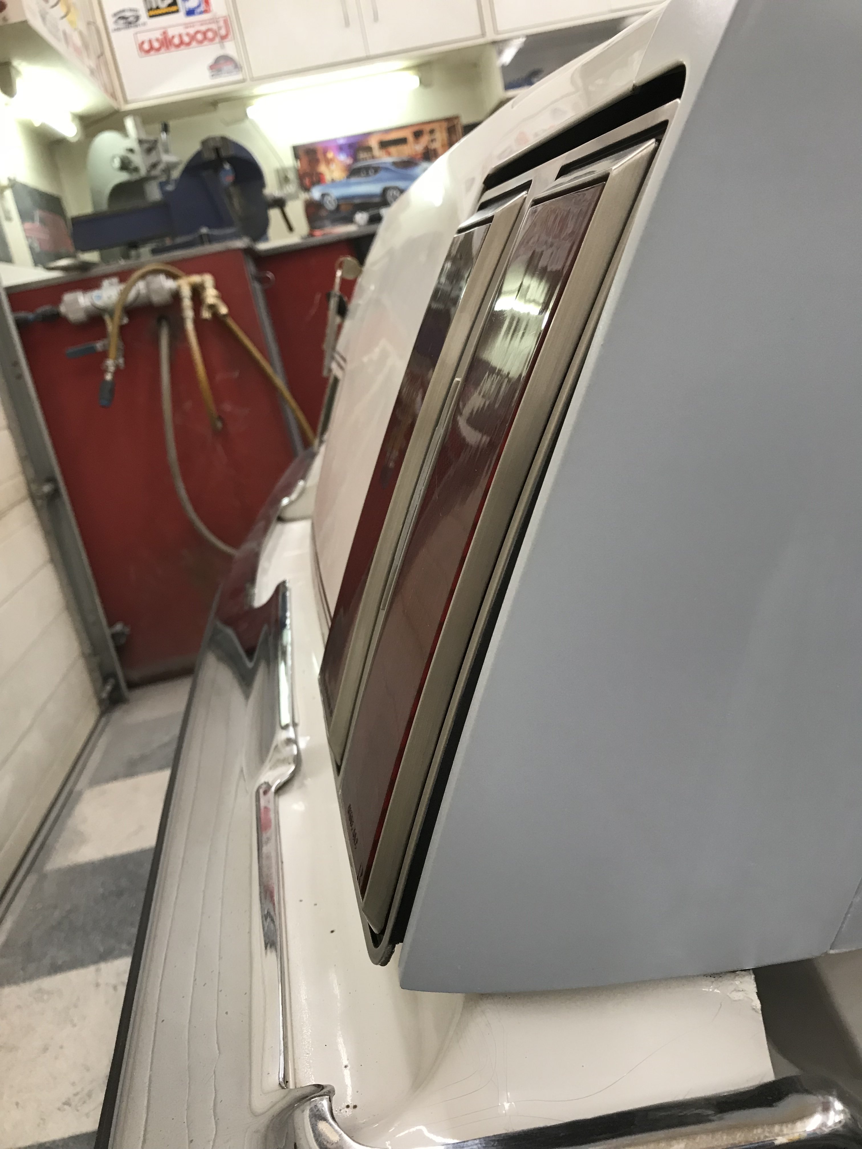

This picture illustrates what I mean. It doesn’t look all that bad in the pic, but in person it looked a lot worse.
I wasn’t happy with the way the top of the taillights appeared to sit in further at the top than the bottom. This actually has nothing to do with how the taillights are mounted, it’s actually the angle that the extensions mount to the quarters that throws off the look. Yeah, I suppose I could’ve shimmed the taillights to match as well, but again it would’ve been a half measure that didn’t address the actual issue, and then they wouldn’t have lined up with the trunk lid on the inside edges of the taillights.
Really, the only way to go about correcting the situation was to address the areas that were causing the problem in the first place.
That means going back in and correcting the angles that the extensions mount to the quarters.

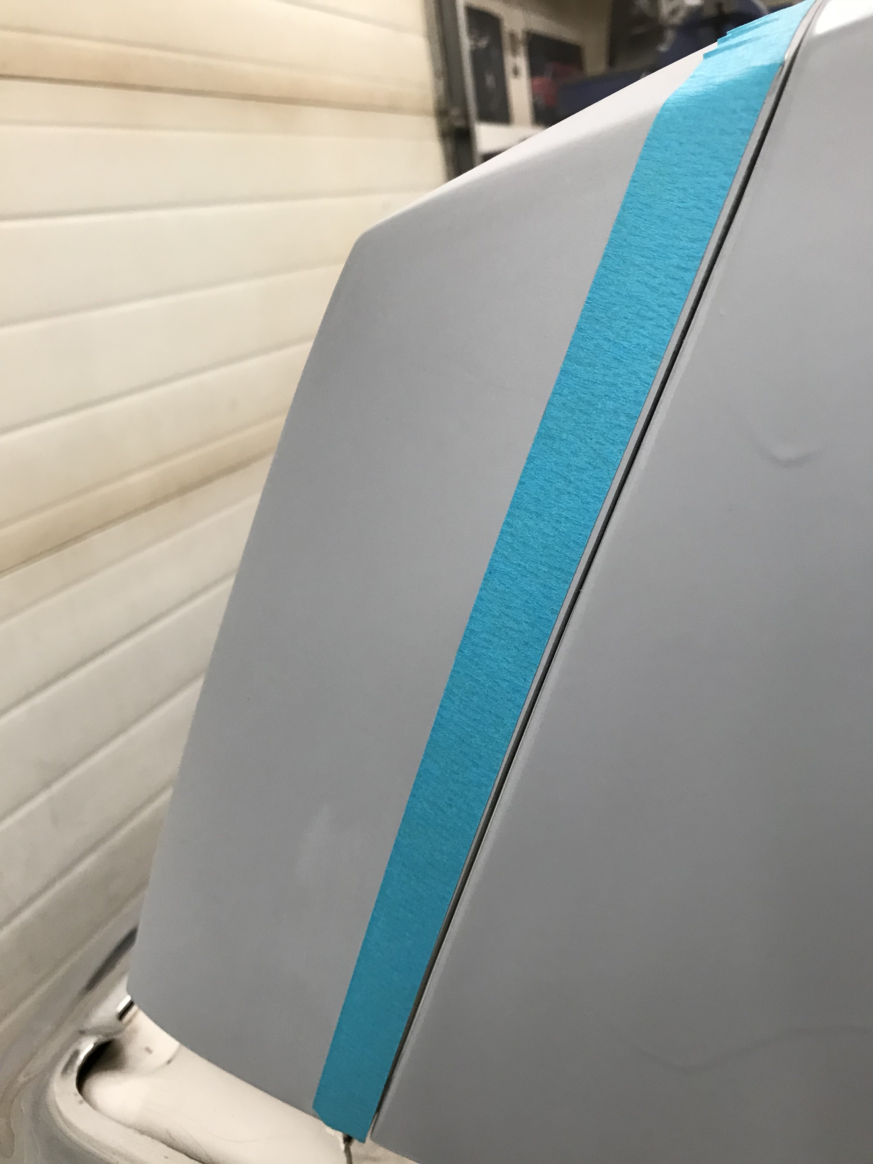

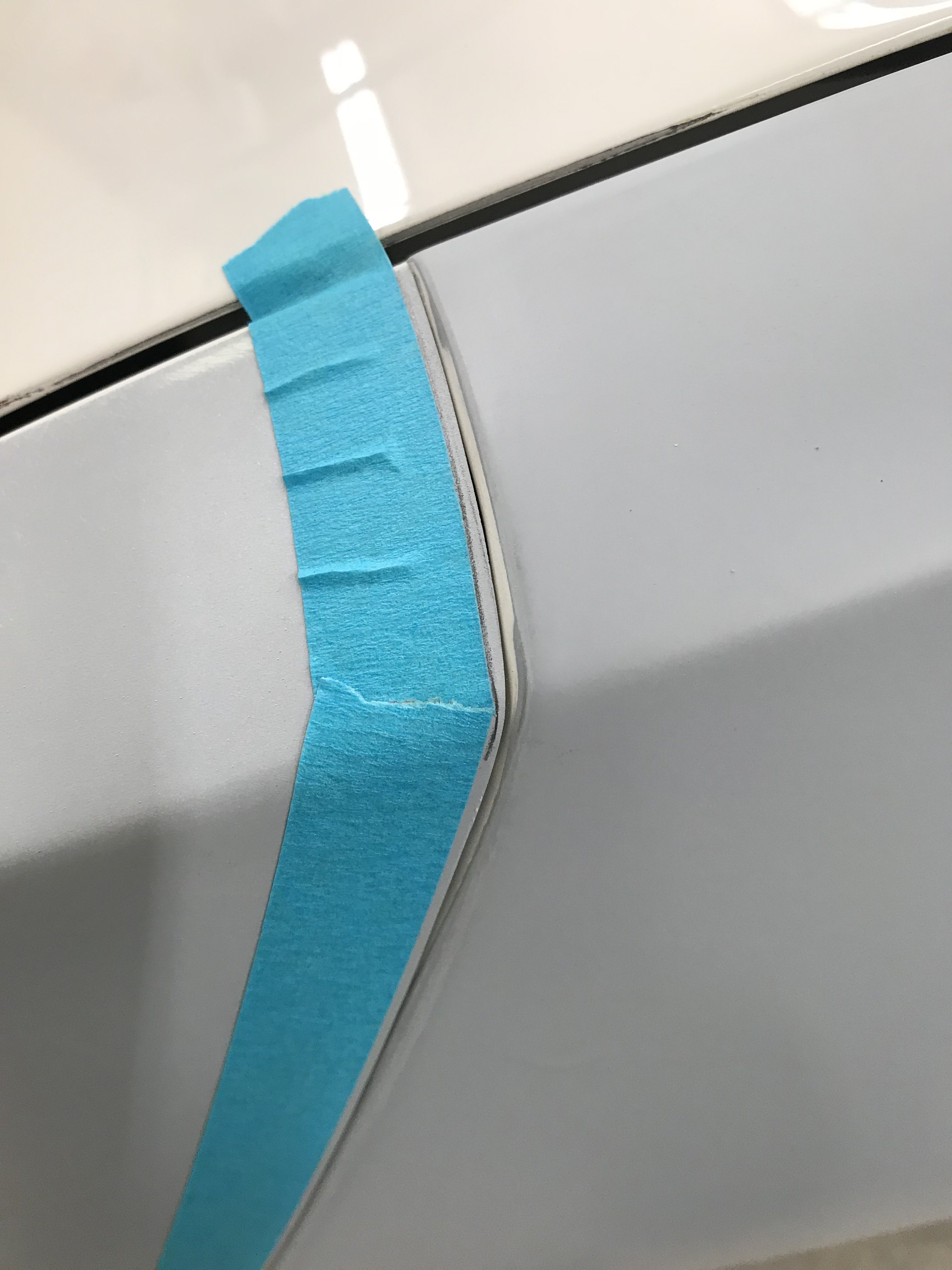

Maybe these pics will clarify what I need to do: I’ve already modified the angle quite a bit, but it still needs just a bit more removed from the top, but not the bottom. The masking tape line shows the material I still need to remove to get the angle perfect:
If I do it right, the taillight bezels won’t protrude any more than stock, it should all look the way it’s supposed to.
