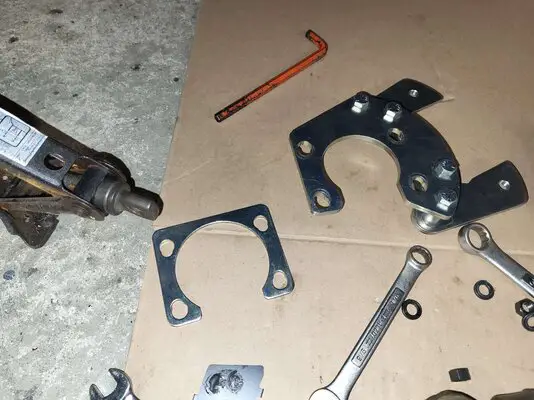

How thin are the bearing retainers?
My retainers that came with my Moser rear and disc set up was not thin but I do remember reading about some thin ones. If the bearing is protruding, the thin retainer will conform a bit to the bearing race.
No thinner than what you have. After I hung up with QP I found an FAQ sheet and sure enough it tells you to stack washers behind that plate to keep from deforming it. :doh: Of course, if I'd been the one to install it in the first place I wouldn't be chasing my tail here now would I?
