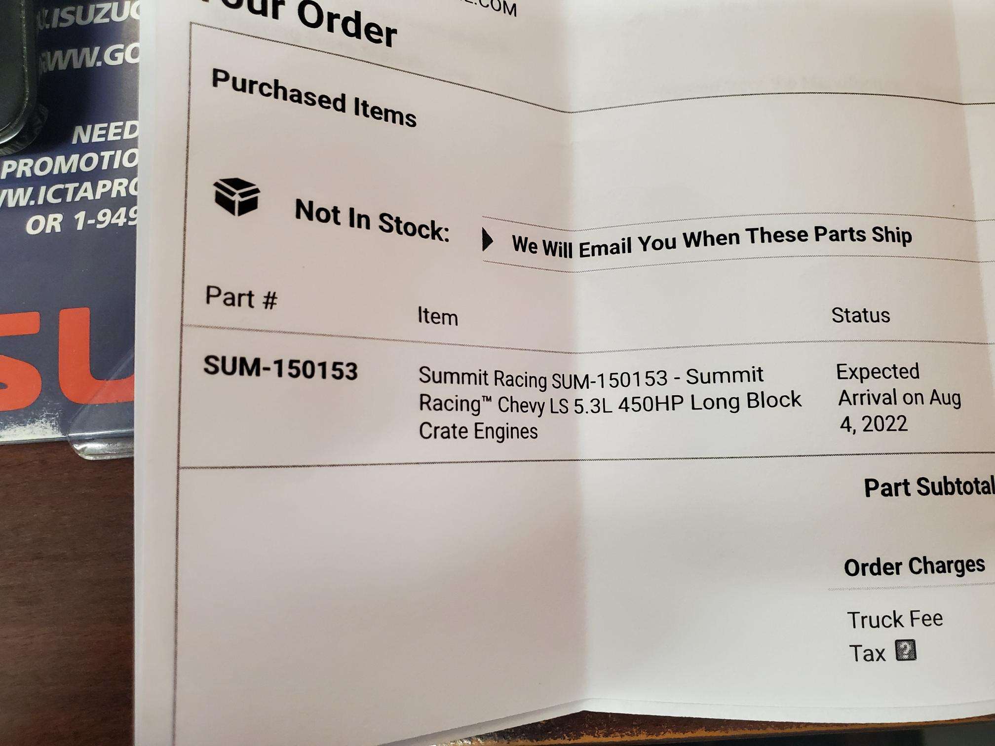

I found a long block for $750.00 and I think I'm gonna do that for now...I really want to drop the motor and trans into the car.

$750 long block? I'll take 3!
