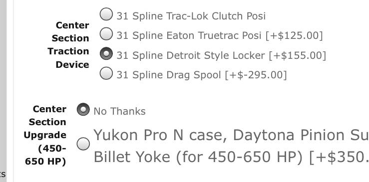

So I’m to the point I need to order my rear end for my build. Quite honestly I don’t know much about what differential would be best for a street application. I want posi for sure but can someone help out with the pros and cons of these options? Sorry in advanced.
So I am curious did you not do the upgrade to a Nodular case?
