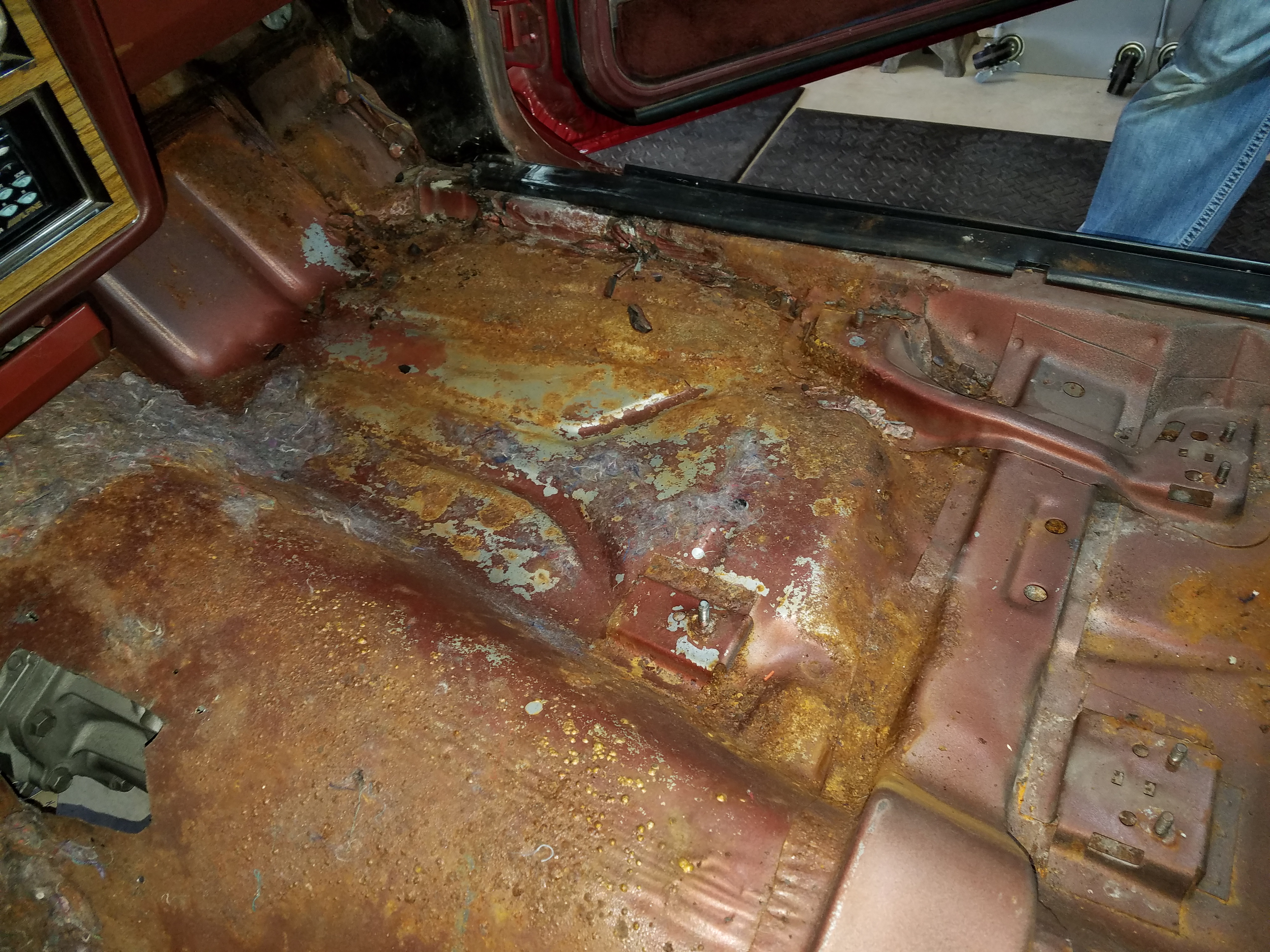

Your plan for the floors is exactly what I would do. Wire brush, paint them, and seam seal the pinholes.
Thanks for the support on my plan Joe. I know this approach isn't exactly a concours restoration but it will protect the floors from further deterioration and this project is more of a repair than a restoration.

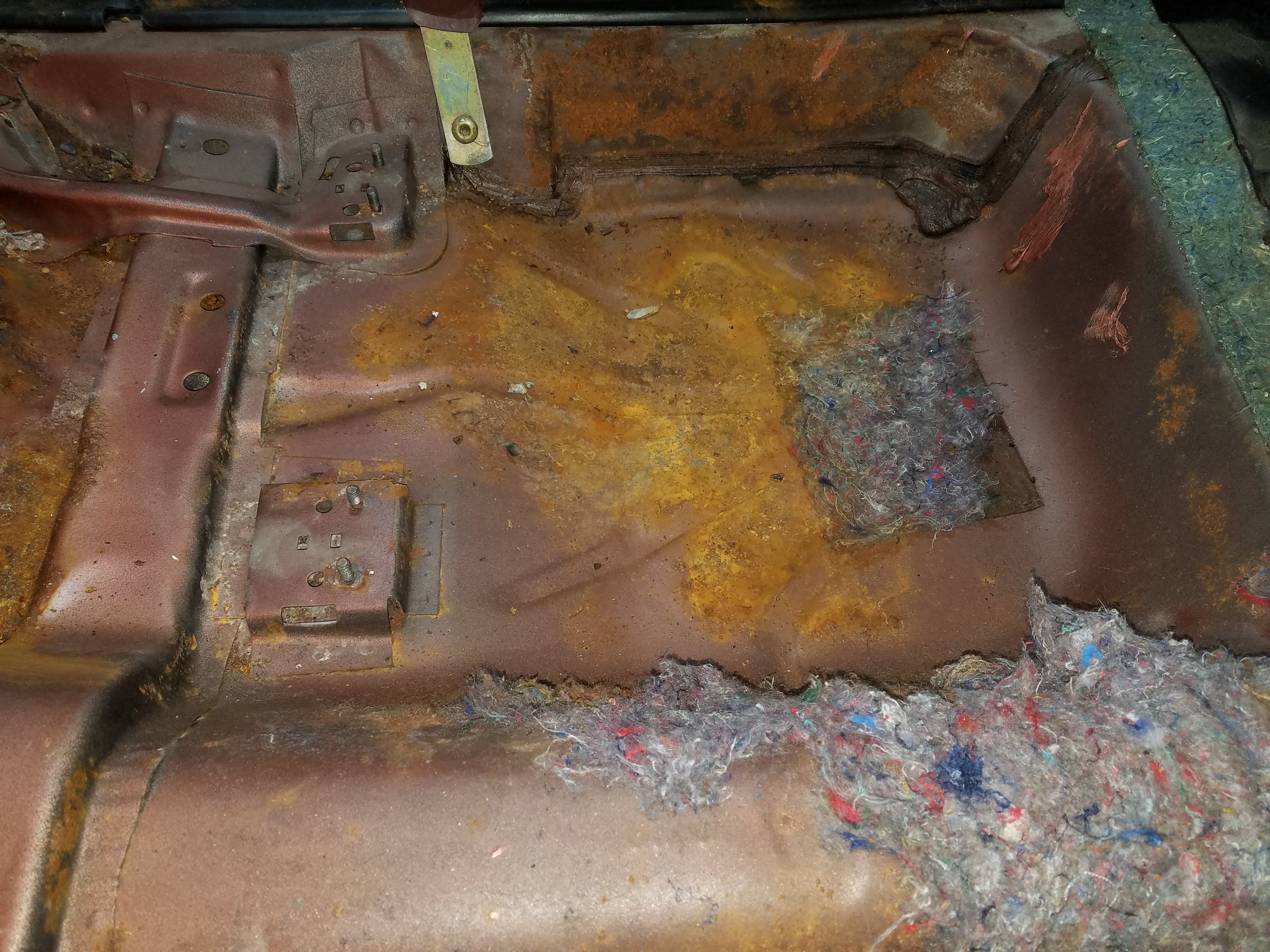

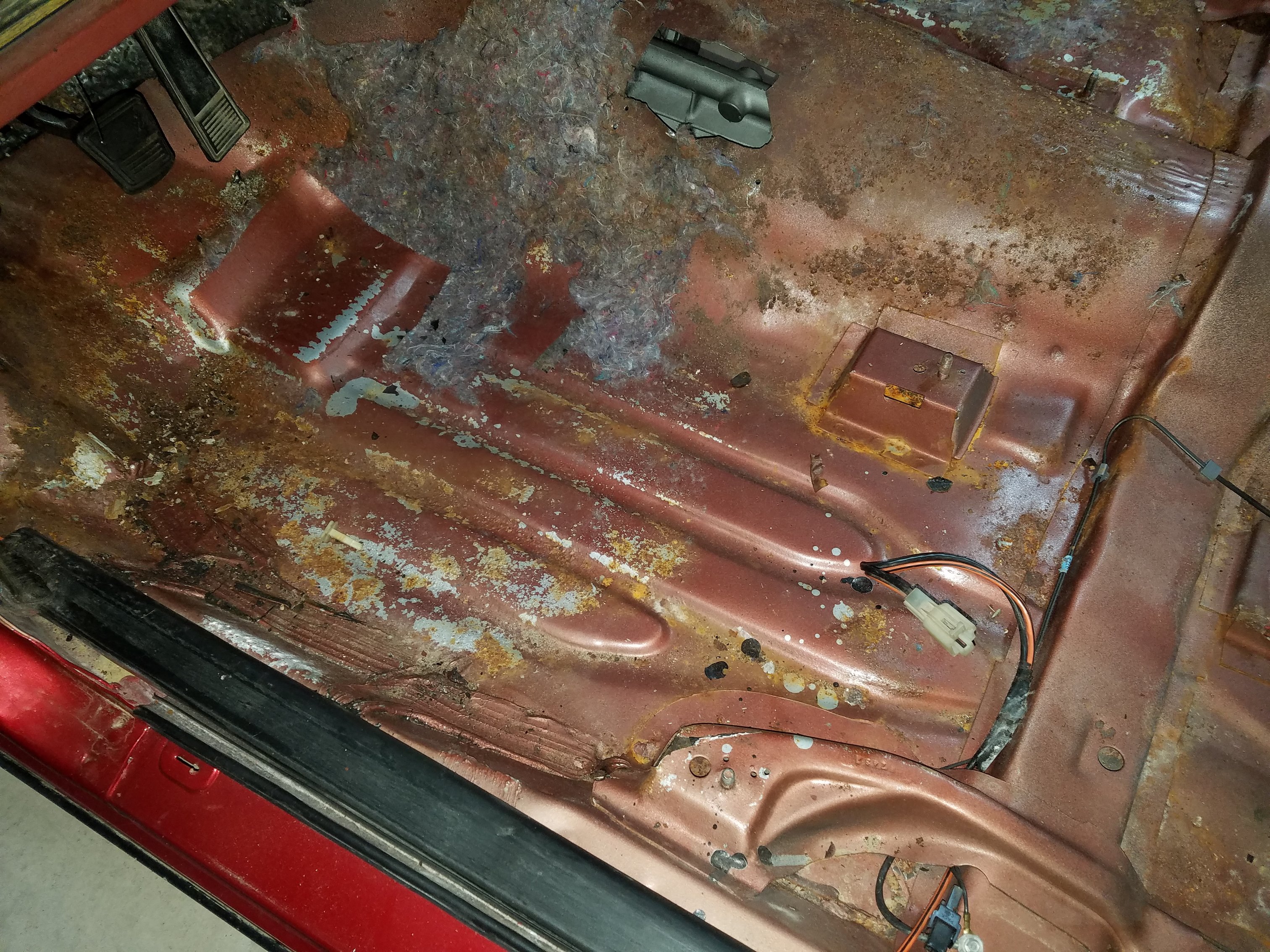

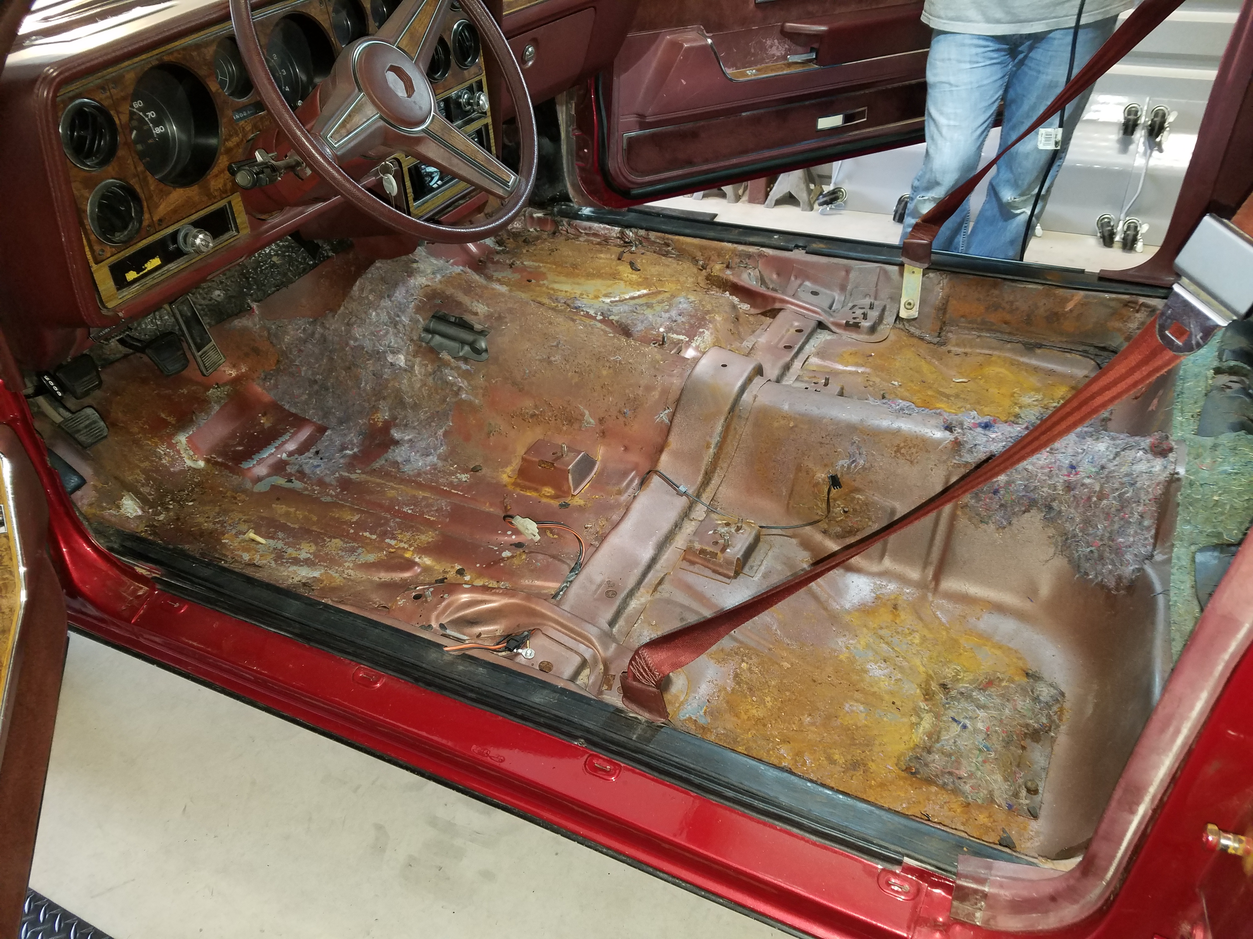

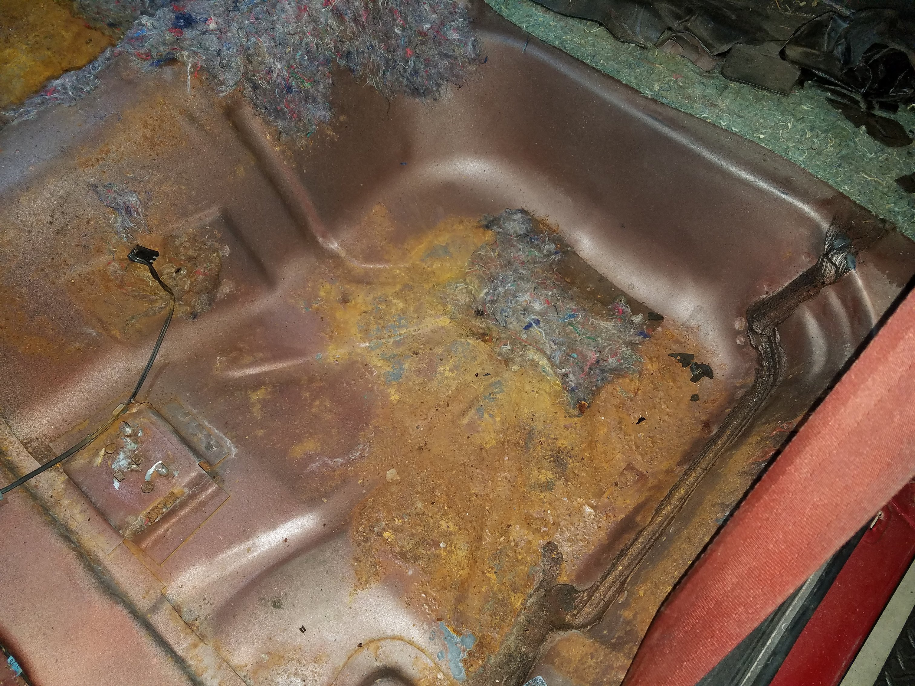

We got the carpet out and the floorboards are a little crusty. I expected this based on the musty smell that the car had. I also expected it since there was rust damage on the firewall near the wiper motor and since the drain at the bottom of the HVAC case was hopelessly plugged with dirt. Here's a look at the floor pans....
The driver's front is pretty clean...
The driver's rear has a little crust but not too bad...
The passenger rear is a little worse but isn't too bad either....
The passenger front is the worst but is still 'solid'. There are a few pinholes already. I know the guys on TV would put floorpans in the car but not me....
My strategy for the floorboards will seem familiar for you guys that have been following along. I'm going to vacuum them, scrape and wire brush, vacuum and then treat them with Rustoleaum Rusty Metal Primer followed by two coats of Satin Black enamel. The pinholes will be addressed with seam sealer.

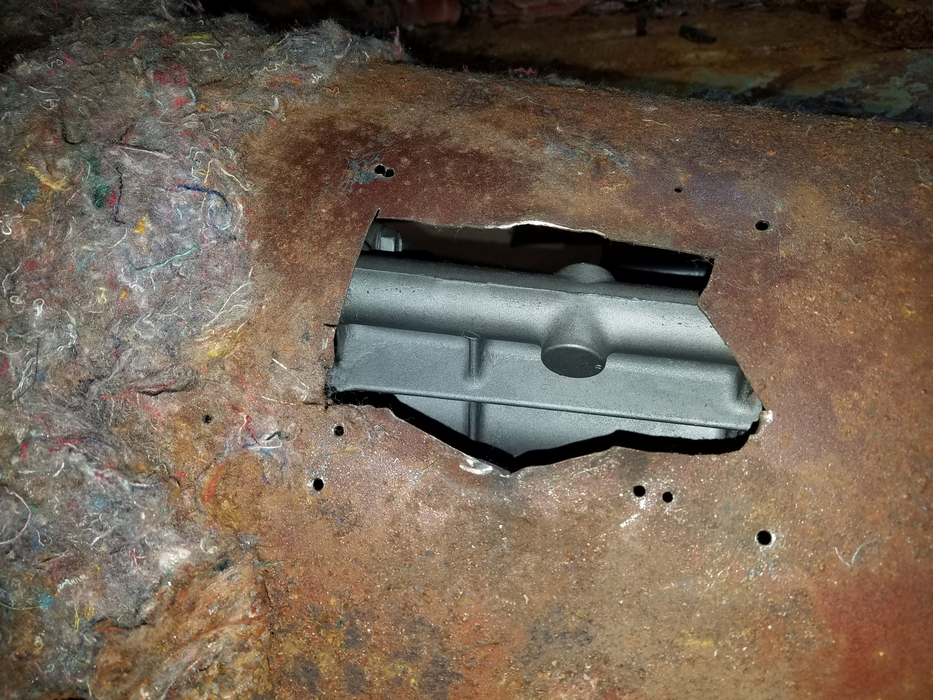

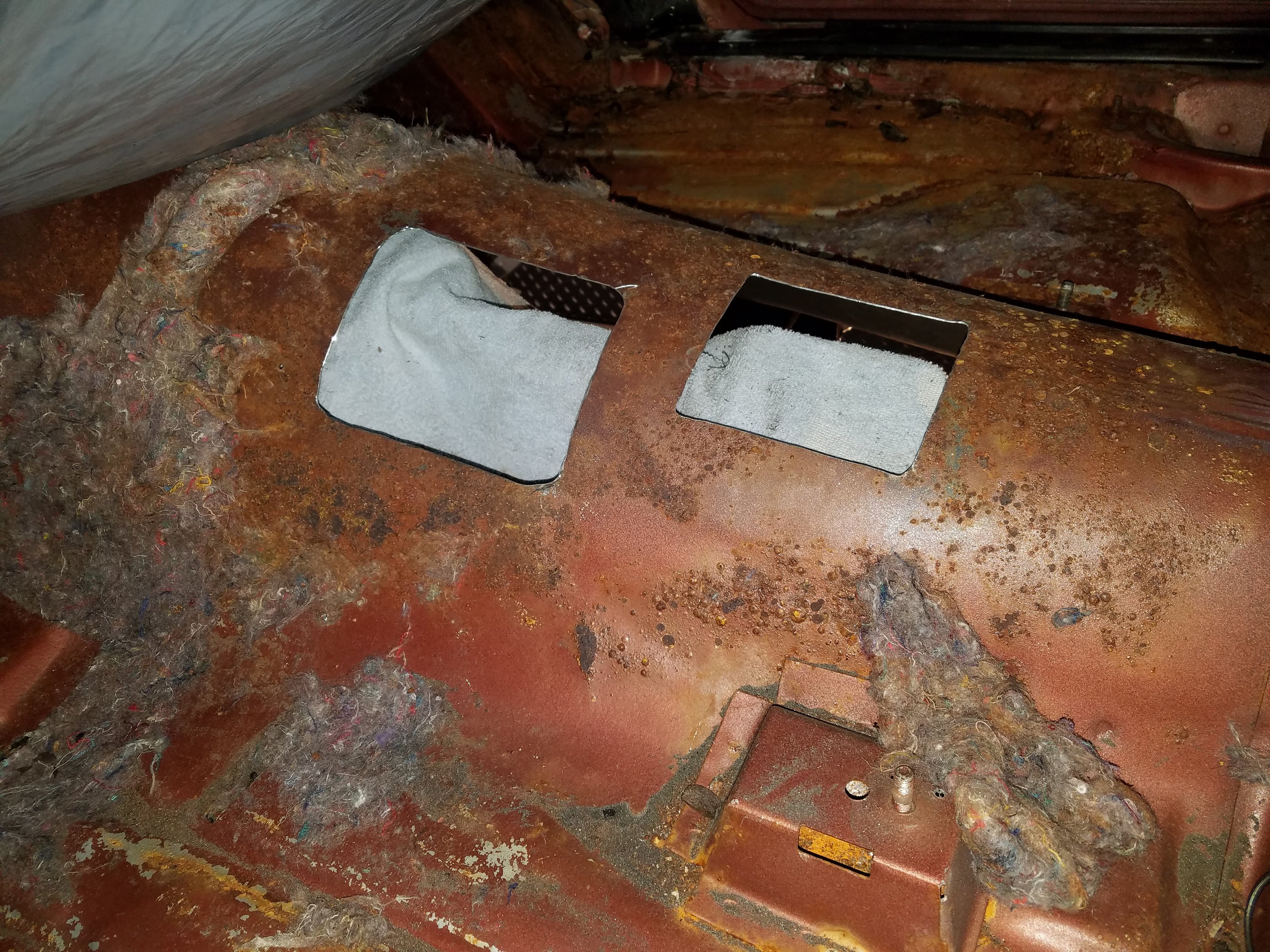

Moving forward, we worked on cleaning up the butcher job for the Saginaw shifter that the previous owner did. Keep in mind, I cleaned this up some in 2014 when I changed the shifter to a Hurst Competition Plus....
Here is a look at the floorboard after we trimmed up the previous owner's opening and cut the new hole for the T5 shifter...
The picture above will give good perspective on where the F Body T5 shifter falls relative to the stock G Body Saginaw shifter. Sean and I are going to fab up a patch this week to cover the forward hole.
