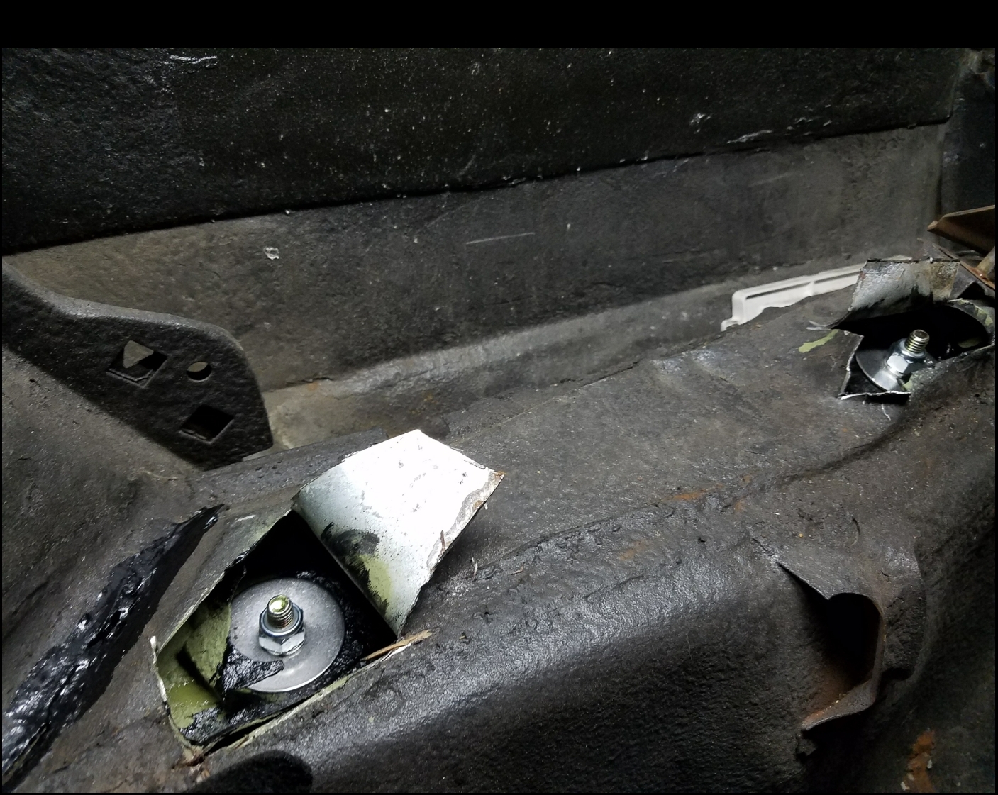

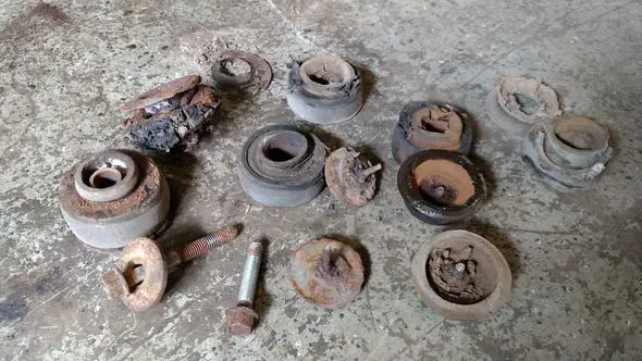

I knew I was going to have issues when I did mine. It's like pulling off a bandaid. Just get in there and take out the bolts that you can, and break the others off. Cut a c into the body above the cage nut, remove it, get the broken bolt out, reinstall, weld c back closed. Not really that big of a deal. Here's what I had to deal with. You can see how good some were, and how bad others were.
if I may add, if you do swap out your body mount bolts the imperial bolts and nuts are much cheaper. Did the 4 in the trunk and the 2 under the rad support in my car thus far. Still need to gather the time and courage to do the others

With that said, I like the idea of cutting above and welding it back. That sounds like a plan of attack. I also like this alternative to cage nuts.
The only problem with the above method (just a bolt with a regular nut) is if you ever did have to remove a body mount the nut will just spin and then you have to cut open from above again
