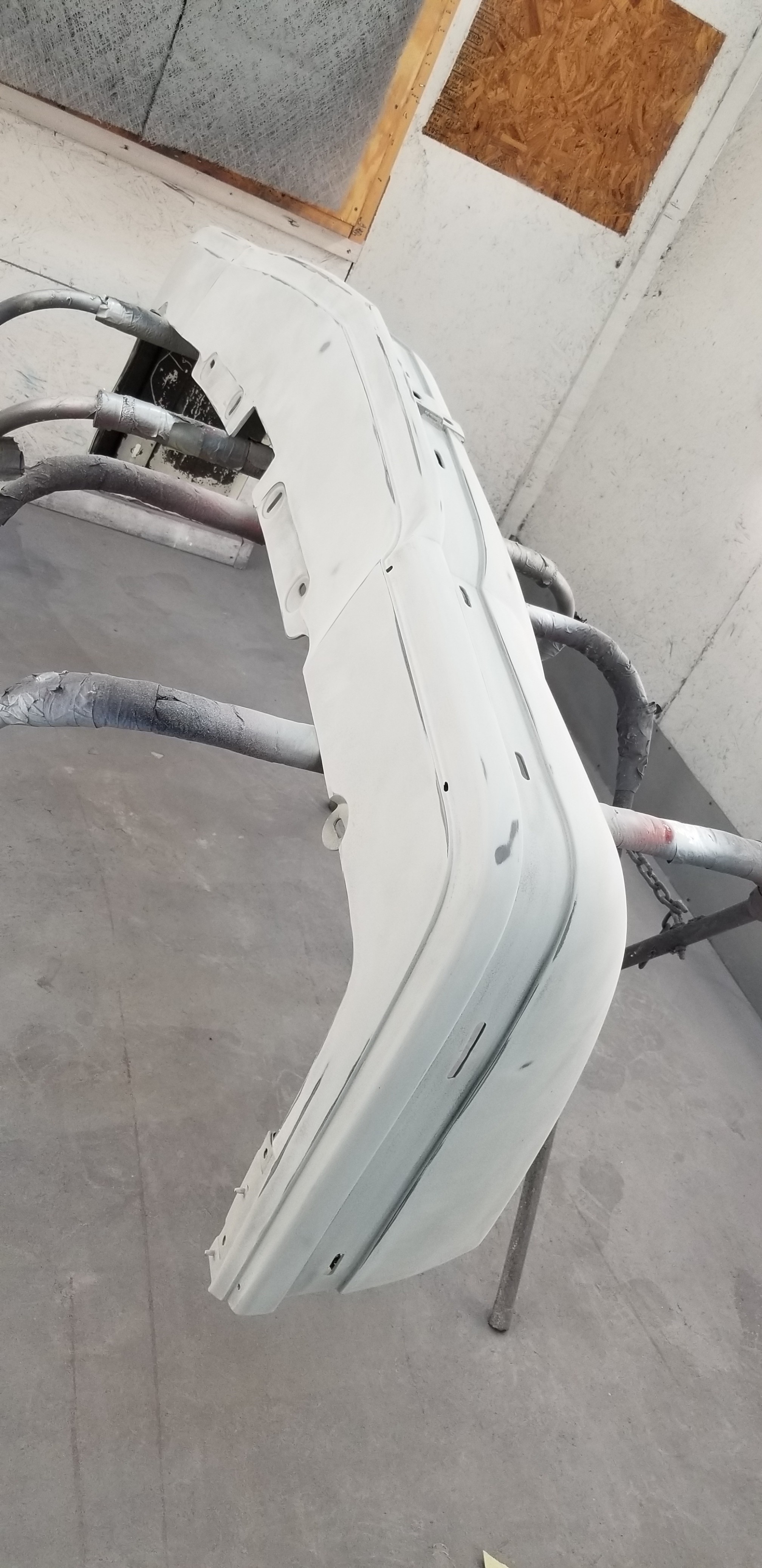

Also, I heard from the painter last night. He primed the replacement bumper cover with that SEM flexible primer that I bought. He didn't like the results so he scuff sanded it and re-primed it. Here a few pictures he sent....
This past weekend Sean and I went to a few junk yards and looked at four different Roadmasters, looking for front bumper trim. Unfortunately, we struck out. The trim I bought online showed up last night. It was a bit of a disappointment. I may use the passenger side piece though. I was pretty frustrated with the situation so I took the Driver's side trim piece from the replacement bumper cover (91-93 metal trim - not 94-96 chrome plated plastic), marked the back side of it with silver Sharpie, put the face on a microfiber on the work bench and then started to whip the s**t out of it with a ball peen hammer. These trim pieces are thin stainless steel on the outside with about a 1/4" of hard rubber on the inside that encapsulates the mounting studs. The rubber makes it difficult to move the stainless but I enjoyed some pretty good success. The area I was working on is near the turn from the front of the bumper cover, to the side. It was basically a valley where the car had been run into something, like the corner of a wall or work bench. I got most of it out with about 15 minutes of effort. I'm going to work on it more tonight and I'll take some pictures. My passenger side piece (from the replacement bumper cover) has a smaller problem in roughly the same area but unfortunately it is right behind one of the studs so I don't know how much luck I'm going to have on improving it. We'll see. That's why I may use the passenger side piece that came in the mail.
